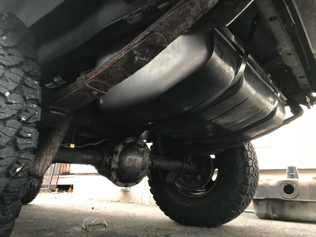

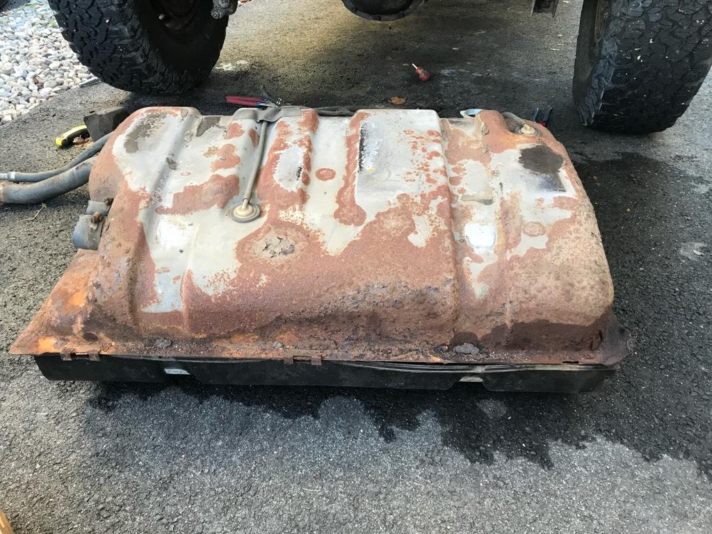

I replaced the tank in my ‘91 last year with one I got off Amazon for the same type of leak you described. If you are talking about the plastic tank protector not really fitting as well, mine didn’t. I think you can see on the picture of the new one but it’s being held in by the straps but I think it was also held by straps and clips on both front and back. If I remember correctly, now there are only clips on the front. Hasn’t been an issue.
