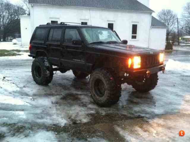

Later in the year i came across a 88 xj with a mismatched lift that came out to ALOT of lift, control arms with a flex joint in the center and a new sye for $400. I bought it, an parted it out and kept the lift for mine and ended up making about $100 after it was all said and done. The I found a set of 36" swampers for free (1 is bald but hey, this is a budget build!) ended up with this top-heavy setup
I didn't like it, so I wend searching the junkyard for a set of thunderbird springs when I found a black xj with red shocks that caught my eye.. It had a 3.5" lift! Rear axle and springs were gone but the fronts were there so I snatched em up for $30! I pulled 2 leafs out of the rear springs (entire springs are going to be replace soon) and ended up with this

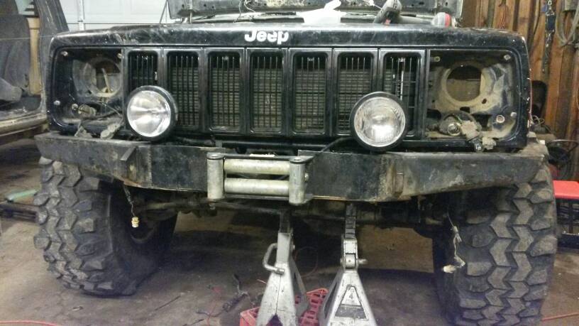

So I picked up a Taurus fan at the boneyard today, it's the single speed off of the 97+ 3.0 cars.
To fit this in place of the clutch fan without removing the pulley that ran the clutch fan I had to re-drill the mounting holes for the radiator and move it forward 1"
It fits right in the stock fan shroud, but since mine and apparently every cherokee in the local junkyard is broken, the bottom is bolted in and the top is ghetto-fabbed in with zip ties.
I have to wire it up tomorrow, and put the grille back in,

Got a couple more 36s with about 75% tread for $80 so i have a matching set of swampers again (had 2 baja claws on it bc my welded rear end eats tires), mounted up a couple new lights, wired up a new efan to replace the stock one, wired it thru the stock relay on a toggle switch.

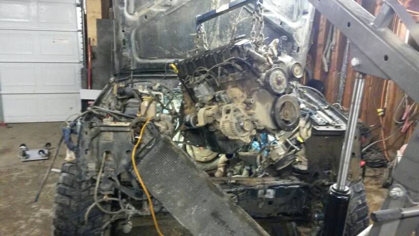

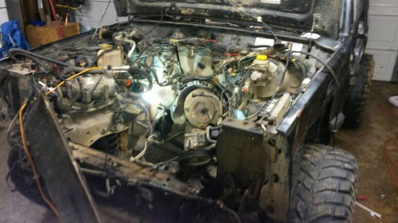

Replacement motor was sketchy from the start (free from swap i was paid to do on a yj bc it made noises lol), front axle pinion bearing started to die, busted a spider gear in the rear at some point (it was welded) and it got all sloopy, and i was generally bored with it so i started tearing it down for a makeover.
Removed the entire drivetrain, i bought a 97 xj rustbucket for 300 with low-ish miles that runs like a top and had a screwed up tranny for the engine and some misc other parts.
