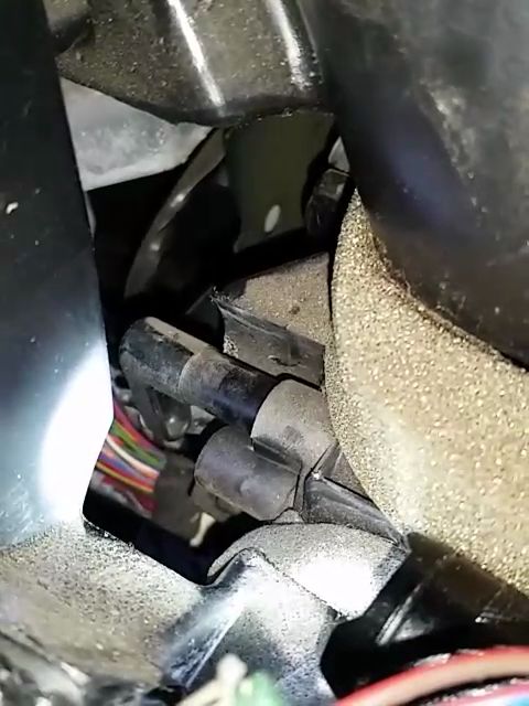

As soon as I started pulling the dash apart I found this: (Nipple partially broken on the back of the HVAC controls) No, I didn't break it when I was removing it. It's been broken for a while. I'm assuming it was broken when the dash had been pulled apart in the past.
I did a quick repair on it with some hot glue to get my by until my replacment arrives.
Eliminating that leak fixed 90% of the issue but the Mityvac still shows a slow leak in the system inside the cab somewhere. I'll be further diagnosing the issue once my replacement HVAC controls get here.
