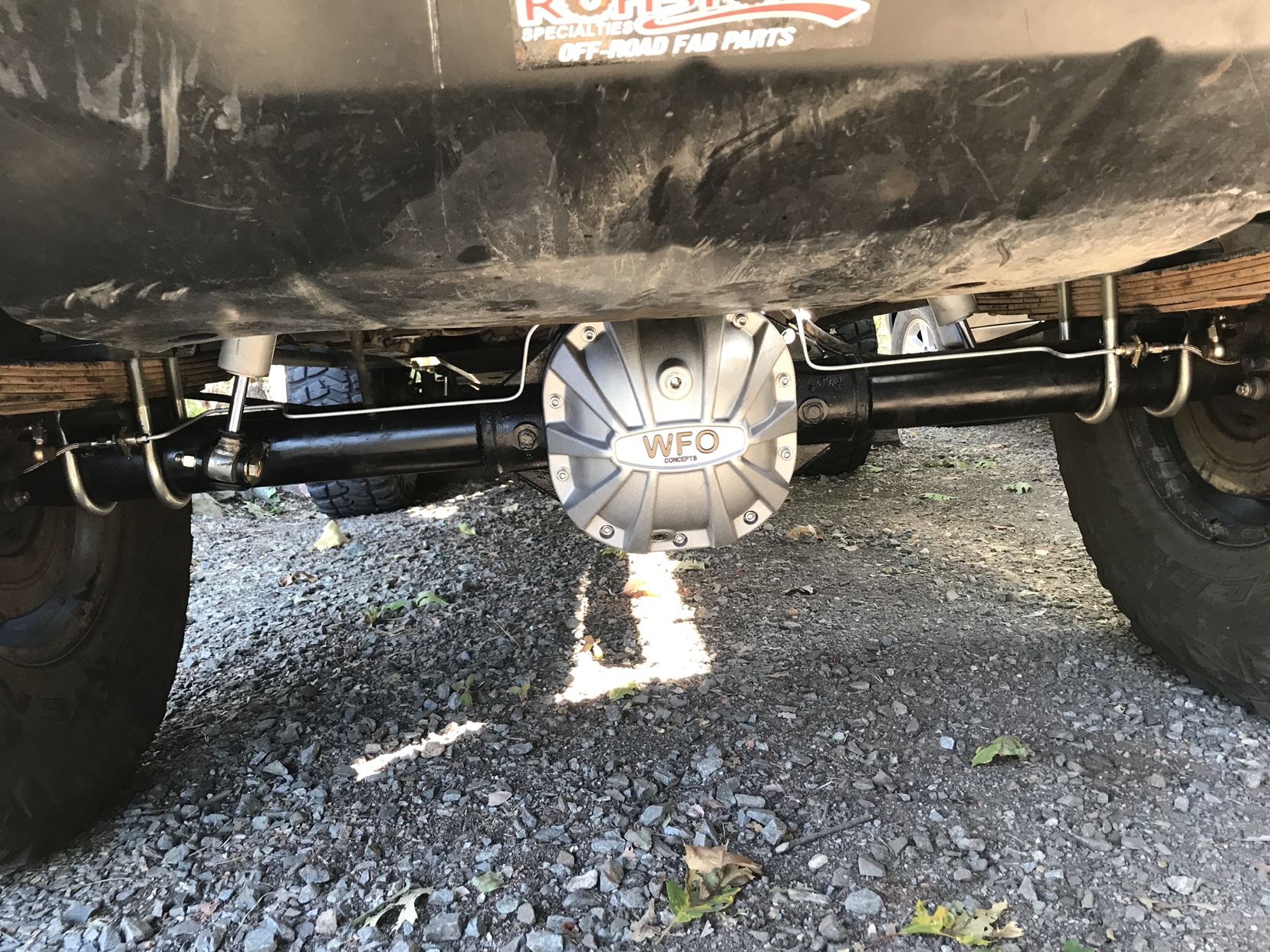

I replaced my older 8.25 with a ford 8.8 with disc breaks. It has a beefy 31 spline axles which should be plenty strong enough for the 35’s
I plan to run in the future.

I did see the plug in the back of the differential and I will use that as a fill hole. So when it runs out of that hole in the back the differential is full.
Looks good. I would bump stop it so that you do not destroy those rear shocks since you have around 2.5-3" up travel in the rear
