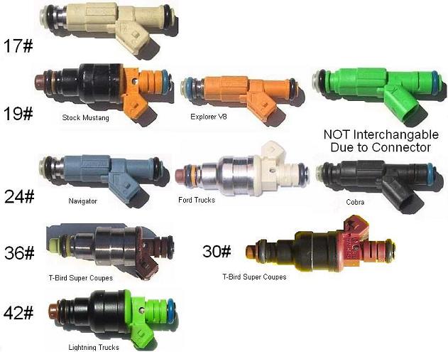

.. Can some of you take pictures of your fuel injectors? I don't understand how I can have two sets that absolutely refuse to work, and everyone else in the world has them and they work.
Found this...
Mine are blue, but IIRC they look most like the 24# ones labeled 'Ford Trucks'.
FWIW... a picture will only tell you half the story.
For example: You can have an EV1/high impedence injector which looks exactly like a EV1/low resistance injector. If you don't know what the injector is, the only way to tell is with a multi-meter.
It's entirely possible to blow your ECU by throwing in the wrong set of injectors, so be careful!
