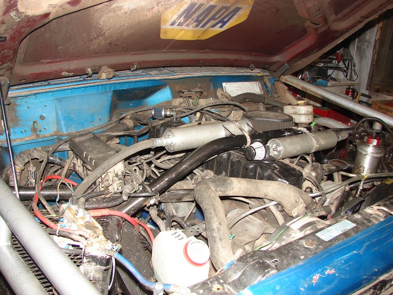

Sorry I'm a bit late to the discussion... Mine works great for what I do- lots of articulation and some mild jumping (probably no more than 2' air). The engine cage and custom bumper are tied together with 3-point shock hoops. The hoops connect to the unibody on pieces of plating that were welded on. I wouldn't have done it without the bumper tie-in though, and I do plan to go through the firewall and tie into a full cage some day. More pics here.
isn't placing the remote res of the shocks in the engine bay going to kind of defeat the purpose? I mean, it gets pretty toasty in there.
