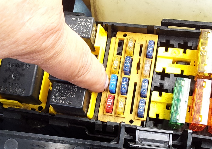

This may sound simple but since they are all related to the o2 Heaters, have you gone through your fuses? You want the 15A his finger is on.
checked fuses, vaccum lines, also visually inspected the electrical system.
my friend, who helps me out, is a 20 year mechanic. we've put in alot of time on this xj. He's kinda stumped as i am. the o2 sensors i thought would get it. then i checked all the fuses and the vaccum line.
i also replaced the TPS sensor and i do regular maintenance on the air intake as its a newer design and i seem to have slight issues with it
Nothing you installed would have affected the o2 sensors, except the new sensors. So if you know the fuse is good and you have done several swaps for new sensors, you have to have something in the wiring. A short from a chaffed wire or something of that nature. It is just a matter of finding it. I know you have mentioned putting a lot of time into it and I'm not sure what all that entails, but that's really all that is left to do. Assuming there are not running problems at this point?
