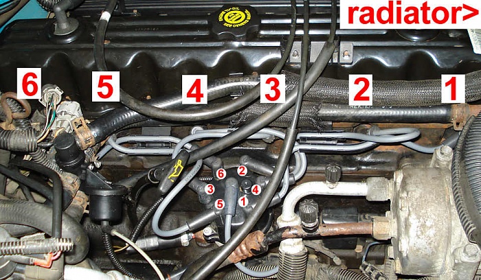

Wires in the correct spot on the distributor? Just checking since some of the diagrams out there (looking at you Haynes) are wrong.

Check the inside of the distributor cap for carbon tracking,
specifically near the 5-3 terminals. Replace the cap if
tracking is suspected...

I'm thinking the same thing, he is getting crossfire, spark jumping to the wrong wire. He might want to ohm test his cables. Really high resistance cables can cause all sorts of grief.
