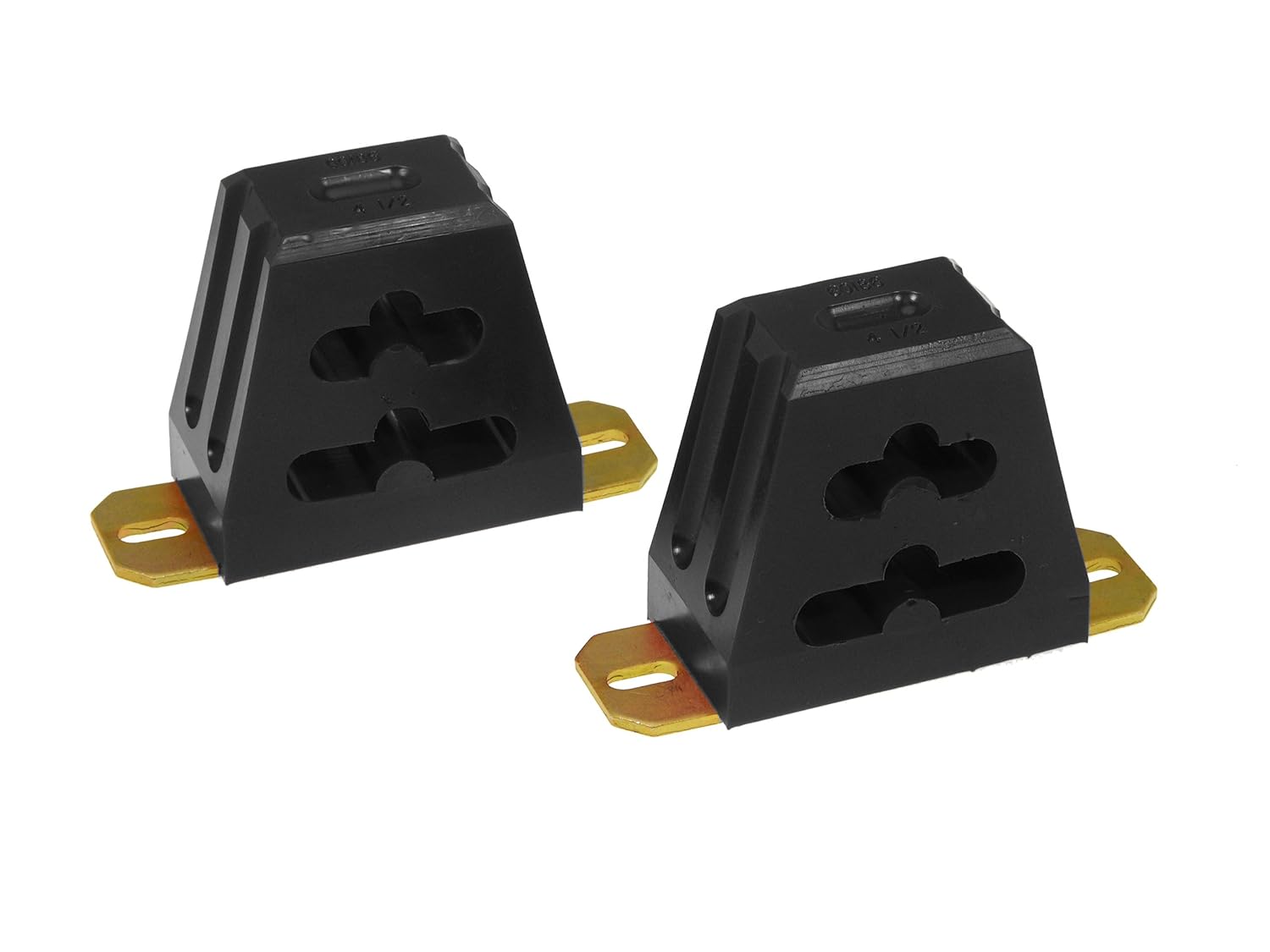

add some plate to the inside of the u bolt plate and mount one of these to it
