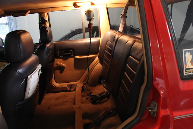

1997 ZJ Seats in 1997 XJ

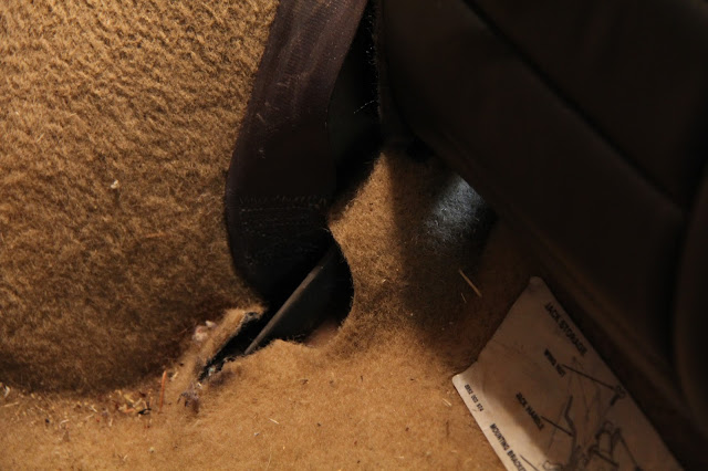

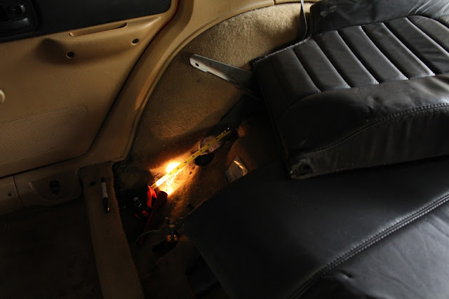

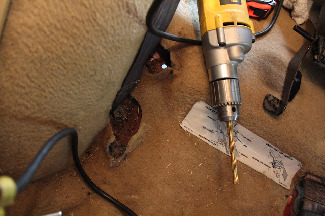

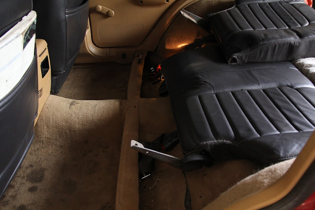

The rear lower seat brackets required slots cut into the bulkhead on the uni-body. The seat cushion brackets have guide arms which rotate through these slots to ensure the hinges engage properly. Measuring for all of this was the most time consuming part of this conversion.

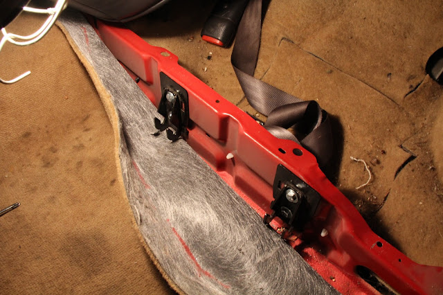

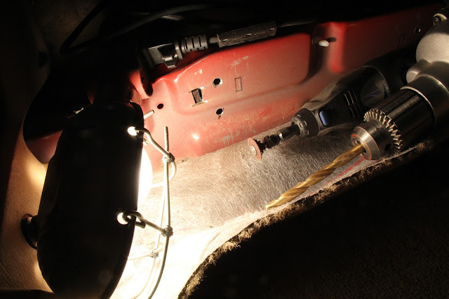

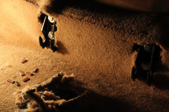

The upper seat brackets were easier. I just had to drill 6 holes and install the 3 brackets: 2 side, 1 center. Didn't have to cut the carpet much, just slid them under where the old brackets were.

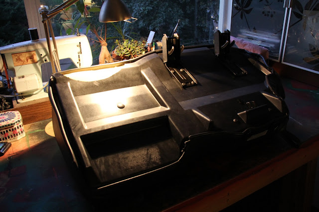

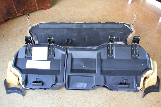

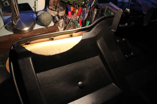

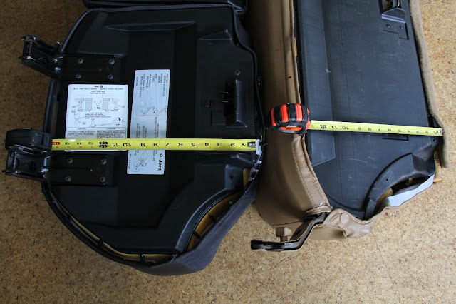

The seat cushions were too wide and too deep. I cut away some plastic with a dremel and trimmed the foam with a hacksaw. I also relocated the hinge brackets back a few inches. The brackets wouldn't engage and hinge into place straight without a semi-circle cut away from the plastic seat bottom to clear the transmission tunnel.
