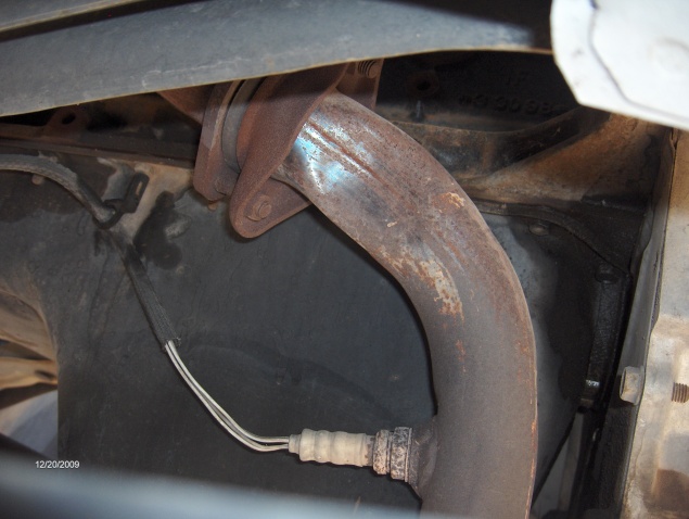

Yeah, it still has the stock exhaust system. The previous owner installed a new factory-replacement muffler not too long ago. Unfortunately, it has the famous "dent" on the down pipe under the header flange. Looks identical to this:
I'm going to take my truck to the exhaust shop to install the high flow cat and the dynomax super turbo catback I bought. I'm also going to get the dent removed. My stock down pipe seems to go from smaller than 2 1/4 like in the photo above to 2 1/2 halfway on the down pipe.
