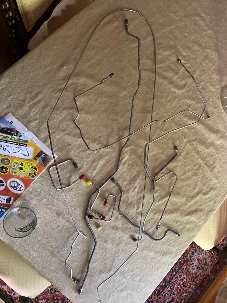

Well my lines got delivered. Iíve been spraying my flare nut connections every so often when I remember for weeks. I bought flarenut wrenches. The very first one I tried to turn rounded right off...
All these lines come with brand new nuts. How bad can I **** something up if I get in there with vice grips? Do I need to keep my cool?
Iím going to go back out and try to find a better set of flare wrenches that arenít from Harbor Freight. Any advice or good video links greatly appreciated.

Vice grip those suckers right off, anything you are going to screw up will be replaced on the new lines. A neat trick is also to cut the old line off flush and use a 6 point socket. Heat also does wonders.

Heat from propane torch first, then vice grips.

Well I got the two lines that connect to the flexible lines. The long one shape got completely mangled getting it out. Do I need any special tool to bend the new long tube? Am I screwed if I donít bend it back pretty close to shape?

If it's any kind of a sharp bend then yes you should use a bender, you can "massage" soft shapes pretty easily.

Ok so I am chugging along. I could still use some help.
I got all the old lines and nuts off without much incident and tested the bleeders which were good.
I am having a really hard time connecting the new longer rear line on the drum side. The threads look ok to me. Everything came off easily, not sure why.
The other thing is I am driving myself insane trying to fit the new master cylinder to passenger front line back in. Has anyone used the Inline Tube set? The line is in two parts with a connector in the middle. The whole thing seems too long. Iím pretty sure I have the half connected to the master cylinder in correctly but the other half seems too long or like I need to bend it a different way.

Yes, my last set was from Inline Tube. I think in MI. There is another set that is from OH. I did not have any issue with the Inline. On the other set, I had to add some bends on the drivers side. On the rear, I left the wheel cylinders a bit loose. Sometimes its hard to get the right angle to get the threads started. Sort of had that problem on the master cylinder lines.
