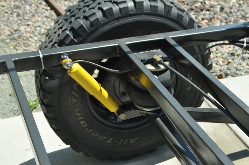

Finally got some time to work on the trailer again. I added the shocks, built the flippable tongue, the offroad hitch, and wired the temporary lights so I can get it inspected, titled, and get some license plates.
The tongue can be removed and flipped upside down so it can be pulled by a regular height vehicle.
I finished the offroad hitch as well.

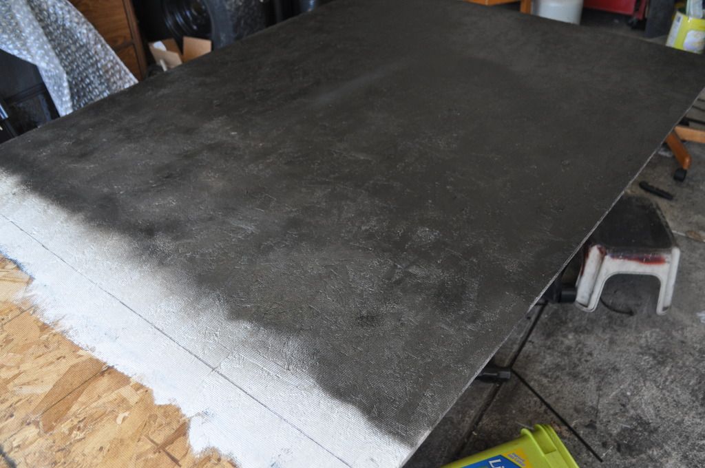

I cut the OSB for the floor and have started on sealing the bottom. I first coated it with ZinZer, followed by a coat of enamel, followed by rubberized undercoating.
I also fab'd the brackets and mounted the shocks.

I took it out on the street for the first time and it pulls sweet. They were working on the road and there was about a 4 in drop. I went over it at about 45 and the trailer landed firm with no rebound or bounce. Now on to finishing the steel frame now that I have figured out where the counter top, drawers, sink, and stove top go.
Can't wait to get it finished.
