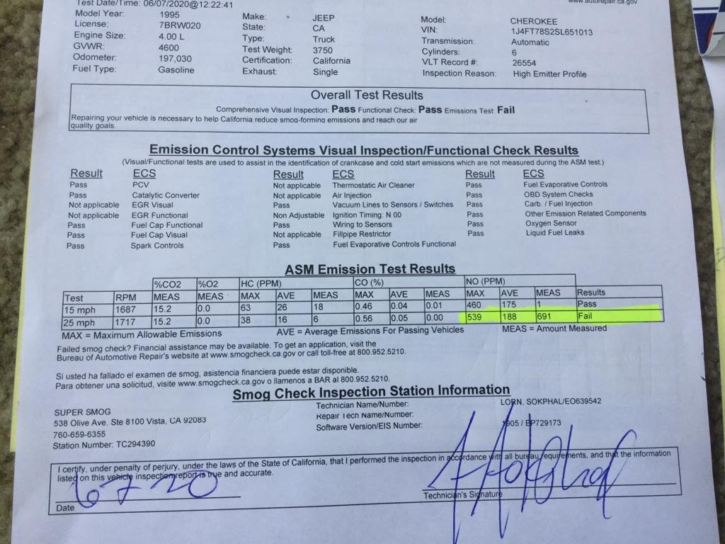

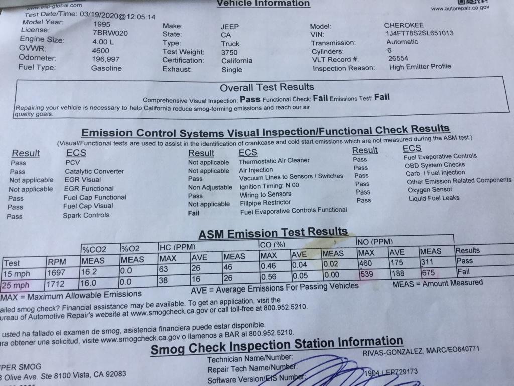

Cheap xj buy turned nightmare. 1995 4.0 auto bone stock. New plugs, wires, cap, rotor, belt, refreshed grounds and now cooling system.
Failed smog first time due to hi NO at 25mph. After the first test I changed every part of the cooling system due to it creeping up in temp while on the test and driving home. It now runs at 195-200 degrees and the cooling system is perfect again. I also changed the catalytic converter(walker ca legal) and o2 sensor to ngk brand. It idles and runs perfectly(except in the eyes of CARB). New smog test today and every number dropped except NO at 25mph and that actually went up from the first test. Before the test I ran it for about 45 minutes to warm it up. What’s going on? First and second test results.

note the article indicates a high temp as a cause of NOx. lean running can cause this, but your O2 value of zero indicates you are not lean. however that zero O2 value is after the cat, and a good new cat can clean up a lot of sins in the motor. say one cylinder is lean do to intake leak, and the O2 sender senses the lean burn and compensates by enriching all cylinders, You do have high end of limit HC so that might indicate that, given a new cat. so this might be sign of lean on one or more cylinder and rich on the rest. for this do an intake leak test use a smoke machine or spray aerosol flammable carb cleaner tests for intake leaks, easy and quick to do. lets make sure we dont have an intake leak, that is low hanging fruit, check it.
you may also be running hot on all of them still, check you coolant temp with an independent known good gage.
you may also have the carbon build up in cylinder, which raises the compression ratio and causes more heat, specially if using low octane fuel. for this a de carbon process can be done, or retest with a tank full,of high test fuel if you are currently running low grade. high test fuel will lower temps if the cause is high compression, but the real fix is de carbonization.
for me on my 1990 I got with a brand new cat...
15 mph CO2 15.5% O2 11.5%, HC 2 ppm, CO 0.02 %, NOx 0 ppm
25 mph CO2 15.3%, O2 9.5%, HC 4 ppm, CO 0.05%, NOx 0 ppm
of course they can also sniff the exhaust before the cat if there is a port for that, then you can find out what the motor is really producing.
anyway, intake leak test is easy nd cheap, get that done, if no leaks, then consider decarbonization, perhaps. a lot of carbon build up can also cause high compresion readings, but that can be masked by worn rings.

I got 0 for o2 on both tests. First test was with original o2 sensor and cat. If the machine was working right then swapping o2 and cat didn’t absorb any extra o2 that didn’t exist in the first test. And i can’t work on the car for about a week, but I’ll check the intake and try to de carbon the engine if there is any carbon.
