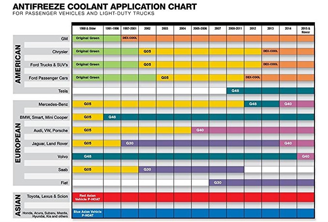

Here's a totally not confusing color chart and even this info is generalized
[img
https://www.aa1car.com/library/coolant_application_chart_2015.jpg[/img]
Interesting chart.
Most interesting to me because it shows GM starting to use DeathCool in '97, yet that is what my '96 Impala SS came with. I got rid of that stuff right off the bat. It had a bad reputation already. I ran the green stuff for a few years (with frequent changes) then switched over to HP Gold Quantum Blue. That has worked well for us.
