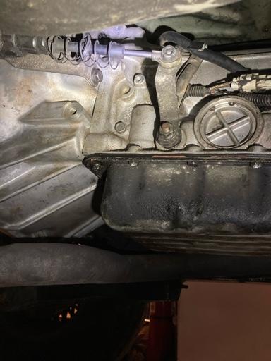

Yeah I doubt this is a 98+ trans, but it takes 30 seconds to verify. Look for a speed sensor on the driver side right behind the bellhousing, IIRC it is nestled in behind the shifter cable bracket sorta. No sensor? Trans is correct for your year.

Finally had 10 minutes to look at it. Fluid level triple checked. Itís full. Pulled the transmission fuse and it shifts fine manually. So that narrows it down to something electrical. I believe someone mentioned testing solenoids by testing ohms? Is that correct? And what am testing exactly? Since the jeep ran perfect with 2wd, Iím assuming the tcm is good. So itís either the wrong wiring like some said or something else electrical. Help please.
No sensors or connectors forward by the cable linkage.
