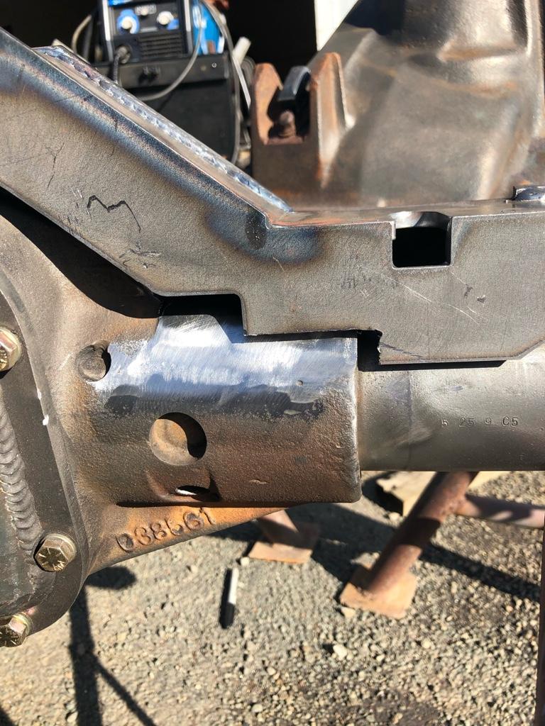

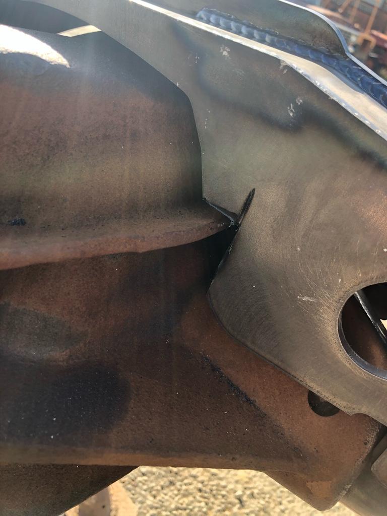

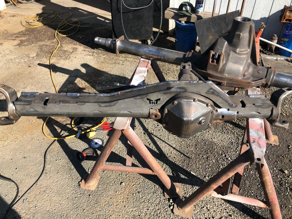

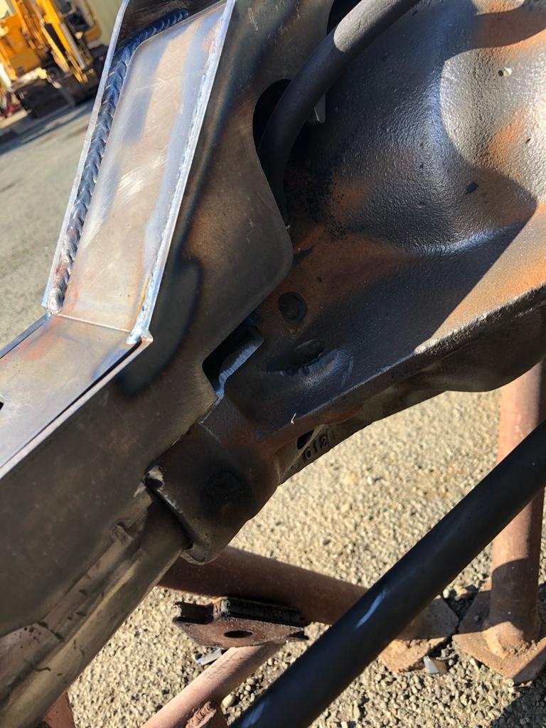

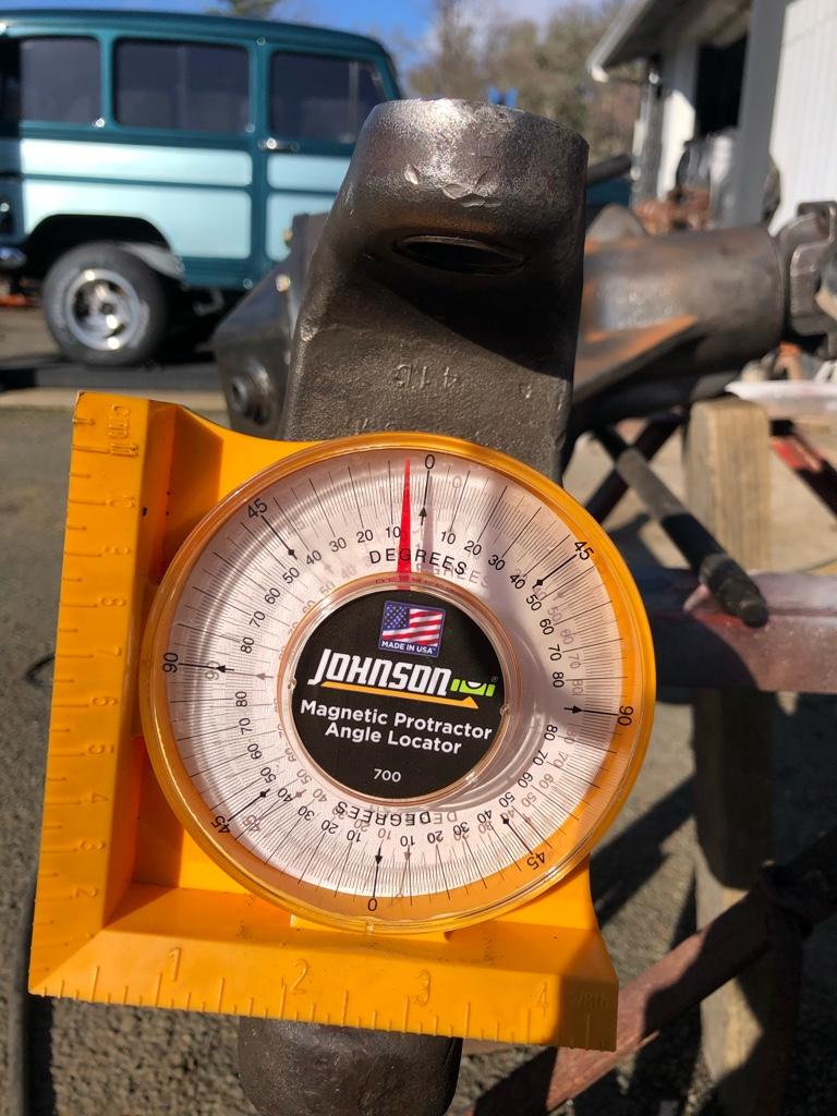

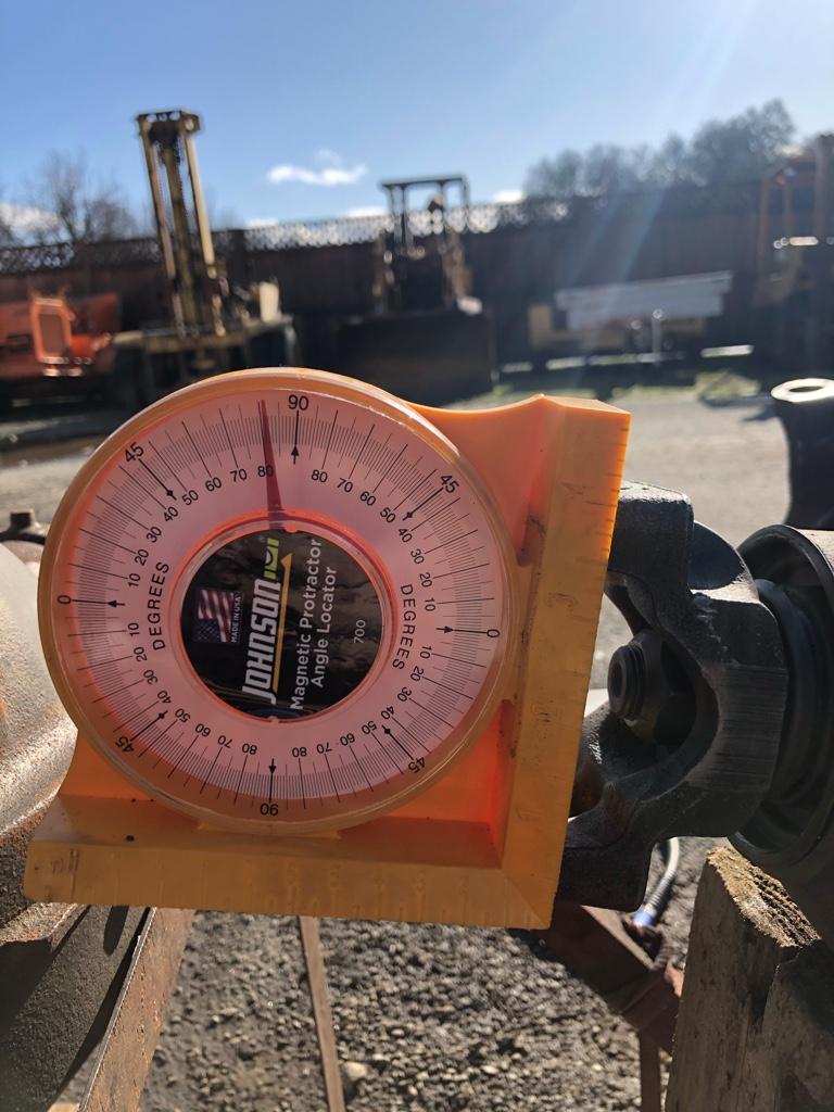

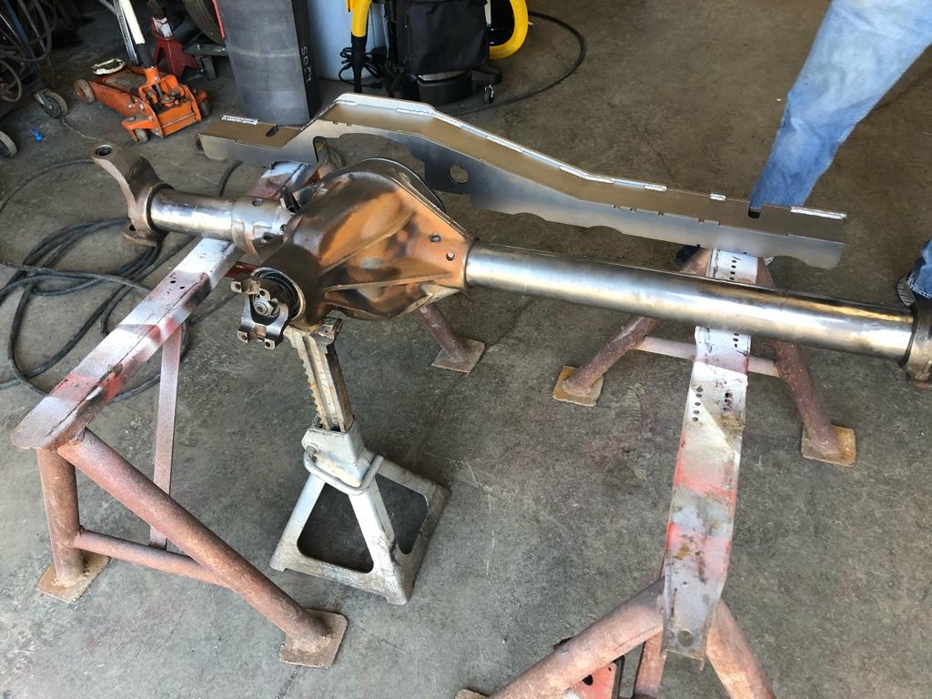

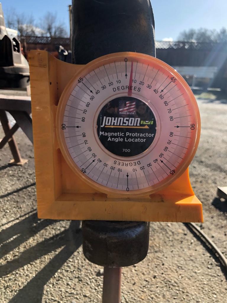

Got the truss fitted to my axle today but couldn’t weld it on as my inner C’s aren’t welded on yet. Got the angles where I think they should be. The angle of my front drive shaft is 10-11 degrees and I have the pinion angle set to 10 degrees. Each C is set to 5-6 deg positive castor right now. My friend is going to weld them on with stainless or nickel rod and an arc welder. Hope to finish gearing the rear axle and weld the truss on next weekend.
