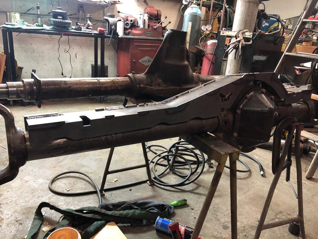

D44 cut turn: I am half way through the process and I’ll post the pics that I have so far. Basically I used a cut off wheel and was really careful to cut only the weld on the inner C. When I was sure I had cut all the way through I took an 8 lb hammer and a map torch and hammered them off. Quite a tight fit from the factory.

Dude don’t sand too much, they are supposed to be a tight fit. Like heat the knuckle up in the oven or grill and put it on the tube at night.
If you are not narrowing, you don’t have to take them off. Just cut the weld and turn on the tube.

I had to heat them to put them back on, so I think they’re tight enough. I took them off to clean up to the old weld. Thanks for input 👌

My assumption is the C's for so tight alignment isn't an issue? Just make sure the are fully seated (is there a stop?) then check rotation and weld on?

When you put the C’s back on, you need to make sure that you they go back on the same depth as before. They don’t have any built in taper that would set the depth correctly as far as I know.

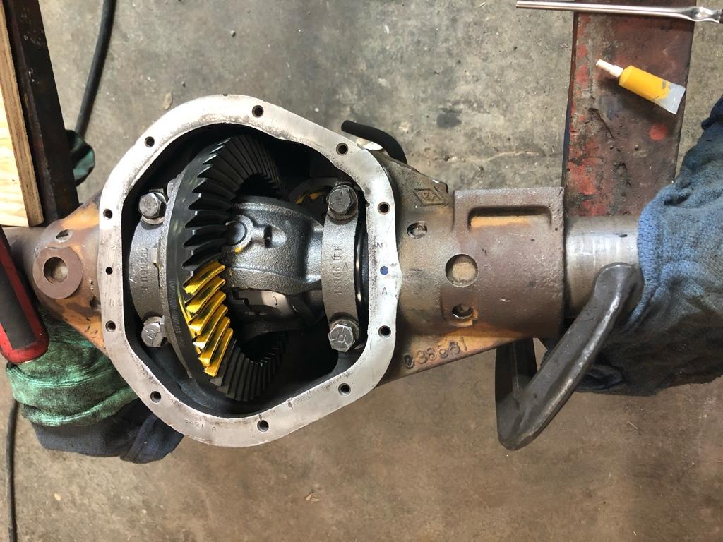

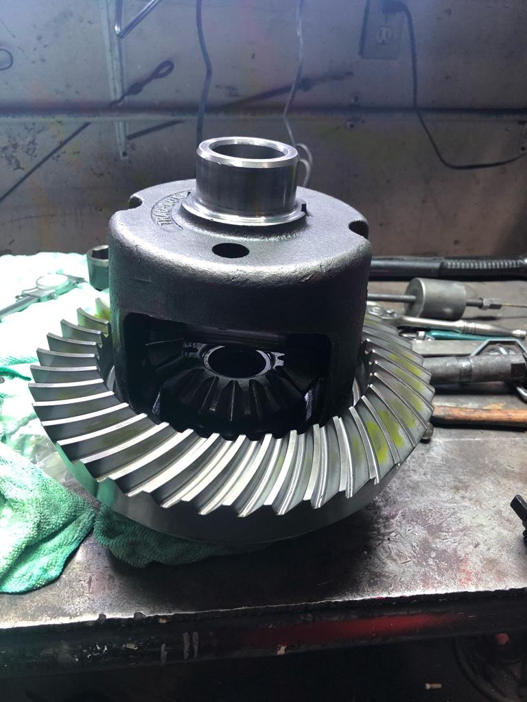

Got the front gears done today. Got the rear part way done. Test fit the front truss before I start grinding.
