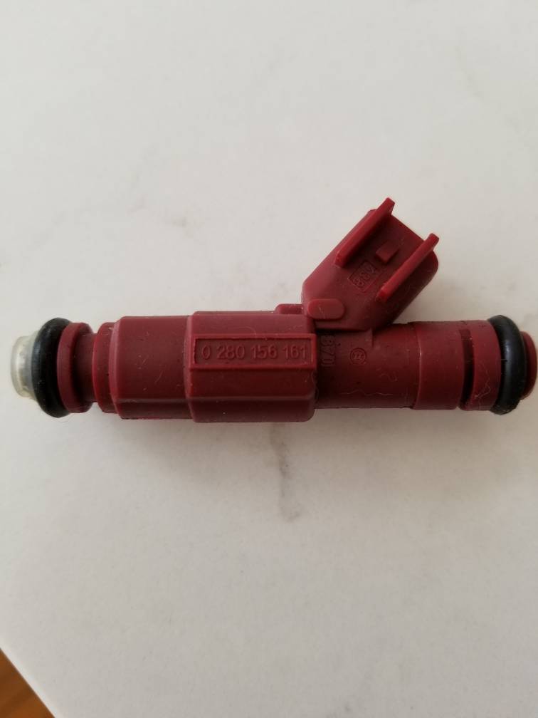

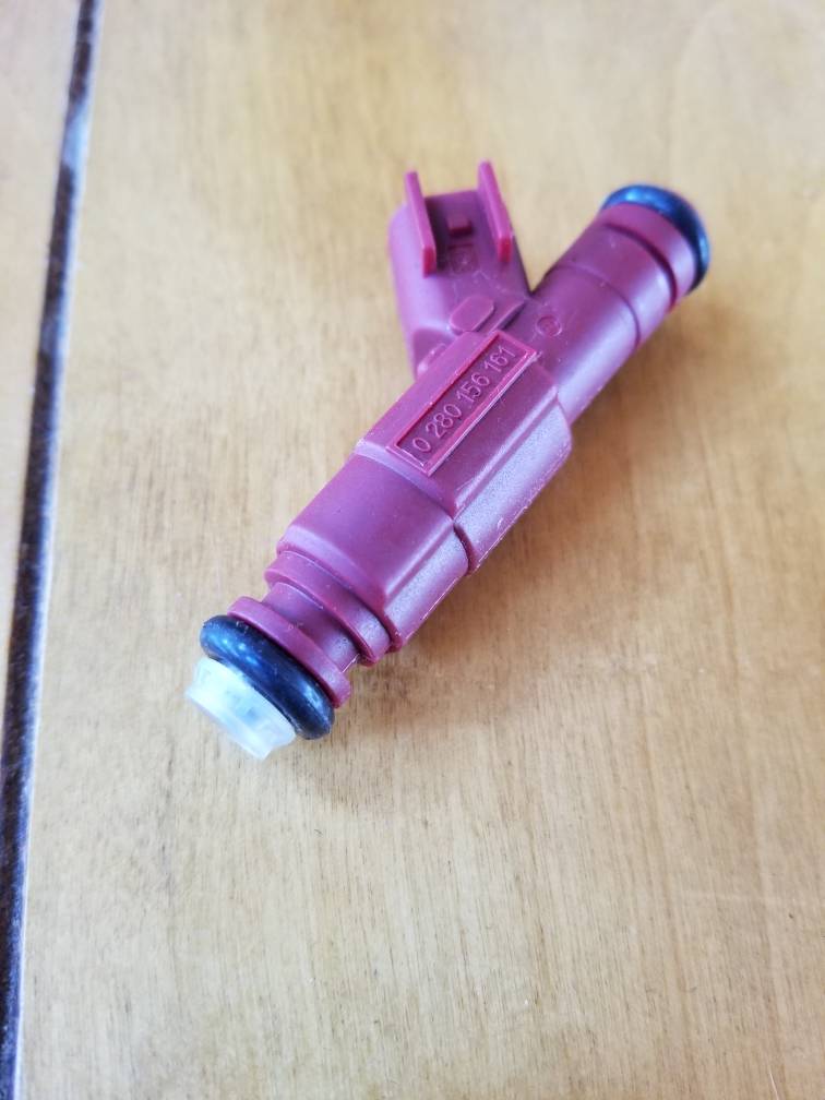

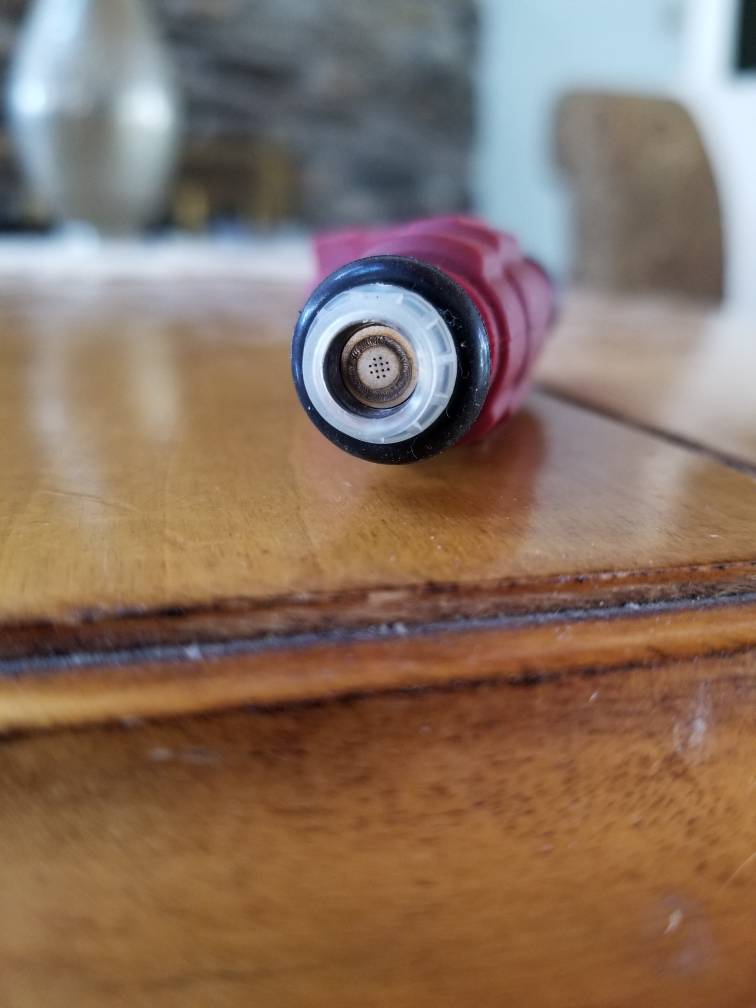

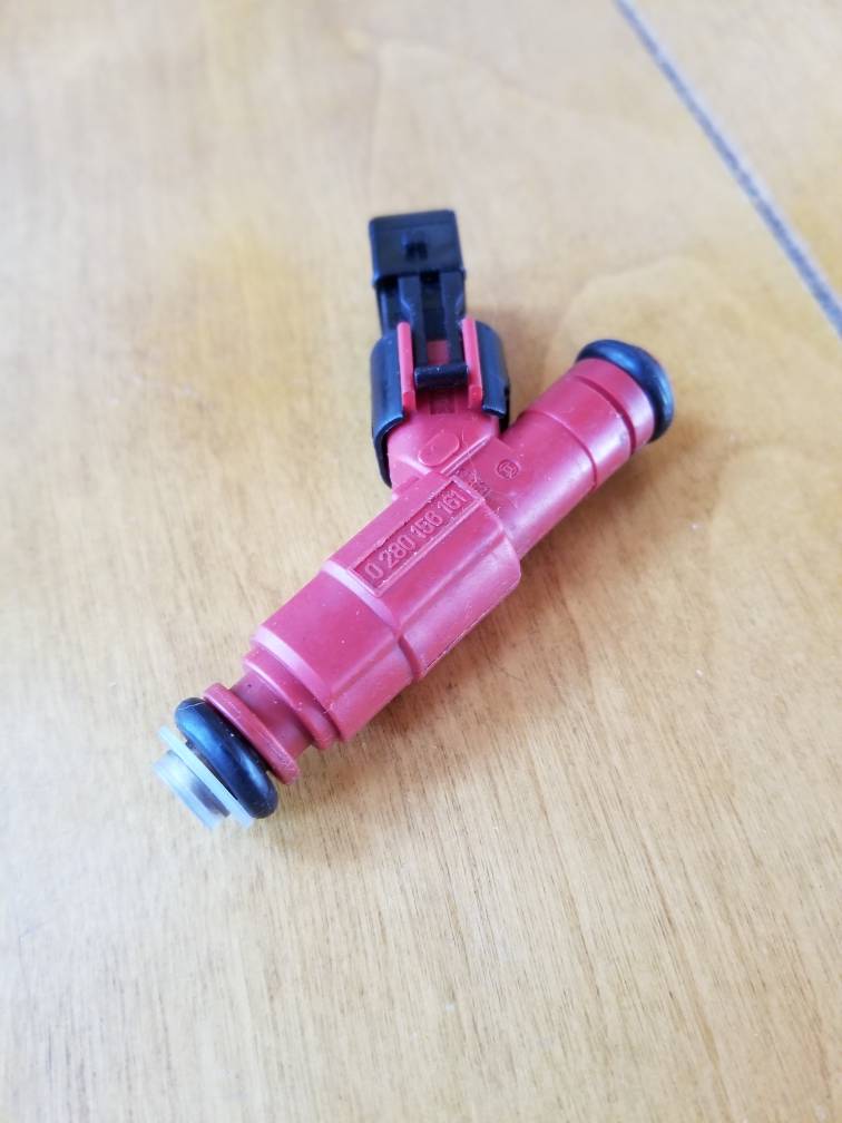

Long, long time later update:
So im actually selling these injectors off. People complain they dont work in Jeeps so I was planning on advertising them by spec, not for any specific vehicle.
I tracked the injectors down ignoring the ksuspension website all together. They are Bosch and the specs are only slightly different than oem aside from how the fuel is atomized with 12 holes vs single hole.
The specs are as followed:
43.5psi
22.8lb/hr
12 ohm
So im not entirely sure why they caused a miss at idle and bucking under load since 96+ used 49 psi and 21 lb/hr. Am I missing something here? Slapped the oem ones back in and it doesnt buck or miss at idle.
