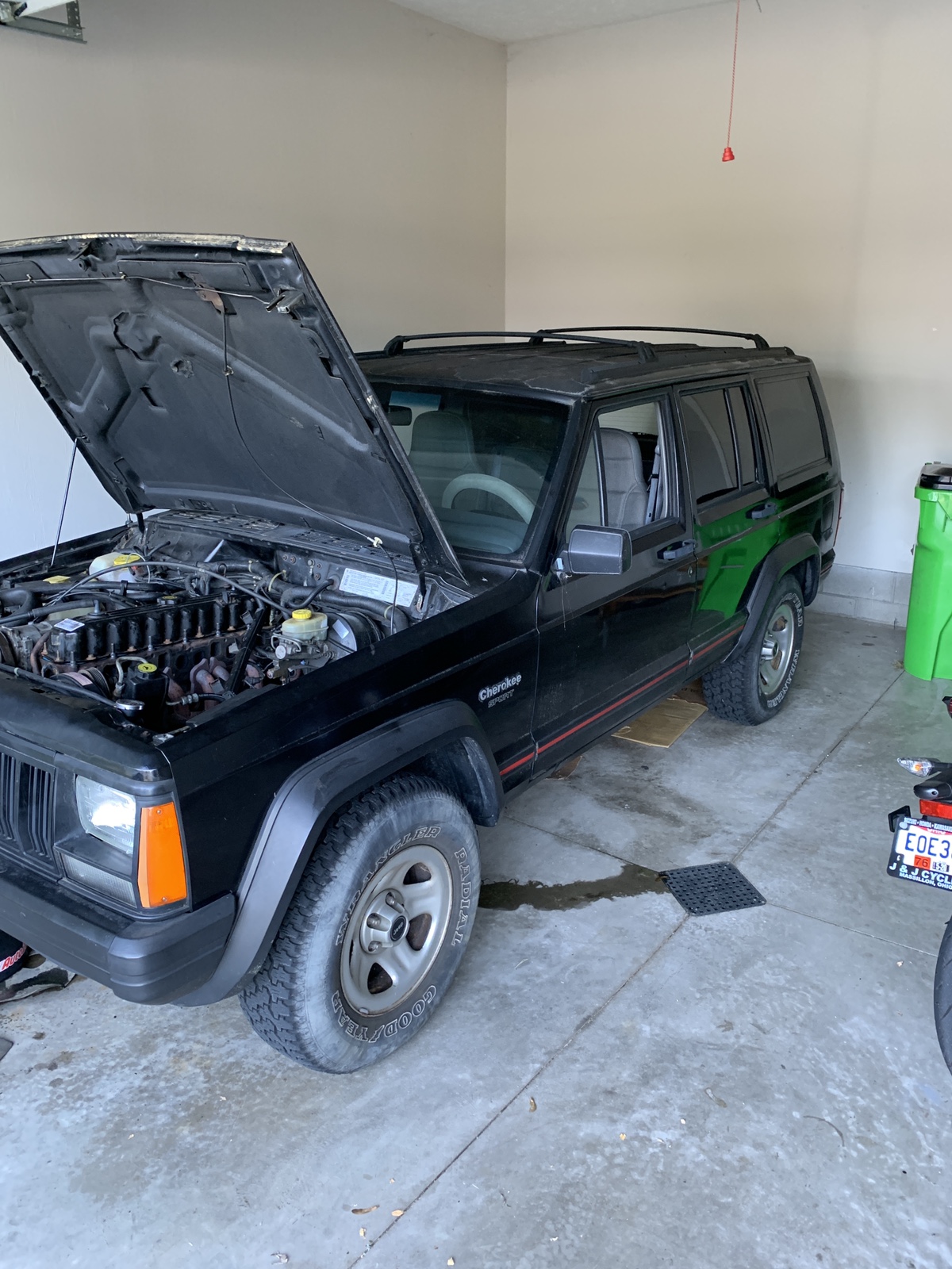

Hi everyone new XJ owner here.
Picked up this rust bucket for real cheap a couple weeks ago, had a cracked head.
If I can get it running I’ll probably start a build thread but it’s not running yet...

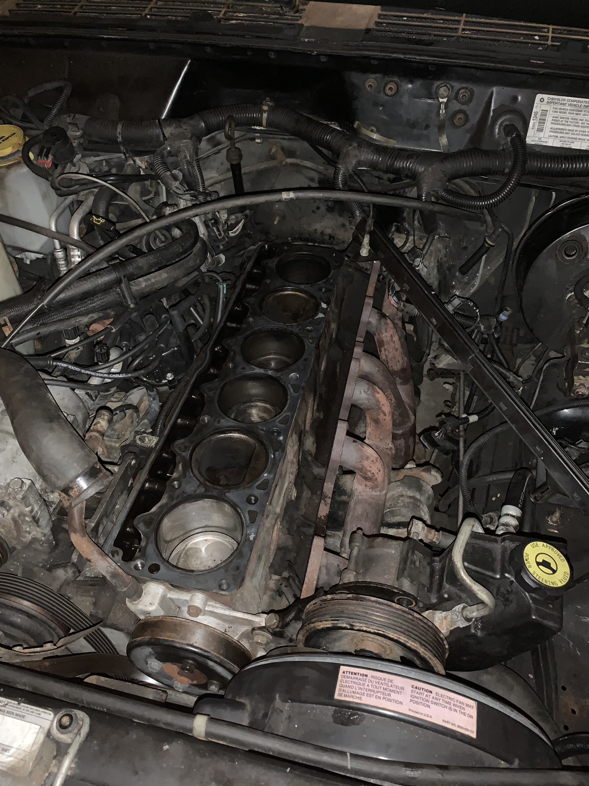

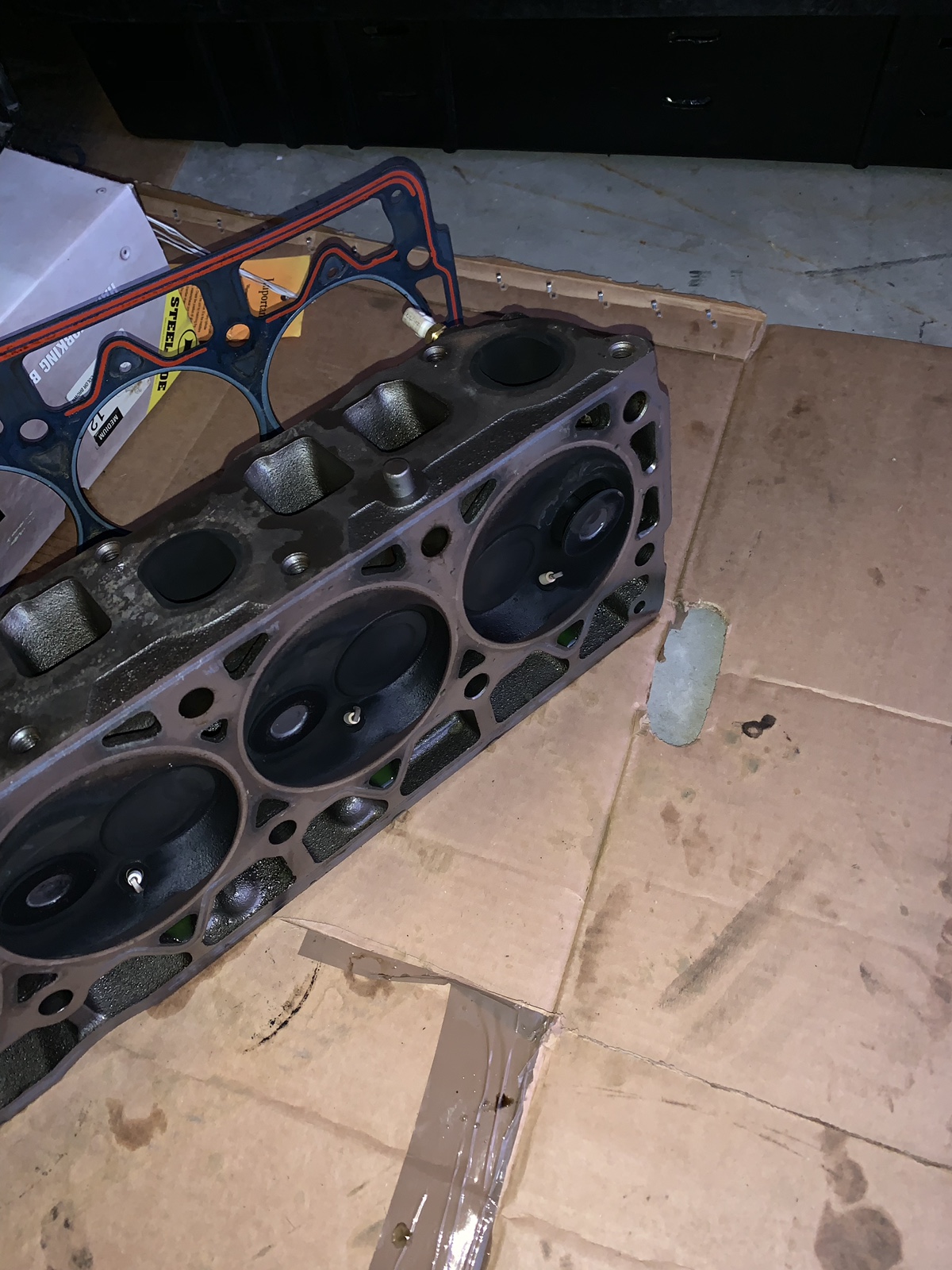

Anyway I pulled the head and got some new gaskets and other things to replace while I was in there
So I replaced the cracked head with a remanufactured one. Company seemed trustworthy and offered a warranty.

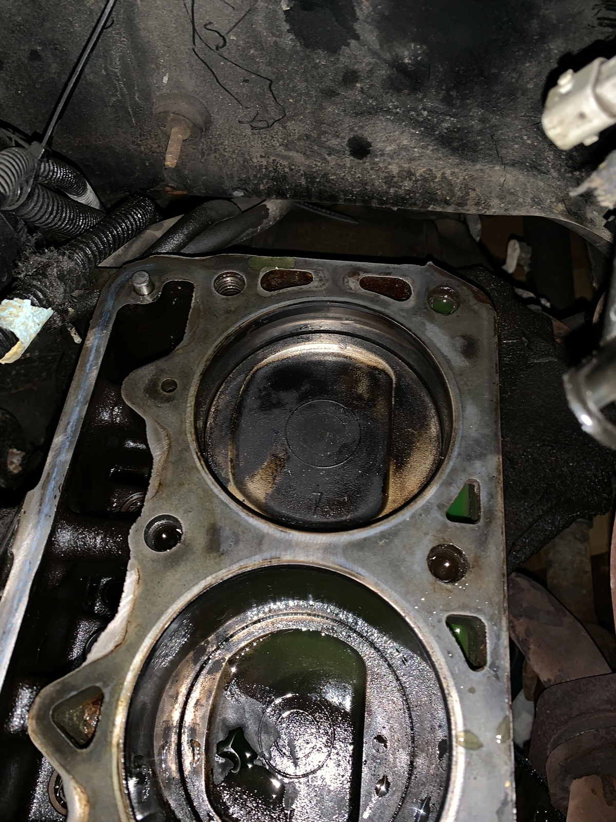

I got the Jeep running and put back together. I have about 40-50 miles on the new head and a valve, I assume stuck, and bent. number 6 cylinder exhaust valve
It left this indentation on the cylinder head. Kinda hard to see at the 12 o clock position. Looks like a pretty insignificant ding.
My theories for the valve sticking are that I either missed some lubrication step. The engine was running very rich, I put in a new O2 sensor that I think solved that problem about 10 miles before I bent the valve, so maybe a bunch of carbon could’ve built up on it, probably not from only 40 miles of driving but I’m not sure. Maybe the company I bought the head from didn’t clearance the valves correctly? I didn’t think the 4.0 is an interference engine. The company also said to adjust the valves, and I was pretty sure the lifters don’t need adjustment so I didn’t do that...
So my questions are what could’ve caused the valve to stick? Is the ding on the cylinder head anything to worry about? And then because I still have the old head can I just swap the bent valve out? Should I swap all the valves? Or do I need a new valve?
