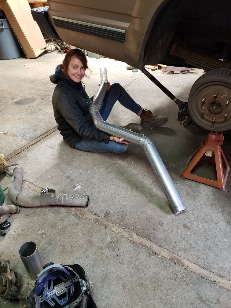

This is 3" my girlfriend and I fabbed for her suburban. It exits tight by fuel tank similar to the xj.
If you have a grinder with suicide cut off wheels and welder you can do it to.

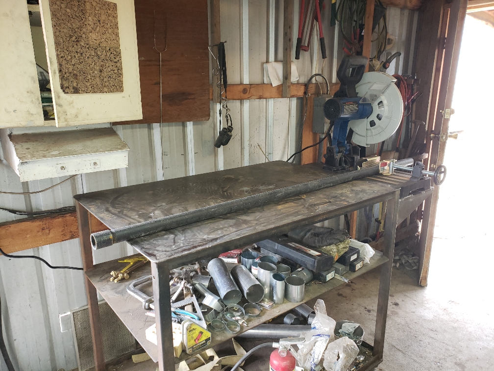

However a metal cutting saw makes it much easier to cut the pies for the bends. I make 6deg cuts
I have lots of short cuts off can never throw metal away. Did half exhaust on xj a few weeks okay. The suburban now a 80s ford is needing done.

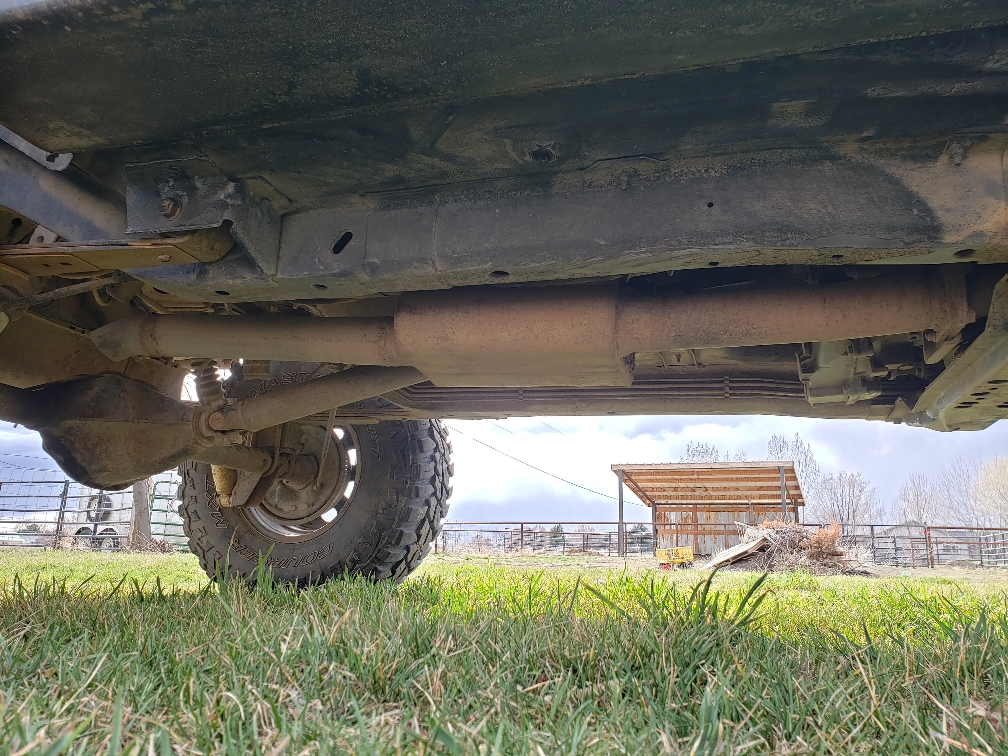

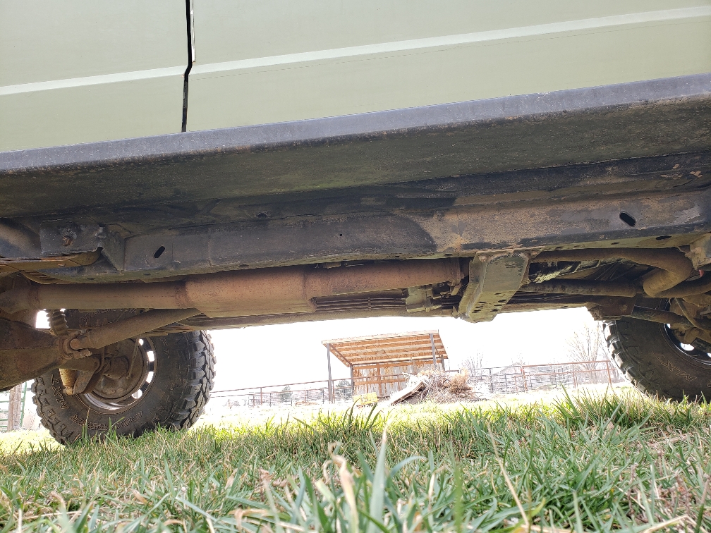

I looked under mine I dumped pretty much on axle with no issues even running on freeway at 80 with my foot on the floor.
I've had people ask if it's a v8 it has that v8 rumble with no rasp or popping. Itsnt terribly loud but I think it's to loud.
Pipe and muffler came off my k5 I yanked the rusted out cut and reused the flange at crossmember.
No issues for few years but does sit kinda low.
