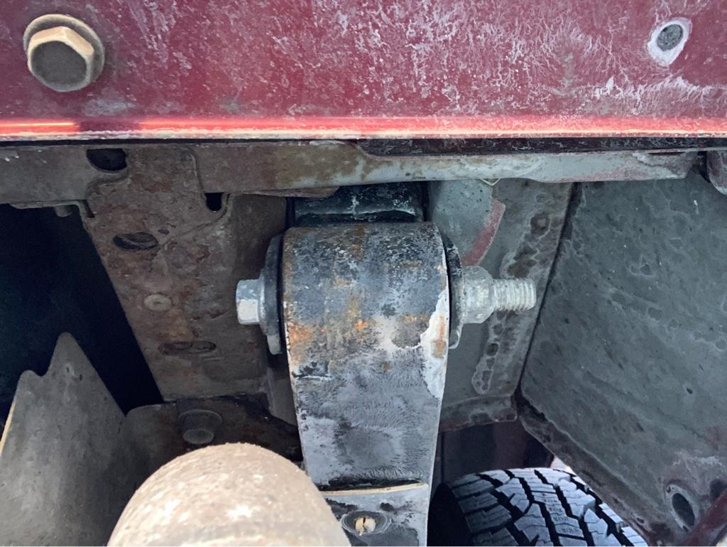

The more research i do on this issue also makes me wonder if the shackles arent set up correctly or are deflecting too much. Spring manufacturer says the front eye is correct and there should be some gap, but they need to be tight in the shackles and some cheaper ones that arent gusseted will deflect and twist under load.

Just to be sure that we're on the same page - the shackles are supposed to twist around the installation bolts via the rubber bushings.

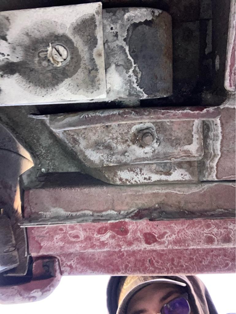

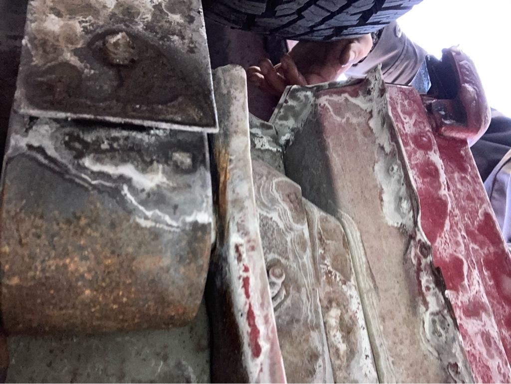

Pics of the gaps in the eyelets of the springs, not sure if it helps but the oem springs filled the body mounts tighter than this 🤷🏼*♂️
