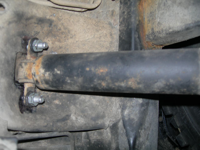

Hello guys, I'm Giorgio , I'm writing from Italy, I have a 1998, 2.5 Turbodiesel XJ . Last week I had a problem with a rear shock absorber, the left one. The two little screws (too little) in the top of the shock absorber was broken, I dont know why, I dont do hard off road usually....

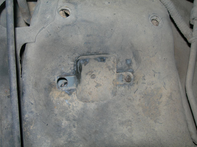

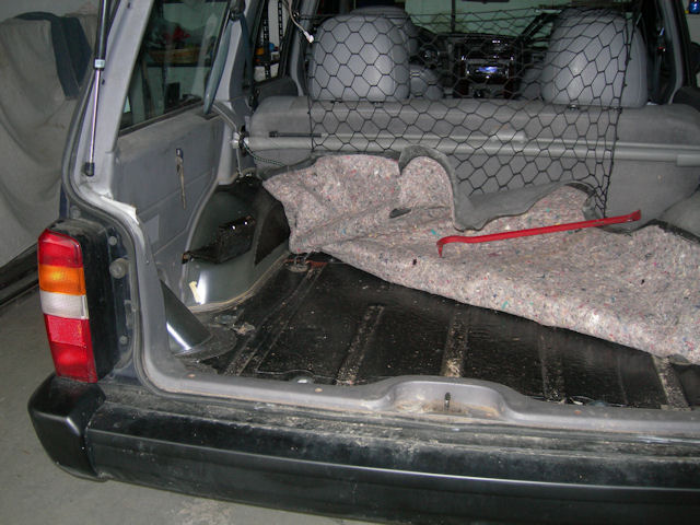

1, This is the start situation: both screws are broken, I have already removed one and I made a hole much bigger

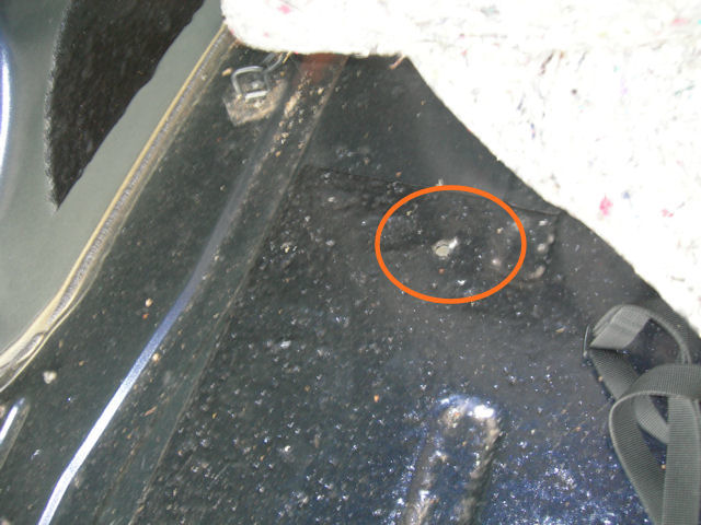

2 I had no chance of unscrew the two screw so 'I removed the cover
3 with a drill I made a hole under the car passing through

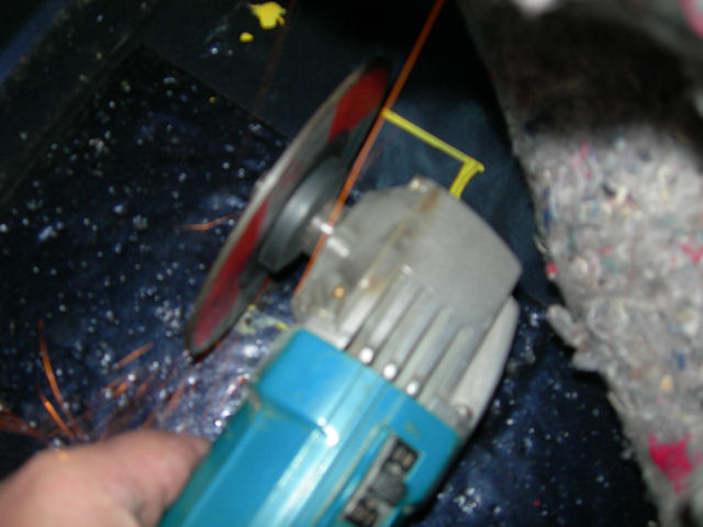

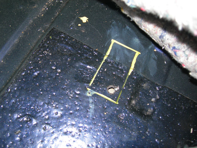

with a pen I drew a rectangle
and then I cut with the grinder (with a drive to cut)

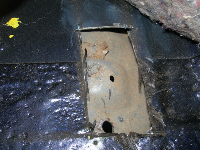

this is the square, just above the shock absorber housing

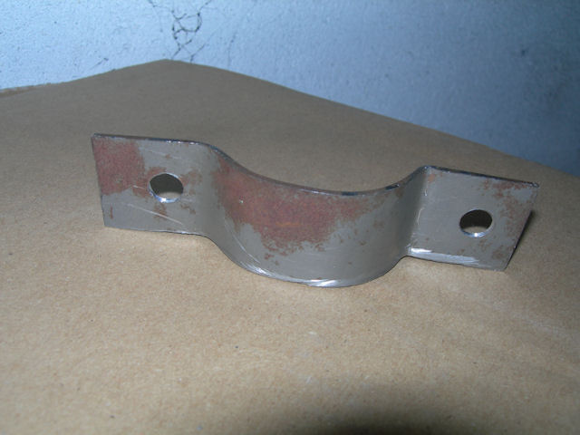

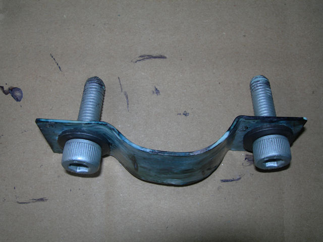

then I got a steel plate, with hammer and pliers, I bent and I made two holes

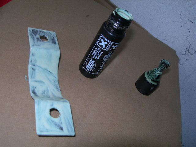

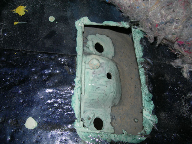

then I put on all the antioxidant (above and under the car)
also on the plate....
this is the plate with the new screws, bigger than the original screws for heavy duty use (INOX STEEL)

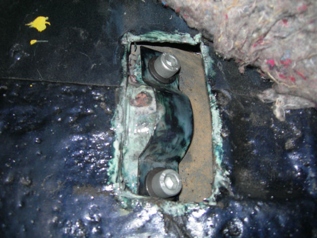

I put the plate in its housing
I put the shock absorber and I tightened the new screws

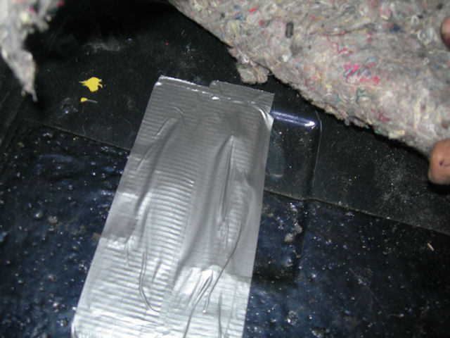

I closed the hole with tape but will replace it with a metal sheet cover
