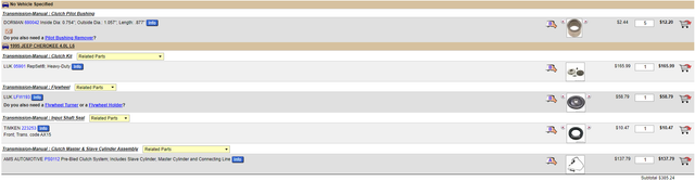

Before I hit order on this list I was hoping to get it double checked to make sure I have everything covered.
I’m putting an external slave ax15 from a 1995 into my 1990 Renix that came with an AW4. I’m not worried about transfer case or linkage, I’m going with a doubler and cable shifter.
I’m looking to confirm the engine side is covered by this.
I can’t find bolts on rock auto, anyone have a part number for the flywheel bolts? I think I can use grade 8 for everything else.
- Dorman pilot bushing from cj with 0.754 ID and 1.057 OD
- Luk clutch kit with pressure plate, clutch disk, release bearing
- Luk flywheel for a 95
- Timken input shaft seal
- AMS master and slave assembly
Perfect thanks. I was going to turn to arp but didn’t know they had a specific part number already.
I guess I need to swap the CPS to a Renix one too.
Add a manual TPS to that list... what else am I missing? I'm not quite sure in the seal department, is there anything else I need to change on the back of the block when going from flex plate to flywheel?
Here's the updated list:
- ARP flywheel bolts
- Renix CPS / new or swap existing from AW4 tbd on brand
- Renix manual TPS tbd on brand
Also, just cuz I haven't explicitly stated it, I have the trans already which has the clutch fork in it. I also have the pedal assembly from the 95. I have the shift boot.
