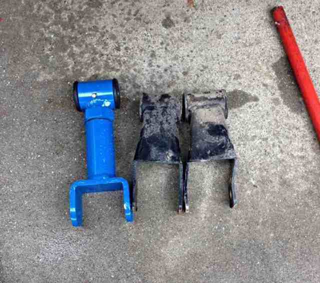

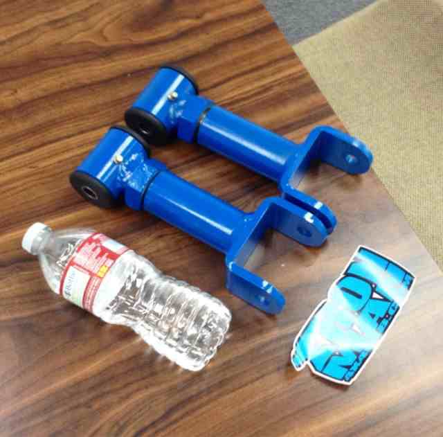

Iron Man has two different shackles - one straight, the other angled. Preference? What's the theory behind these two? Waiting on answer to these questions from Andy but thought you guys might know.

The iron man shackles are not for you. They will give you 2" at least on there own. Do shackle relocators and then get a good 5"(hole to hole) shackle.
