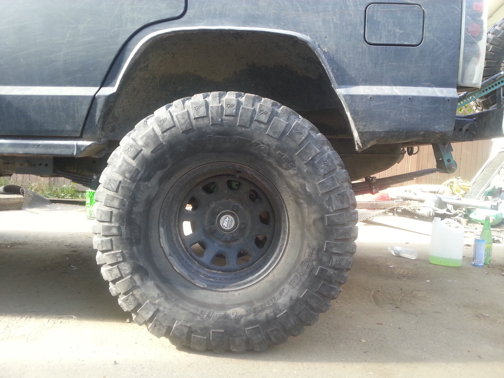

98 XJ, 5.3/4l65e/np231-241hybrid, long arm, OTK/OTA, 63" chevy leaf rear (3.5" lift springs plus XJ main for support), d30/44 locked, 35x12.5 (but probably going to 37's).
Built new mounts for the 63" leafs. Gave them 6" of adjustment for future plans. Currently set as far forward as they go, which is just about dead on stock location. Rear mounts are between the bumper and chassis.
With how well this thing flexes, the 35's are too big to fit in the wheel well, even after trimming and folding. Rubbing on the bottom front and back which is really preventing the rub from hitting the top :).

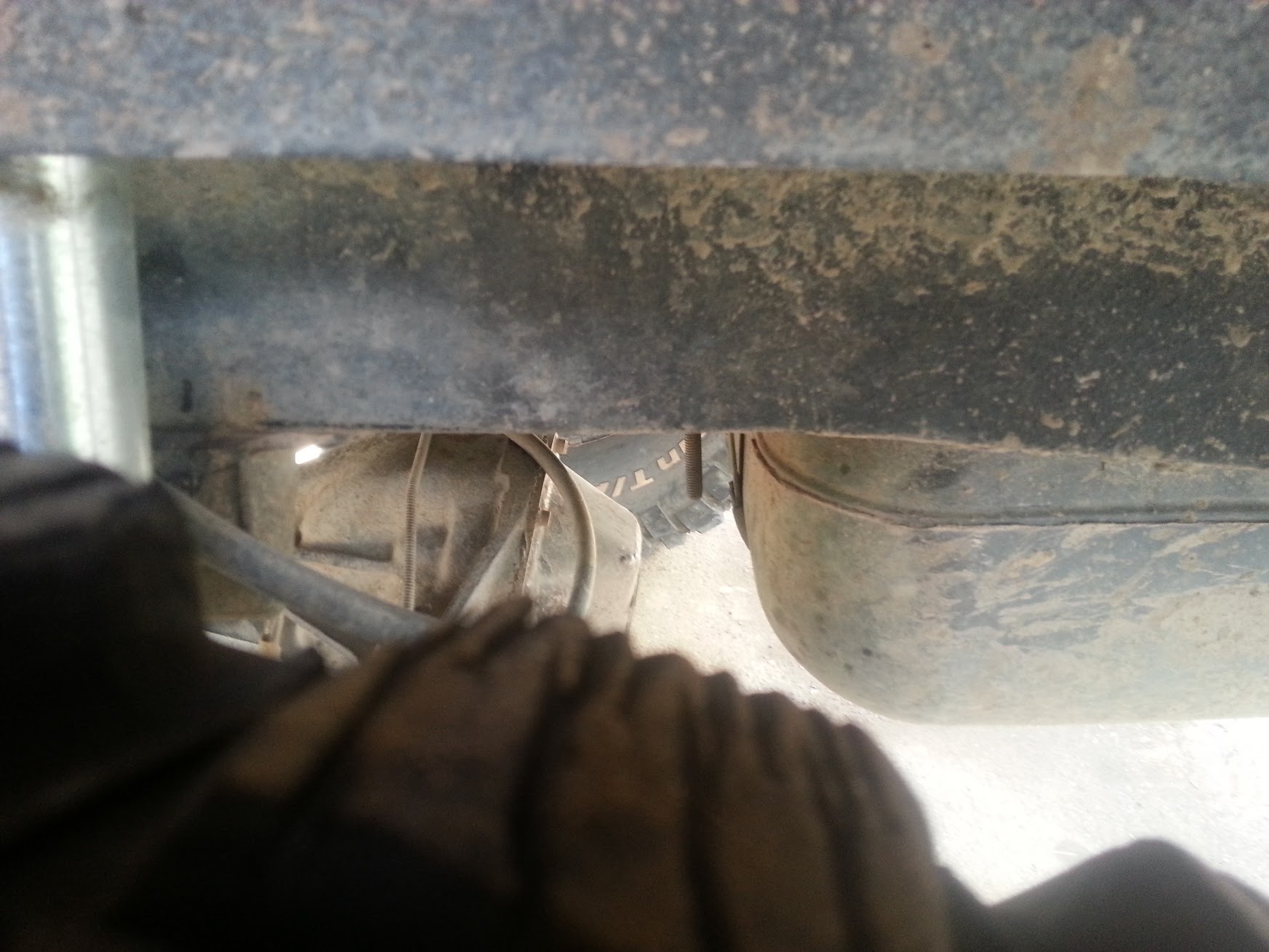

I've got about 3" between the back of the diff and the front of the fuel tank, and the fuel tank can be moved further back a few inches, or possibly even inboard it through the floor (or build a fuel cell).
Just fishing for idea's on how to do the wheel well chop. My current thought is to just cut'm out inside and out from half way back, to around the fuel door, then wrap the edges with some 2x2 square tube which'd tie into the sliders back to the bumper. This'd give me a good surface to weld the new sheet in on the inside, as well as a handy spot to mount flares (I hate off the shelf flares so I'll probably just layer a few mud-flaps all the way around the well. Really not interested in spending a grand on a flare that will break off the first trip out :p ).
With this setup, I think I can get about 4" of extra room which should be more than enough for 37's, even if/when I drop my Jeep 2". Not entirely sure about the gas tank yet.
Either way, for now all I REALLY need is about 1-2" to clear the front of the well, but seems like an awful lot of work to not just take it all the way on the first try.

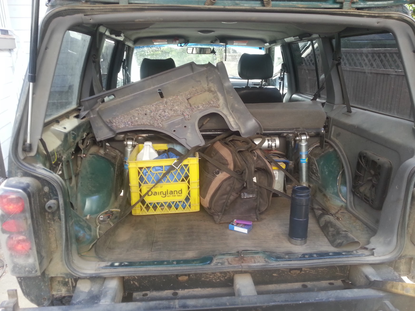

Anyone got pictures of the inside of the rear quarter?

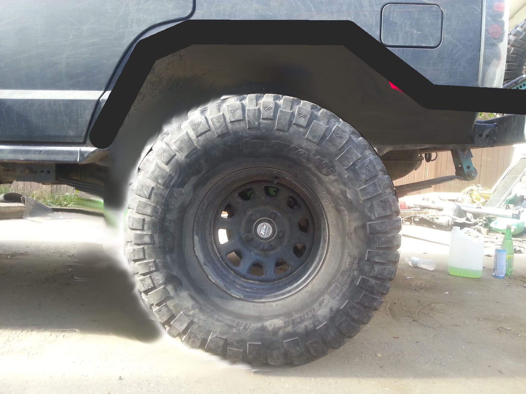

I would cut the wheelwell in half and around the exterior lines then move it back 3-5" to get your clearance. Then like your said just get sheet metal and weld in the filler. If you want a "harder" line then just cut the body in line with the wheelwell back to the rear and put flat unformed sheet in to enclose the rest.
From this:
CL0zQRKlF5dPcflLI--2z2bcmhyB-31pl-Umqy_bF9fu=w1745-h1309-no
To this:
fYyMpFCXGJr1iL1Ele84QNB1nwJg6cHBNwrkU6mxxWxk=w1745-h1309-no
Roughly. Just a bit scary cutting all that stuff out, with really no body experience (though that's always the case with all my projects, and they all turn out decent).
I think that's what I'll do though. Chop the well in half, cut off the outside lip, separating the outside panel from the well, then tie them back together with 2x2 or 2x3 tube, cut out a few inches off the back of the panel and floor, weld in the back half of the well, and put a 3-4" patch in the middle. So much work for a few inches...

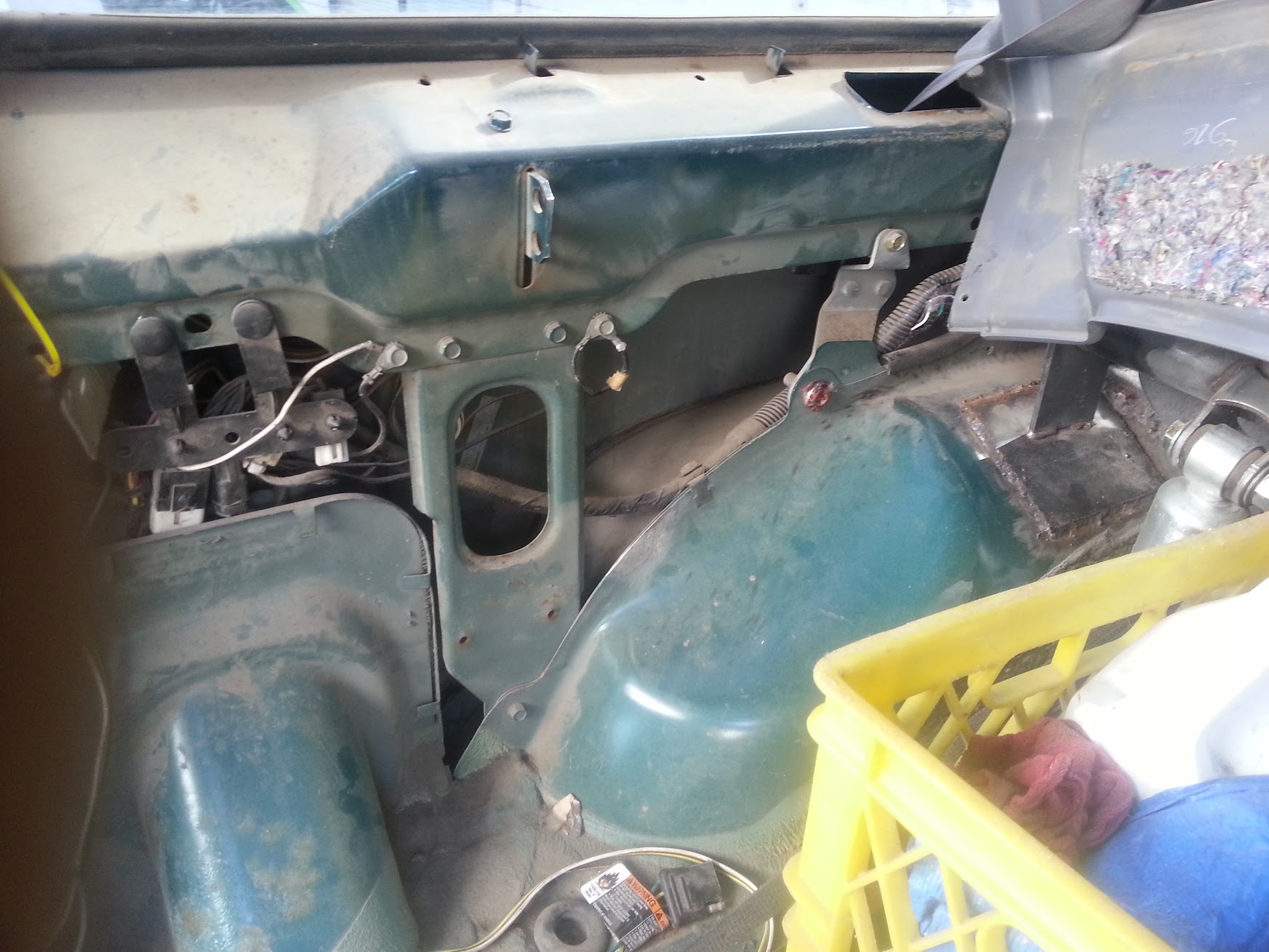

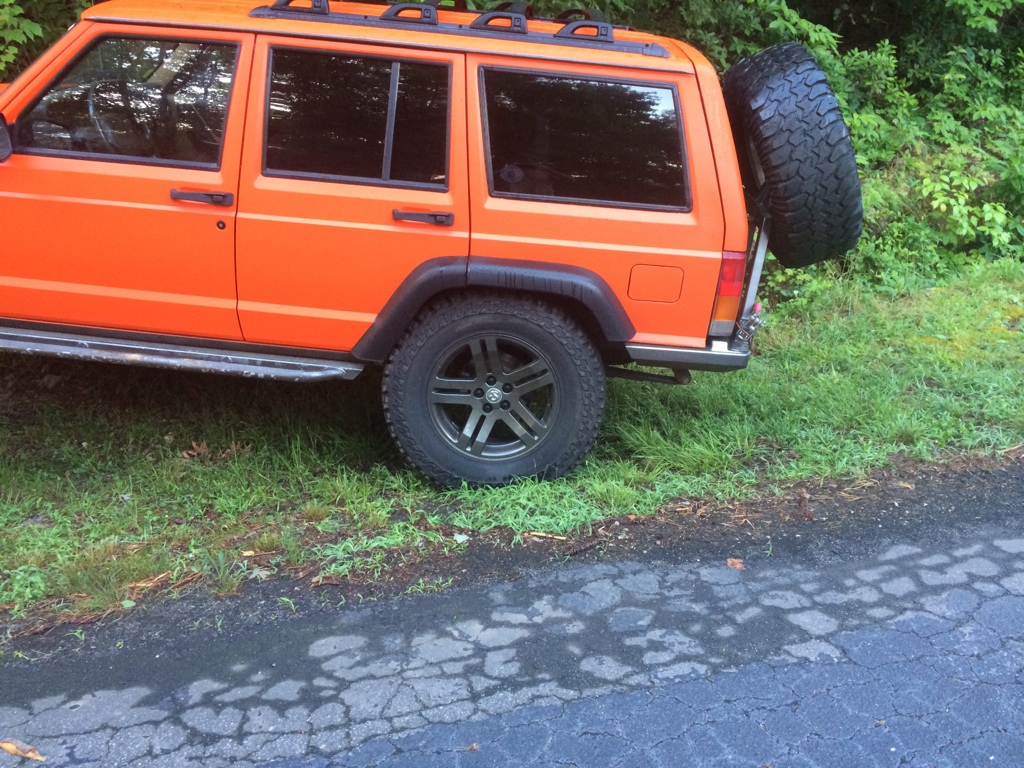

I did it on my. It wasn't too bad but sucked for my buddy who did the welding. Unfortunately with the flares on you can't fully see it but we extended about 3", about the max I could without getting into the fuel filler neck. Honestly if I did it again I wouldn't worry about that and I'd go as close as I could without affecting the filler door. Only problem at that point becomes finding a flare that works for it. We also extended the front of the wheel well. I wish I had left that alone, so that I could possible have mounted a flare to the body instead of the door. Hindsight 20/20.

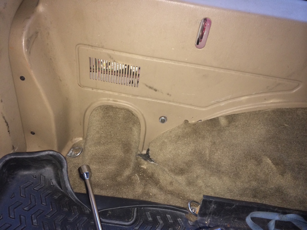

Here's the inside on the fuel filler side. You can see how I trimmed the interior panel and the carpet to fit. Maybe could go another inch.
