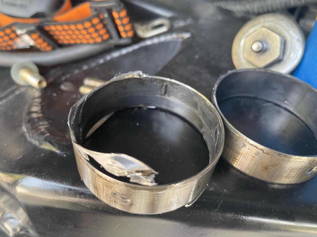

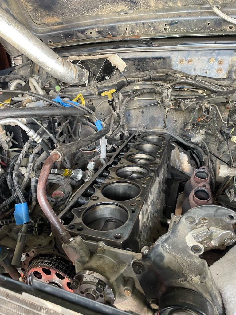

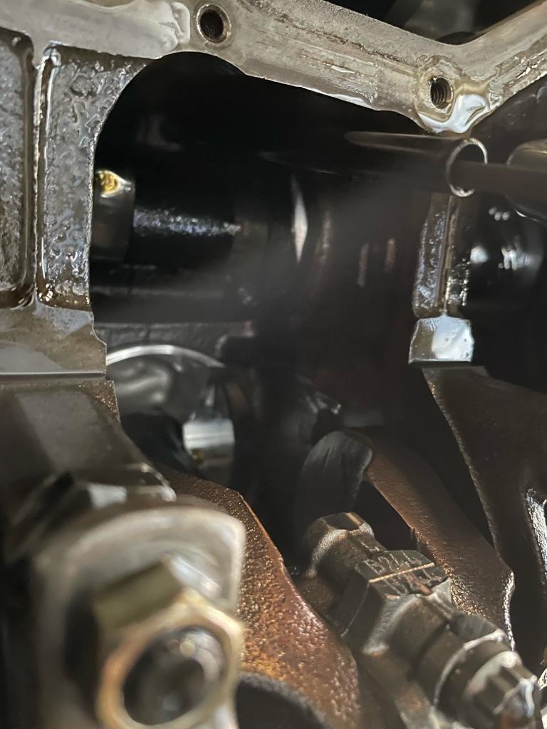

Just to give people a heads up. The Lunati Vodoo cam #10680701 caused my #2 and #3 cam bearings to balloon out after only 2000 miles on my stroker build. It seems to be a problem others have had as well. I have since then replaced the cam bearings, but it was a total pain in ass.

Wasn't it you who did the thread on your stroker build with dyno results? From these pictures, yours is a 2000 Fed. I wonder if you are using the cast iron stock exhuast or a header? A head from Russ? Compression ratio? Did you use the cam bolt with the delrin nose?
Yes, that was me with the dyno results on the stroker. The cam only accepts the earlier style cam bolt with the spring button, so that was used with the proper timing cover. When I put the new replacement cam in I went with one that accepted the later style cam support. Yes, it is a 2000 engine. I am running the Banks headers for CA emissions (the 2 pre-cats) The compression ratio is 10.5 to1 with an aluminum Edelbrock head. Do know that Russ does not sell the Lunati cam with his stroker kits, that was a choice I made based on a recommendation from another friend. I just wanted the NAXJA family to be aware that the Lunati cam can have problems in strokers, and to be mindful of it. After doing some digging I did find that there were other people who had the exact same problem - #2 and #3 cam bearing going bad with the same cam.
Can you define/explain "ballooning"?

Your pics don't tell much, Are you trying to say that you were "hammering" them wider/thinner?
