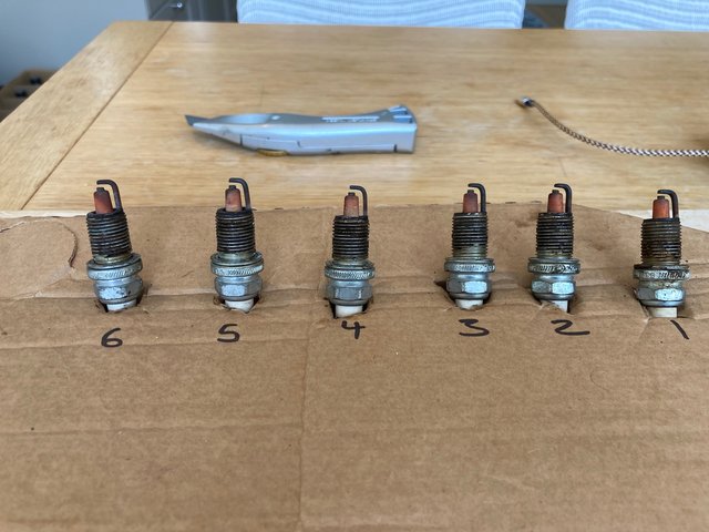

As i was undertaking a plug and wire service thought I'd take some photos of the old plugs. I was surprised to see the oranage/brown colour of the insulators but remembered I had used an STP fuel additive to ensure the 4 hole injectors I'd fitted 3-4 years prior were as clean as possible.
Here are the plugs in order (no.1 cylinder to the right):

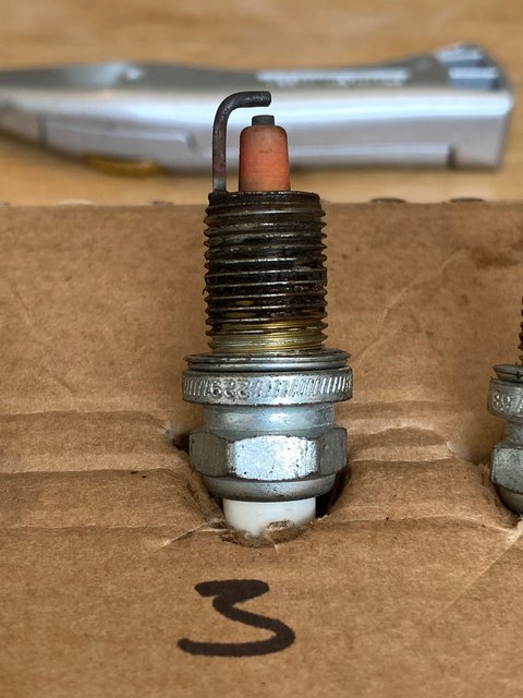

and from other side:
Close up both sides of no. 3:

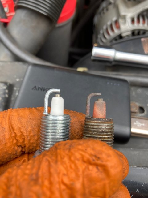

Comparison of new Champion plug vs. old - note slight erosion of electrode.
*these plugs are maybe 3 years old (15k miles?) and gaps had been set at correct 0.35" and some had increased to 0.45" - 0.50":
They don't look bad, what part# on the injectors? You might be a little "fat"!

Aside from the gap looking to be growing, they really don't look bad. Not great, but still usable if needed.
I'm pretty sure the orangey/red hue is largely due to the fuel system cleaner - seen it evidenced eleswhere. I'll check the new ones in a few months and post photos She runs smoothly and idles well (should do after all the work I've done!) so looking for nice tan colour and no fouling next time.

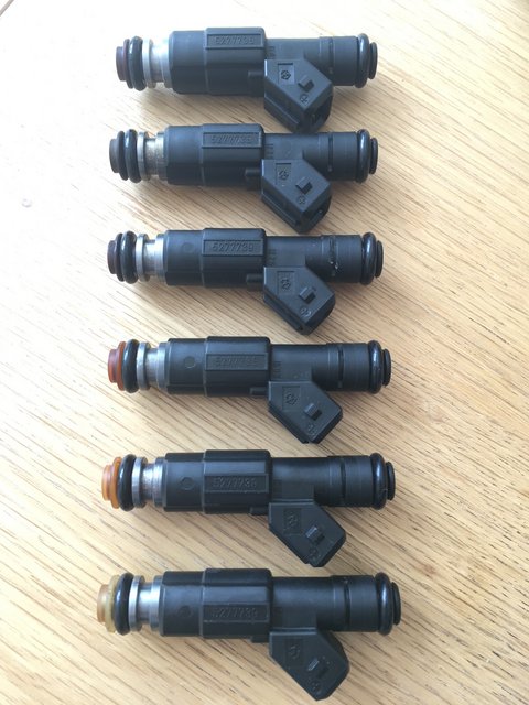

I've done some digging through 'the archives' and found this photo of the injectors I used. They're Chrysler # 5277739 the Bosch equivalent being # 0280155703 22.7lb/hr @ 43.5psi
Renix and HO don't take the same injectors though?

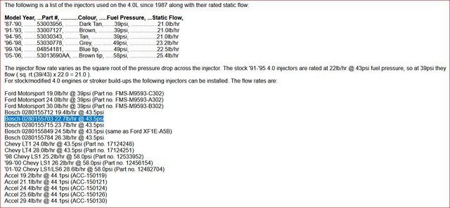

Checking against the chart below maybe the flow rate is a touch lean for a '96 which runs ar 49psi?
Possibly if your pressure is not correct, but that injector will flow more (see example) at 49psi.
