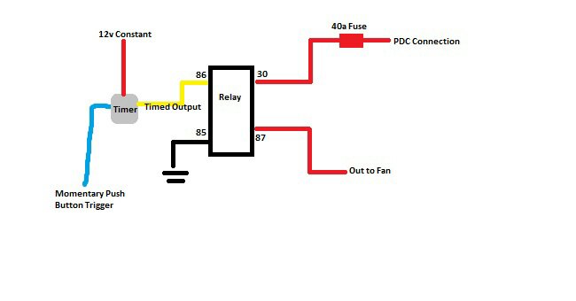

I still don't understand why anyone would want to control a fan that cools their engine w/ time instead of temperature.
It's odd, what if the engine temp doesn't come down enough in the time that's set?, I must be missing something.
Sorry op I'm "hijacking" your thread.
I'm not cooling the "engine" - I'm cooling "under the hood". It's the under hood temps thanks to the mini cats under the intake that create the vapor lock during short stops. Moving the hot air out and away from the fuel rail is what this is about. I couldn't care less what temp the engine is at.
Usually vapor lock occurs with short stops, around 10 minute average. Running the fan for 3 of those minutes should pull enough air through, coupled with the convection of fluid you just discussed, to cool the underhood area enough to prevent the fuel from vaporizing in the injectors.
I already have hood vents and the DEI fuel rail wrap/tray. The timed fan should keep air flowing through the compartment out the vents long enough to keep vapor lock from occurring.

Wait a second, what engine is in your jeep?.
And now that you mention the mini cats(which is why I would like to know what engine you have), why don't you just wrap them with some dei header wrap or something?
The whole timed electric fan thing is something that was developed for drag racing. People that don't run an alternator want to put time on it instead of temperature to control the fan in an effort to avoid a dead battery between rounds.

hood vents will do more for underhood temperature than a timed fan
Actually, I do not have hood vents so I cannot speak about whether or not they work. I guess they do work if installed in the correct place,....many manufactures uses them. The ones I like and I think will be more effective on the XJ are installed just behind the radiator where the hot air from the cooling fan strikes the hood. That approach in my opinion would be the best approach to moving cool air through the radiator without passing it over the already hot engine or should I say passing less of it.
I have installed on my XJ more than 10 years a pair of electric fans, the fan controller is this, http://www.dccontrol.com/selector.htm, the 45 amp constant temperature version. and wired hot to the battery. The fans run when the preset temperature is reached and stops when thee coolant in the radiator (it have a probe in the radiator fins) is reduced. They cycles on and off for up to 30 minutes after the XJ is shut down. In South Florida, my XJ have not had heat soak since then. Even though the engine is not running, the temperature in the entire cooling system is reduced by simply moving cooler air through the radiator.
