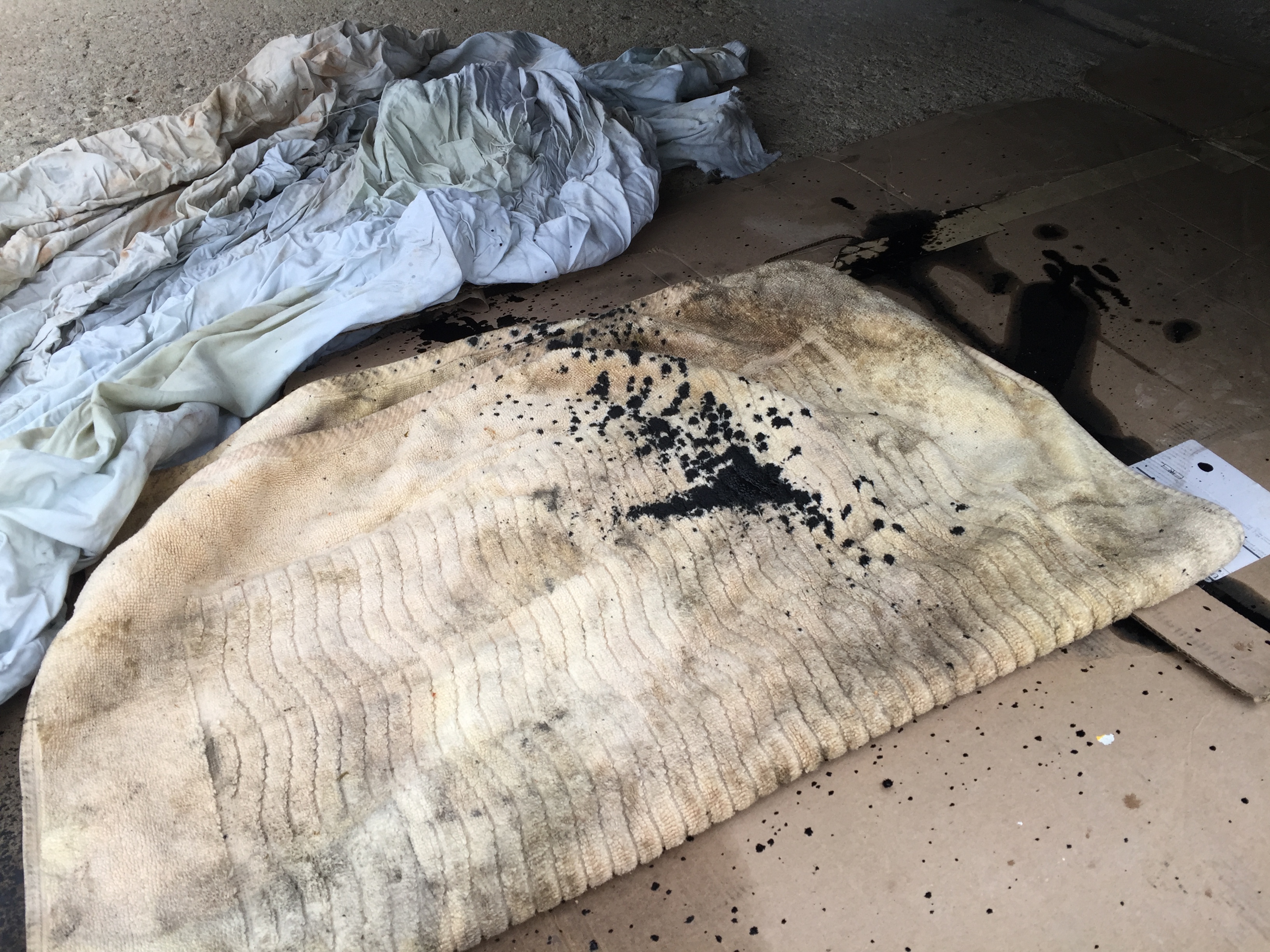

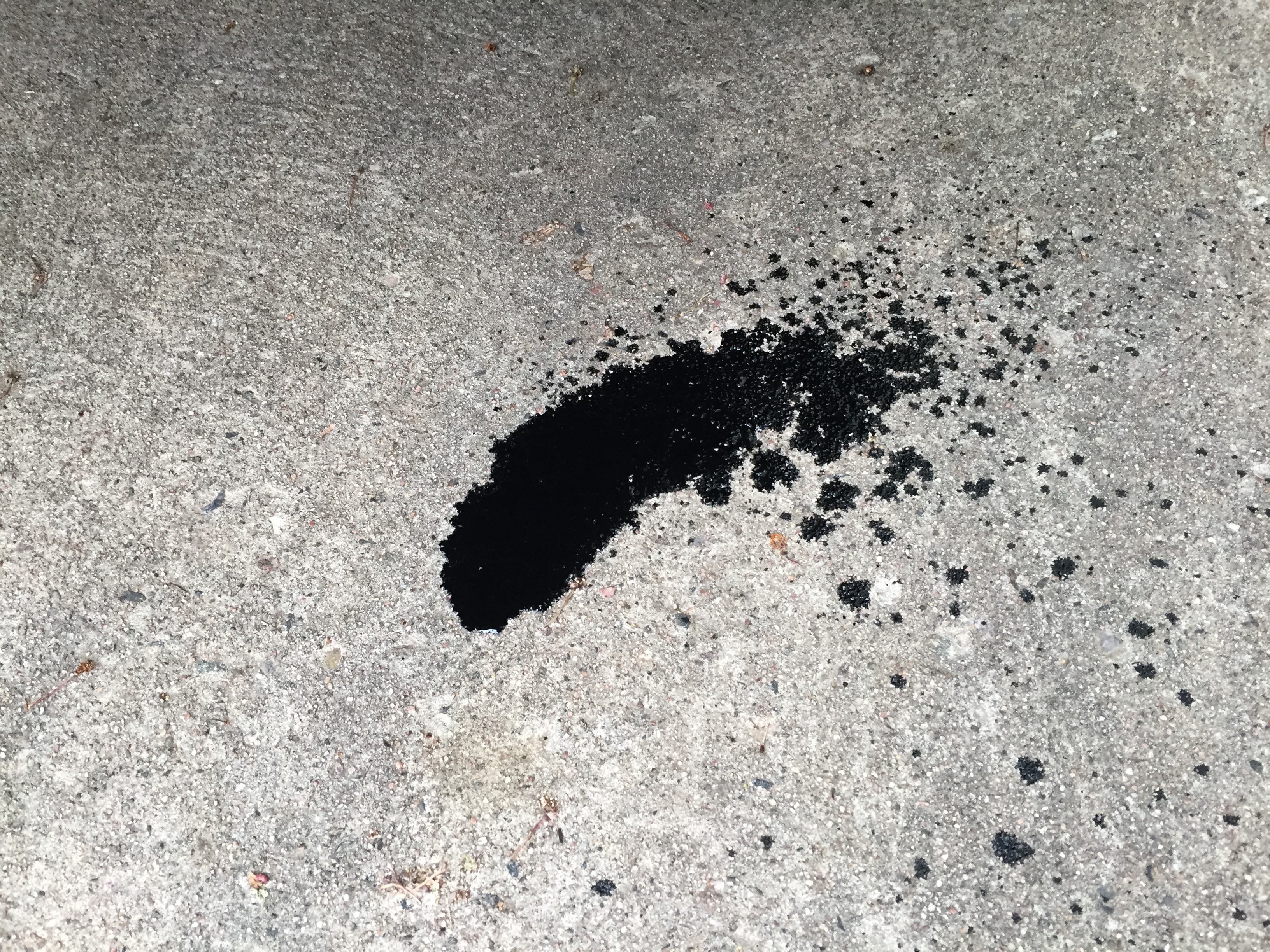

Since the oil turbo failed with a broken shaft massive amounts of oil were able to fill up the exhaust. After I got it running the pooled up oil started making its way out - and making a massive smoke cloud. It took come effort of warming the engine up - getting oil to start dripping out, and shutting it off before it blew too much smoke. I got out at least a quart this way and then went for a drive at 9pm when it was dark to blow out the rest. After a short drive at operating temp the oil was finished burning out. I think I made it much better by getting the oil to drain out before the drive. It really can make a massive amount of smoke - been there before.

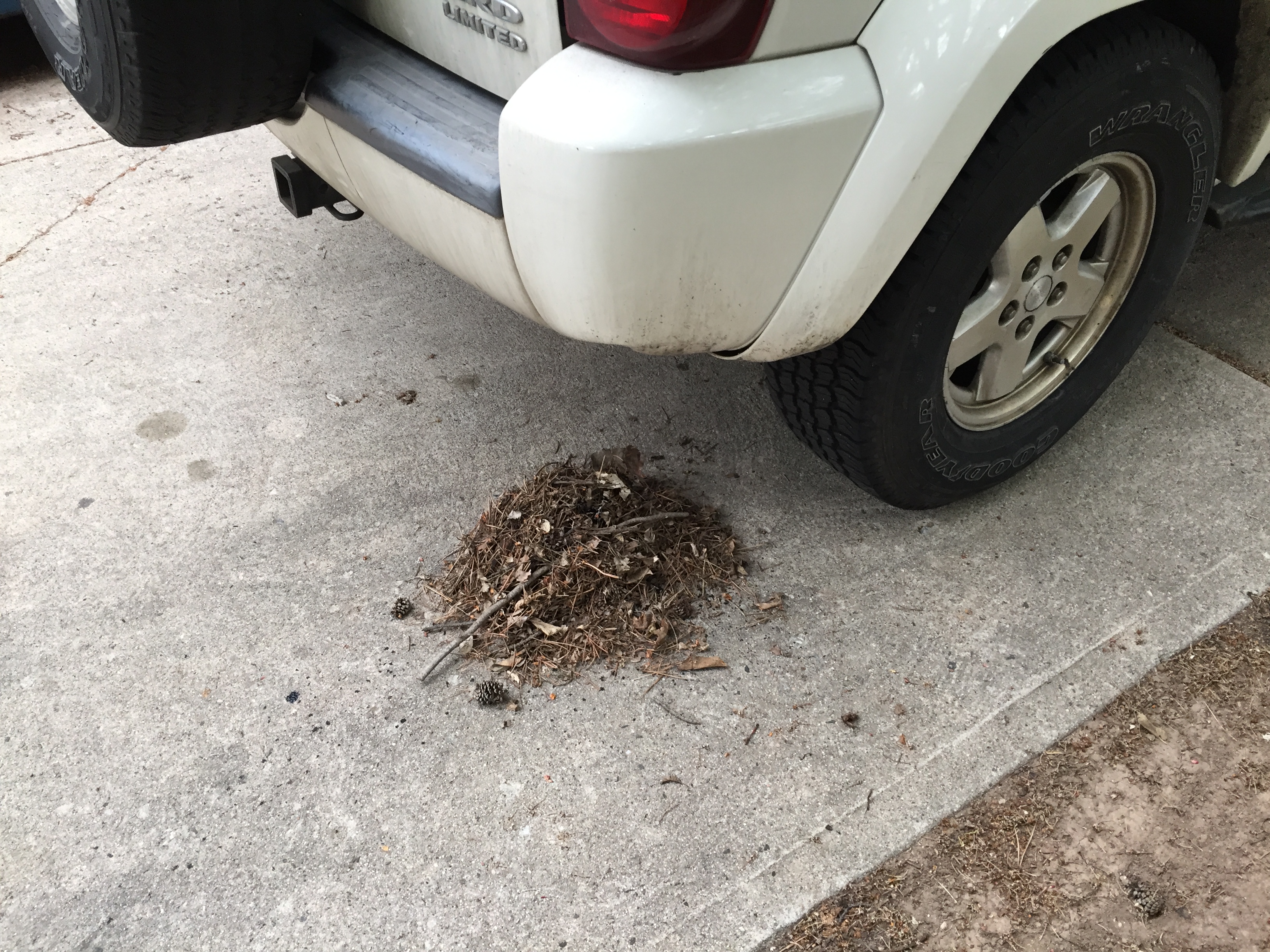

Ugh, got it on the driveway:
Pine needles and leaves to the rescue!

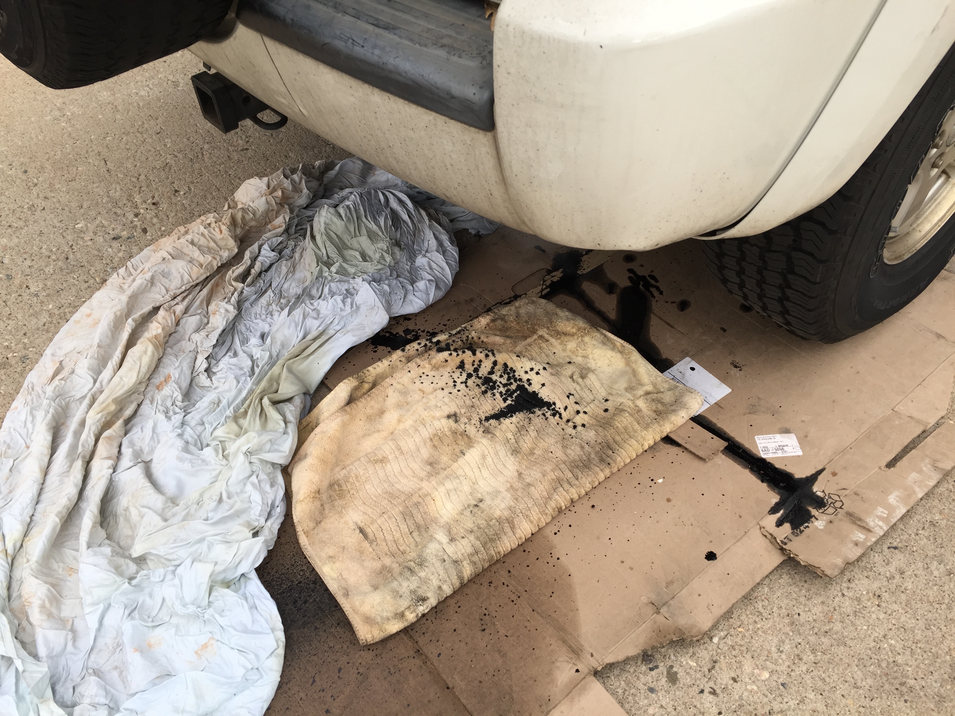

More oil blowing out:
This is even what a tiny amount of smoke looked like..........Think smoke so intense and big that it could cloud a football stadium and not let you see the field. Thats what it would have been like if I hadn't kept it cool and blowing out oil.

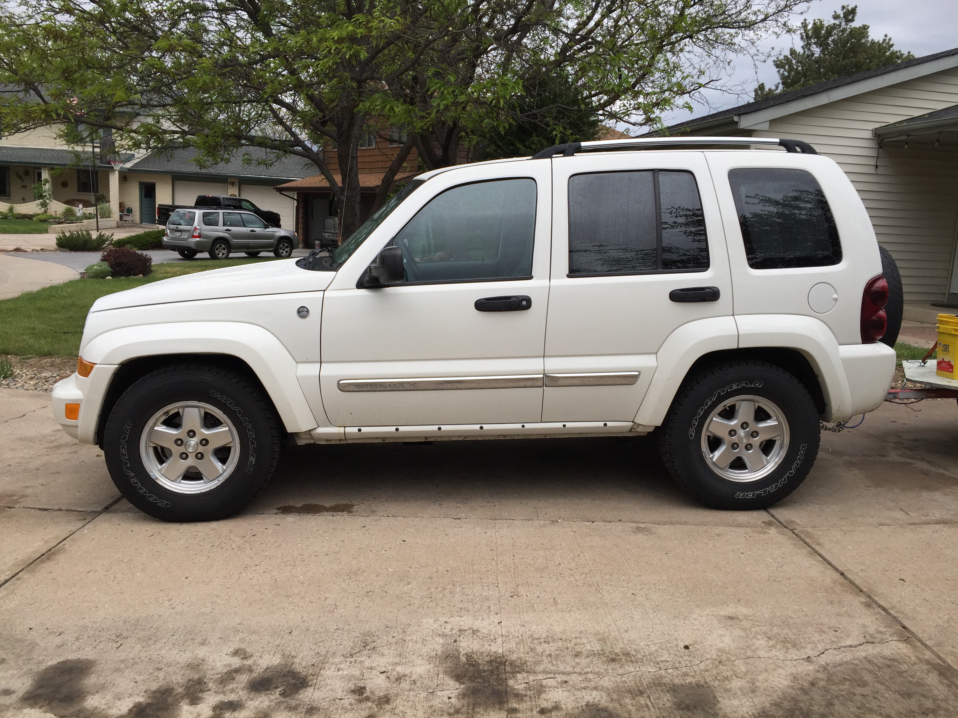

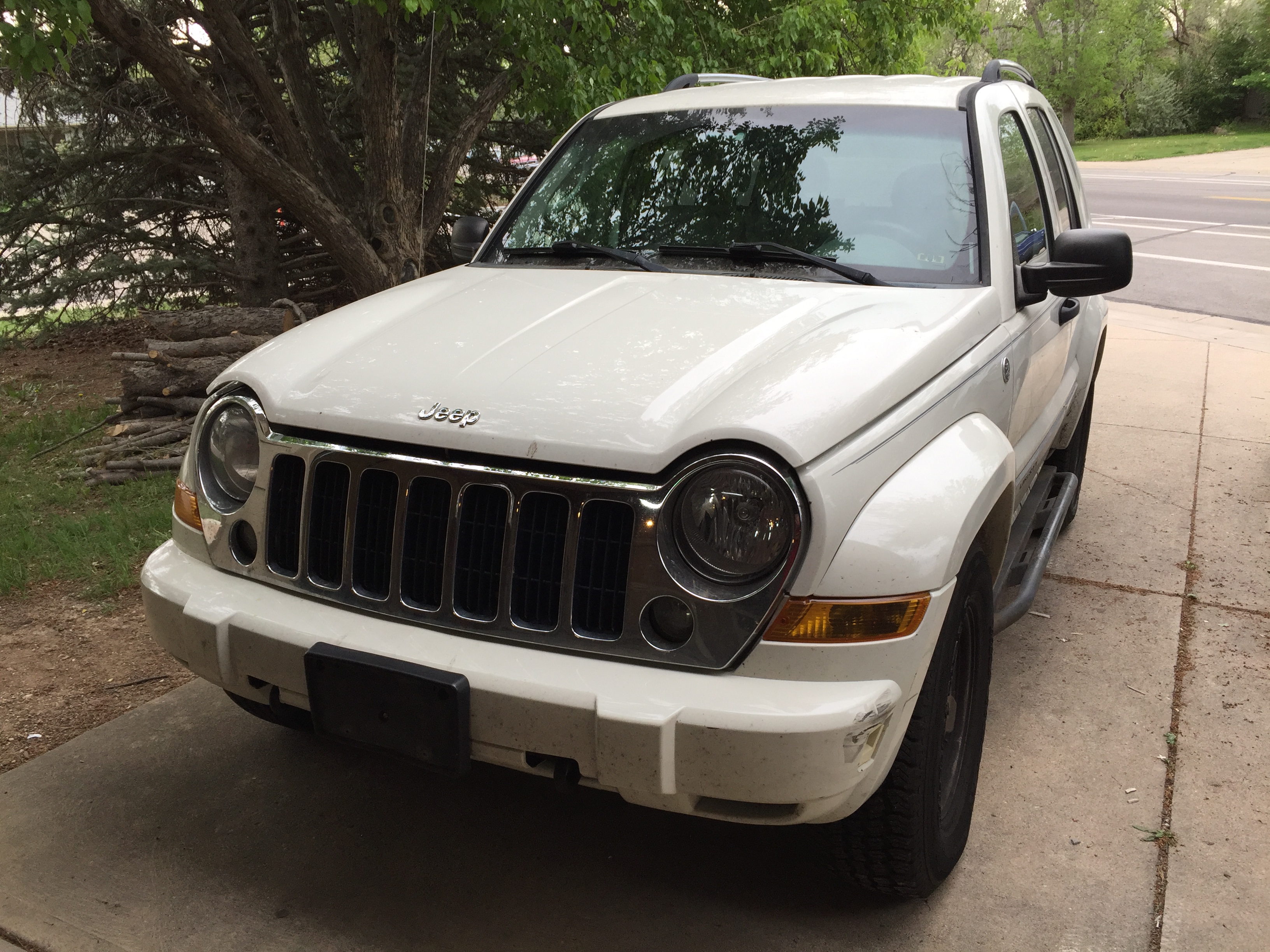

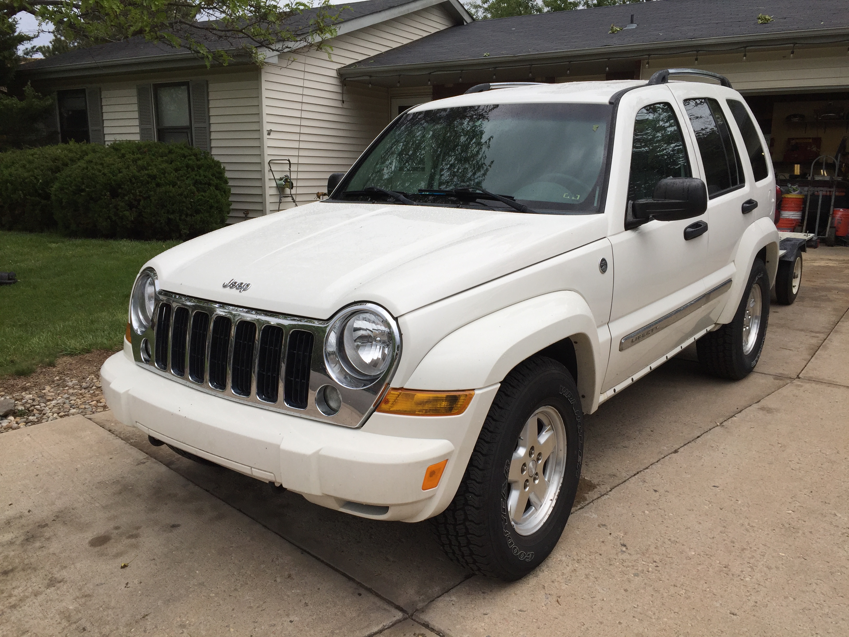

Well Jeep is cleaned up and ready to roll. My dad is driving it back to california tomorrow.

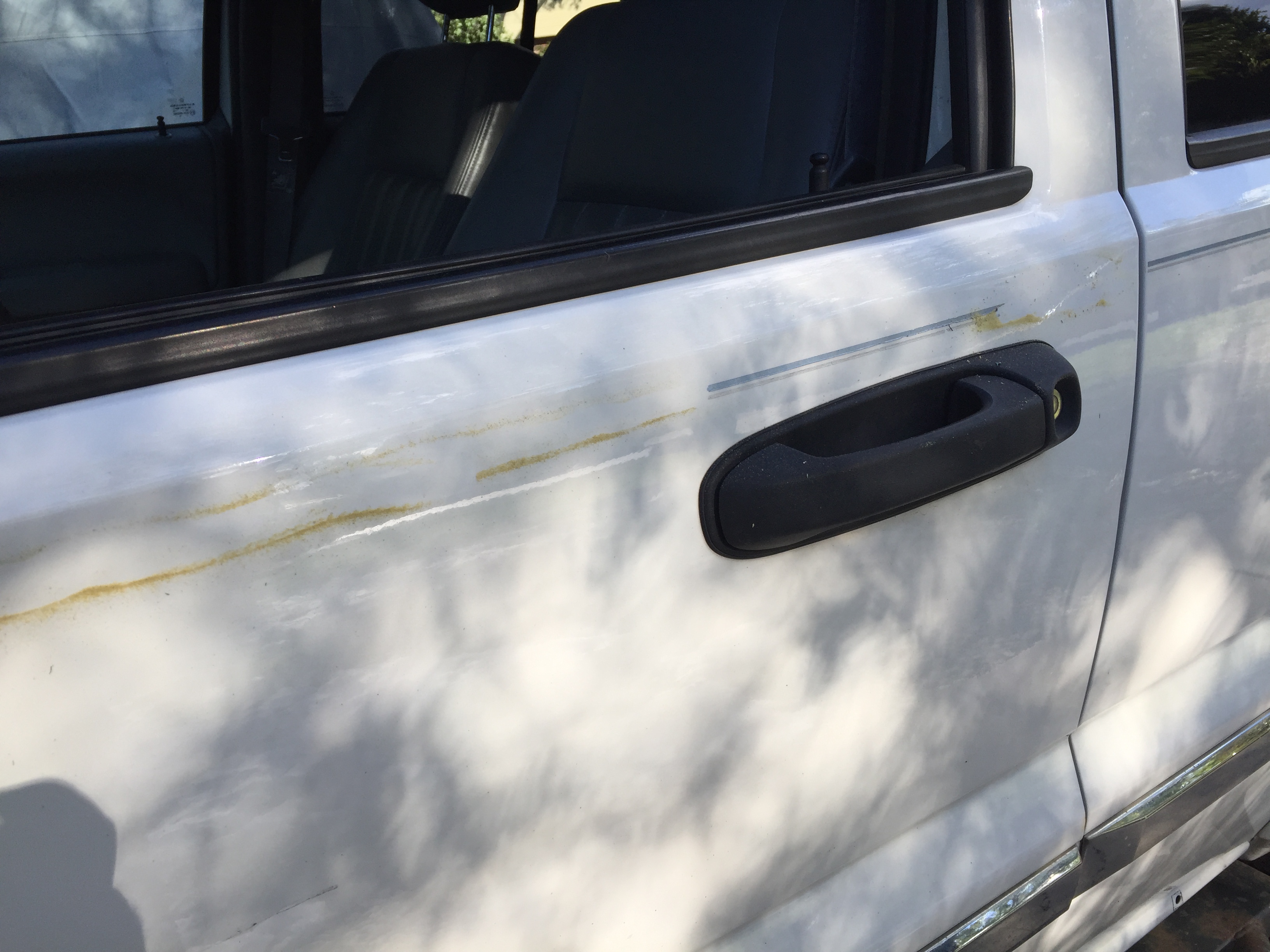

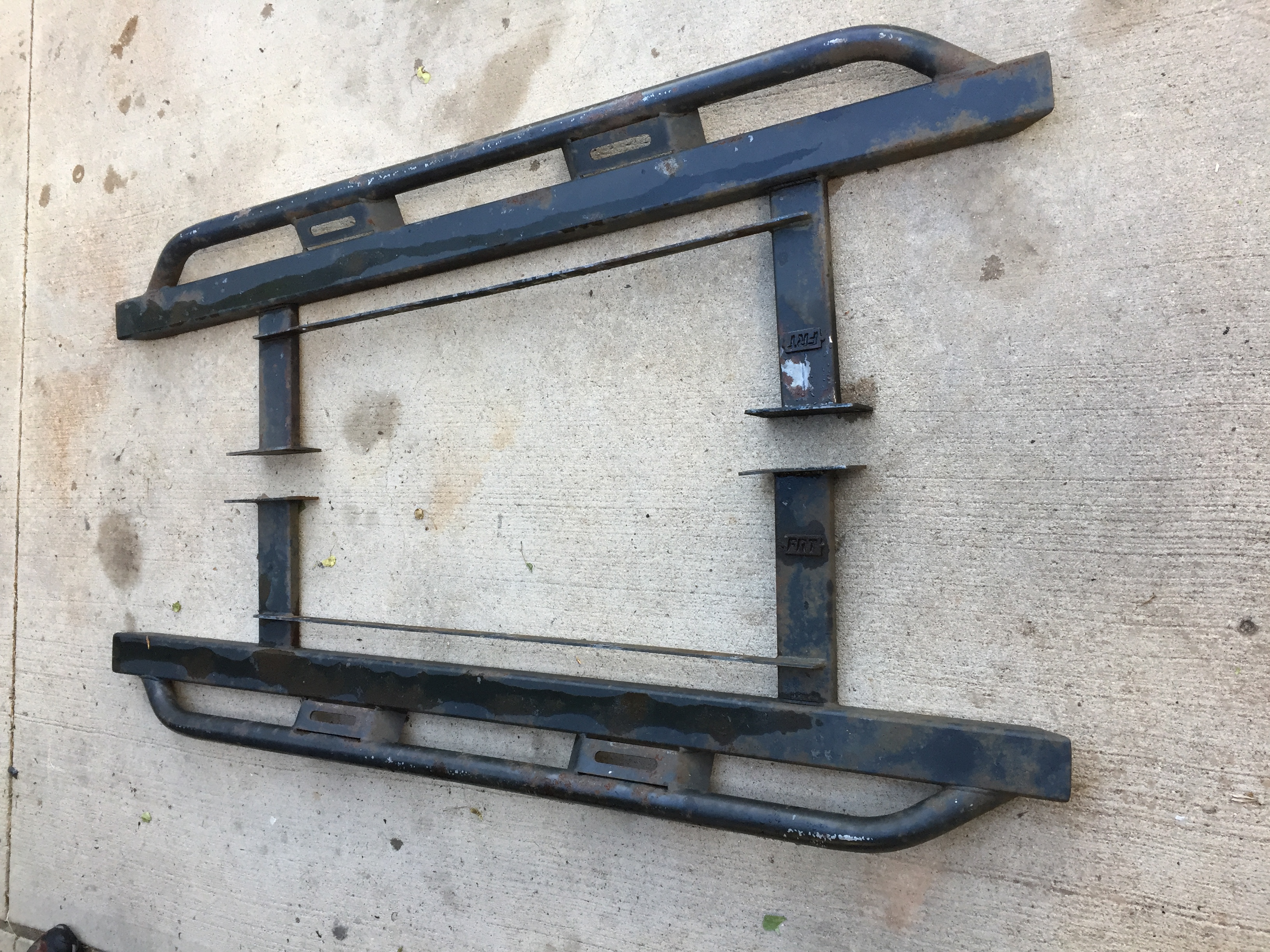

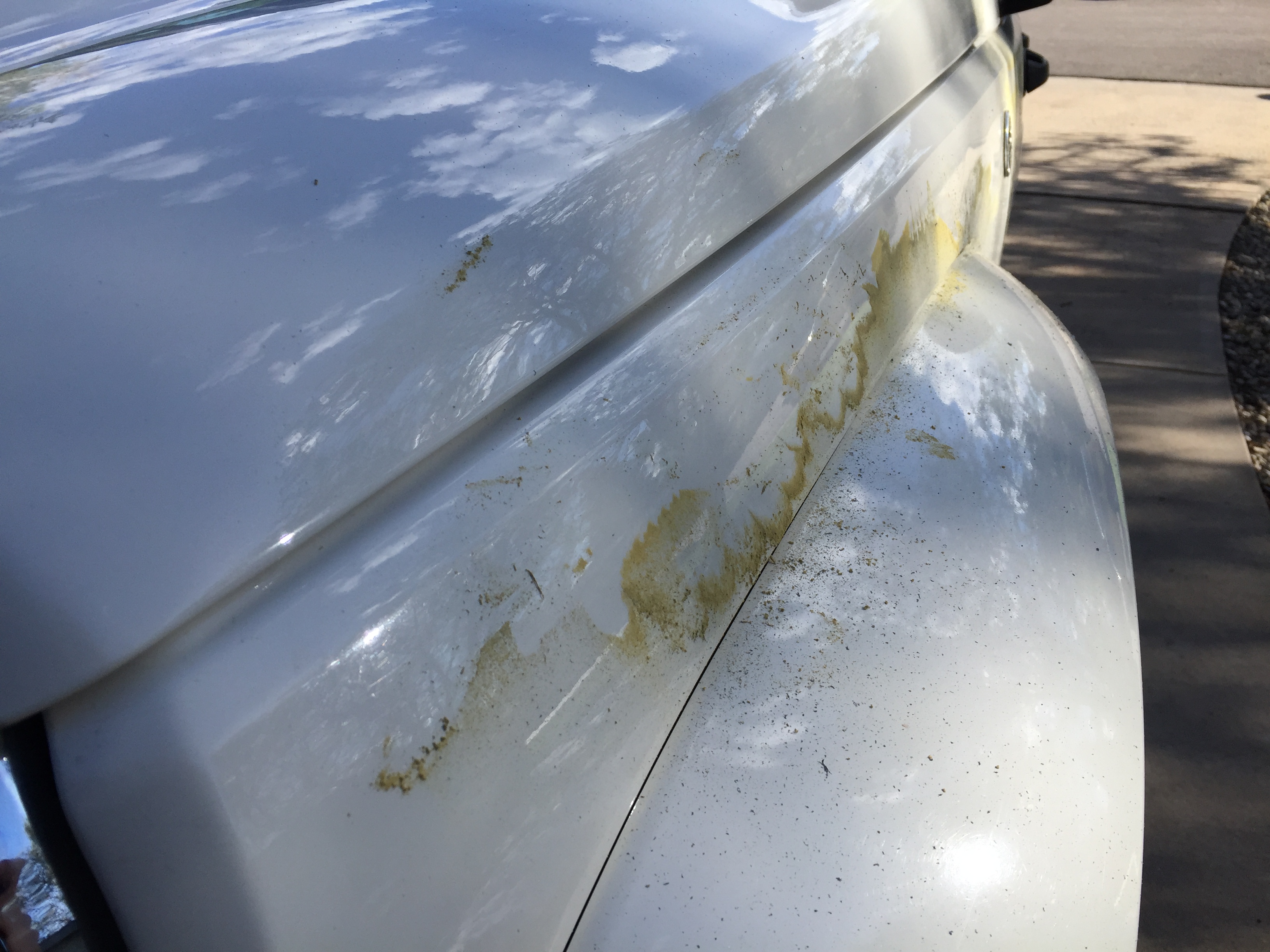

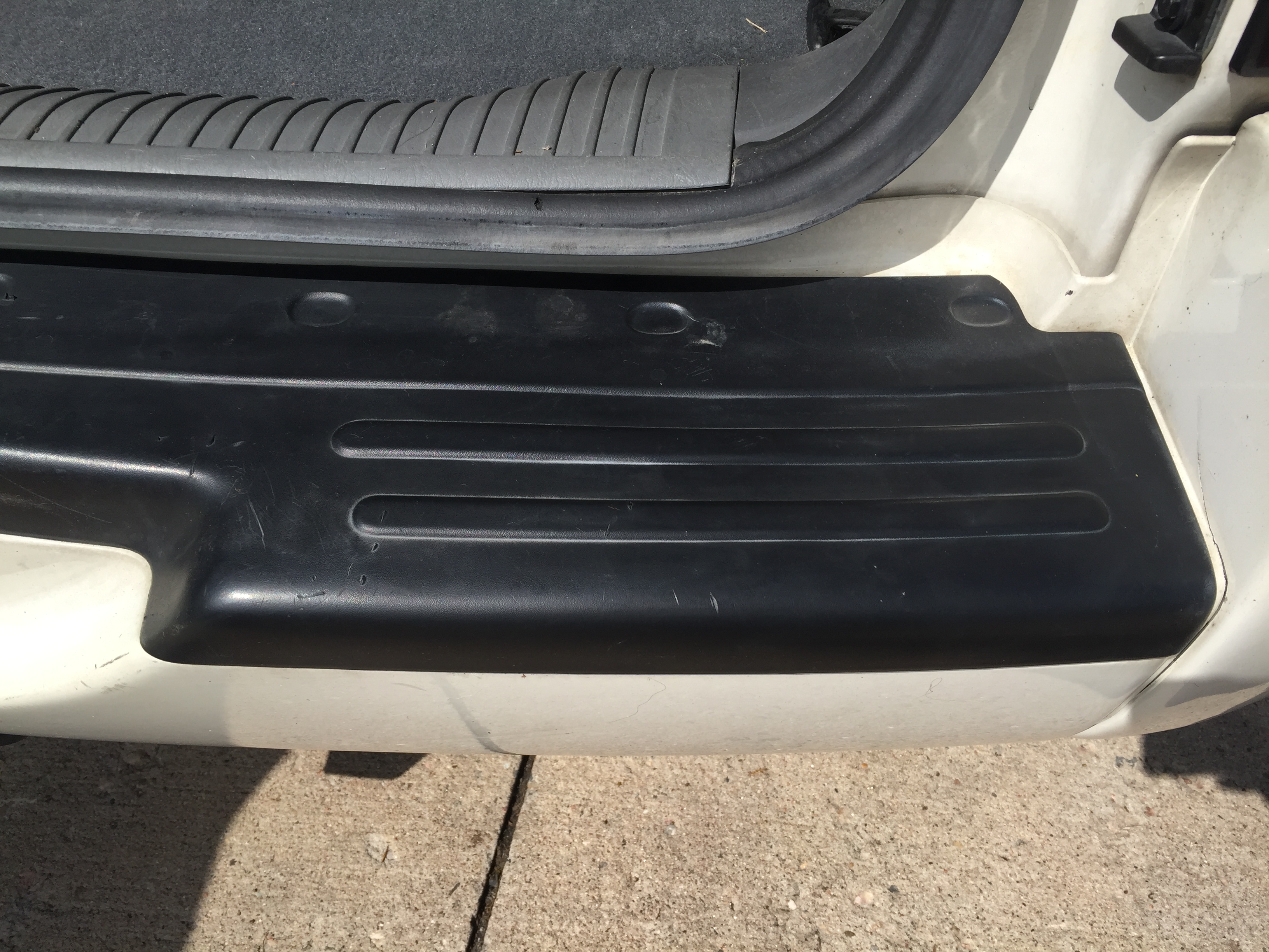

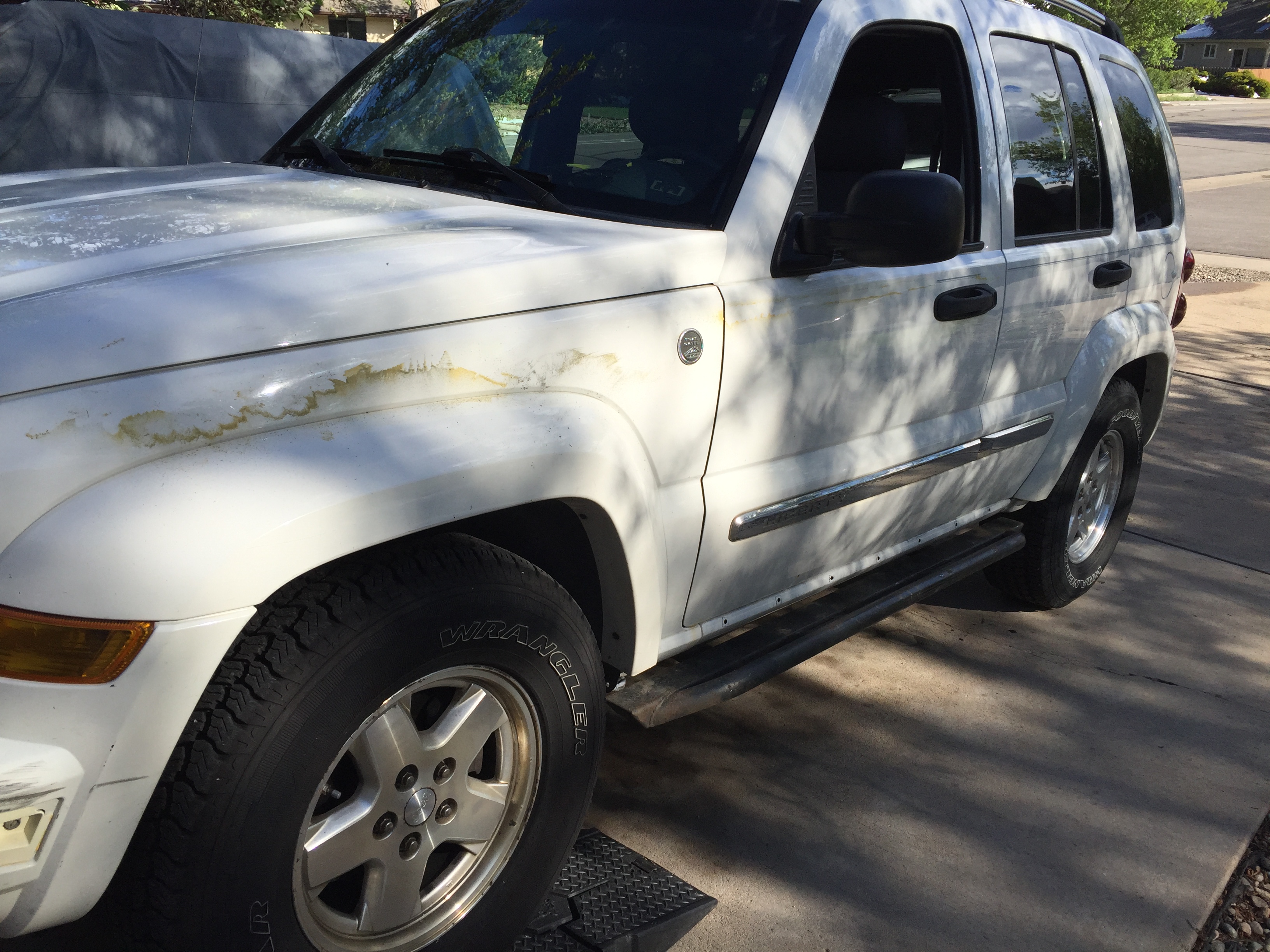

I used an eraser wheel to remove the pinstriping that was pretty rough looking. Also used a heat gun to darken some faded plastic. Took off the rock rails to use em on my KJ CRD.
Eraser wheel making short work of pinstrip:
Much better!

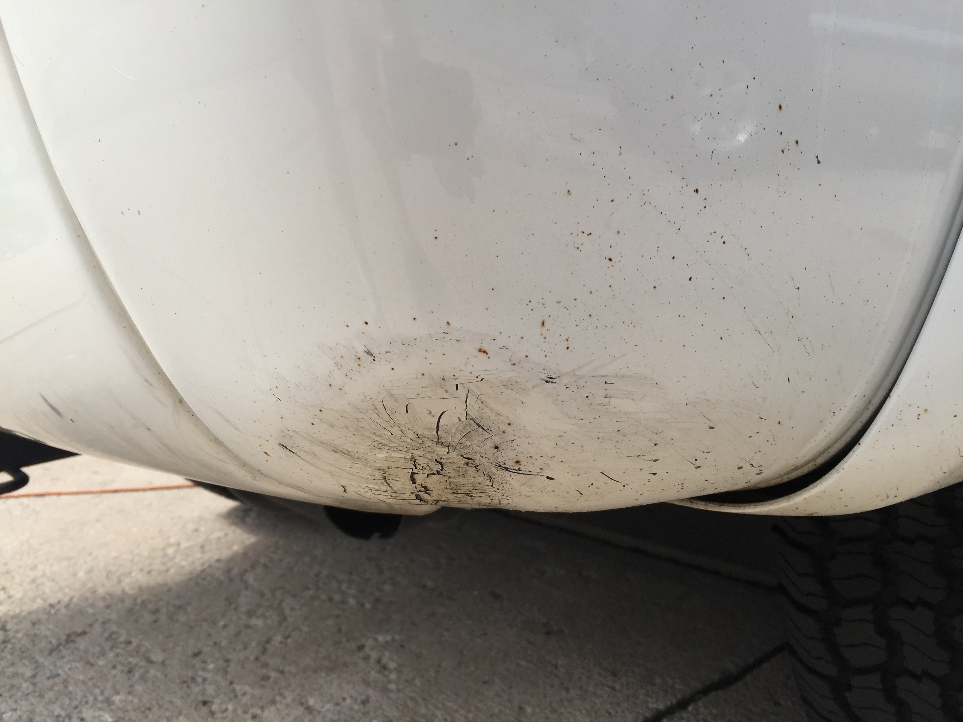

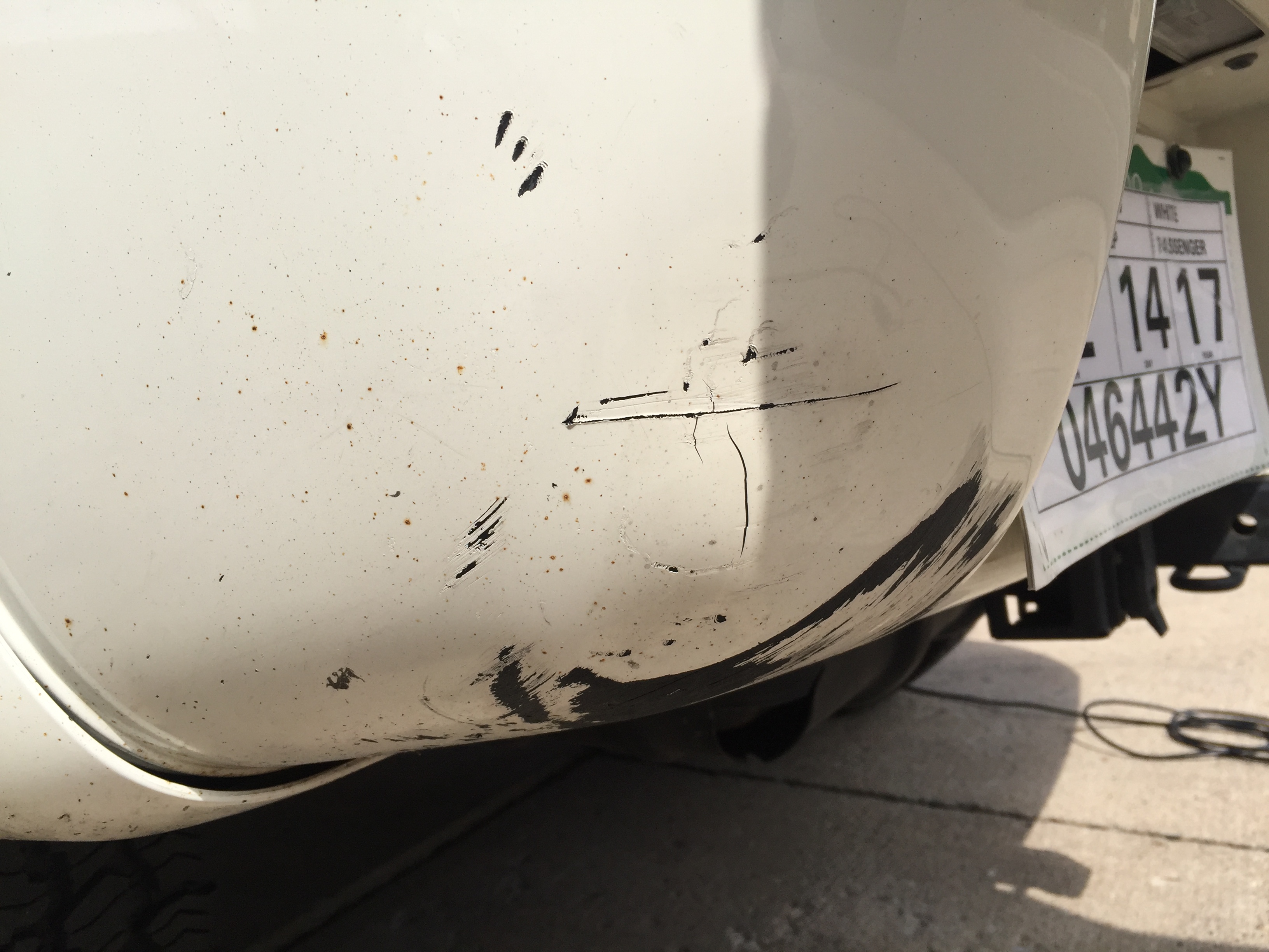

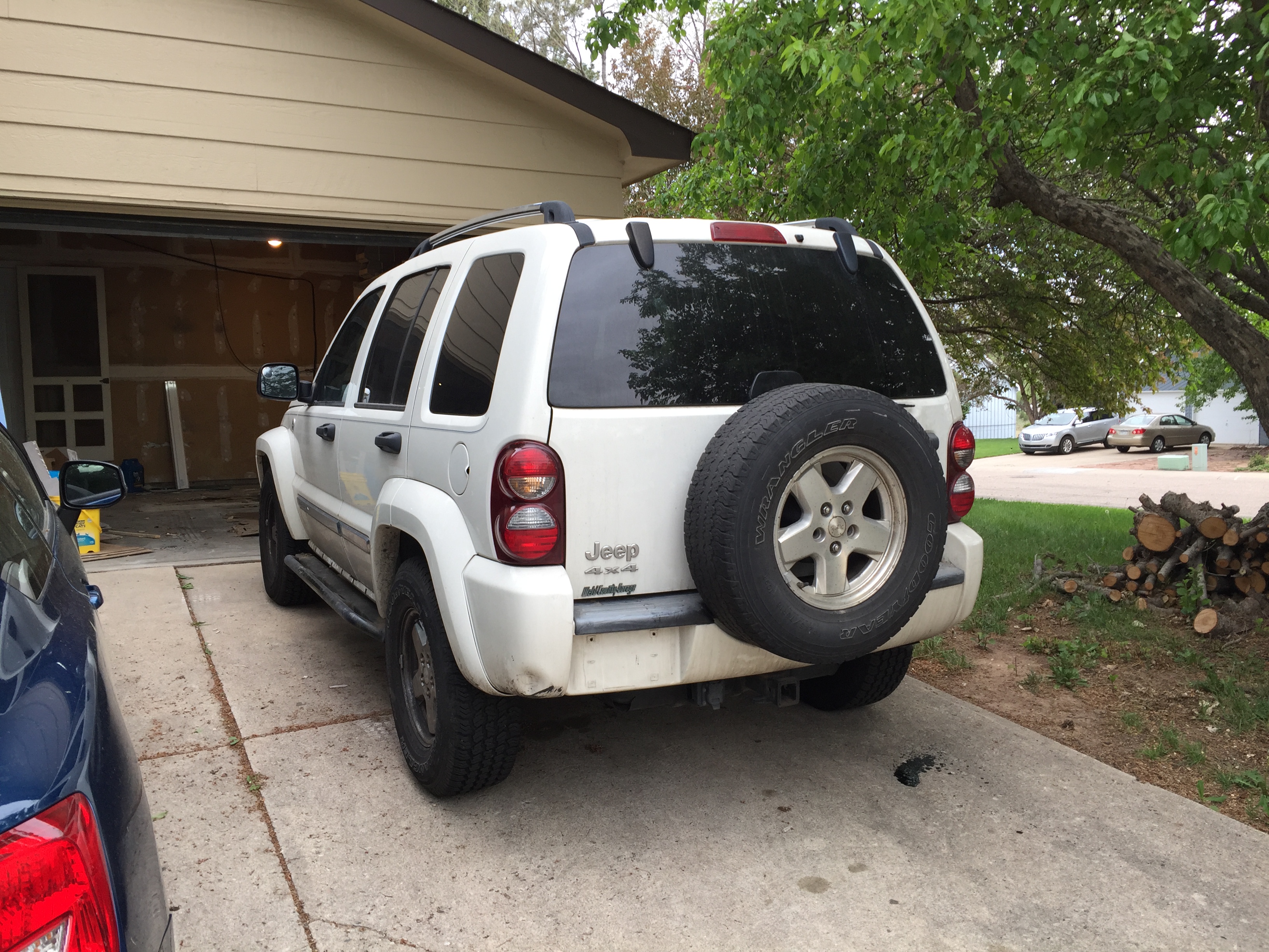

Cleaner, but each bumper has a dent in the corner, need to get the heat gun out for that.
Rock rails to go on my primary CRD:

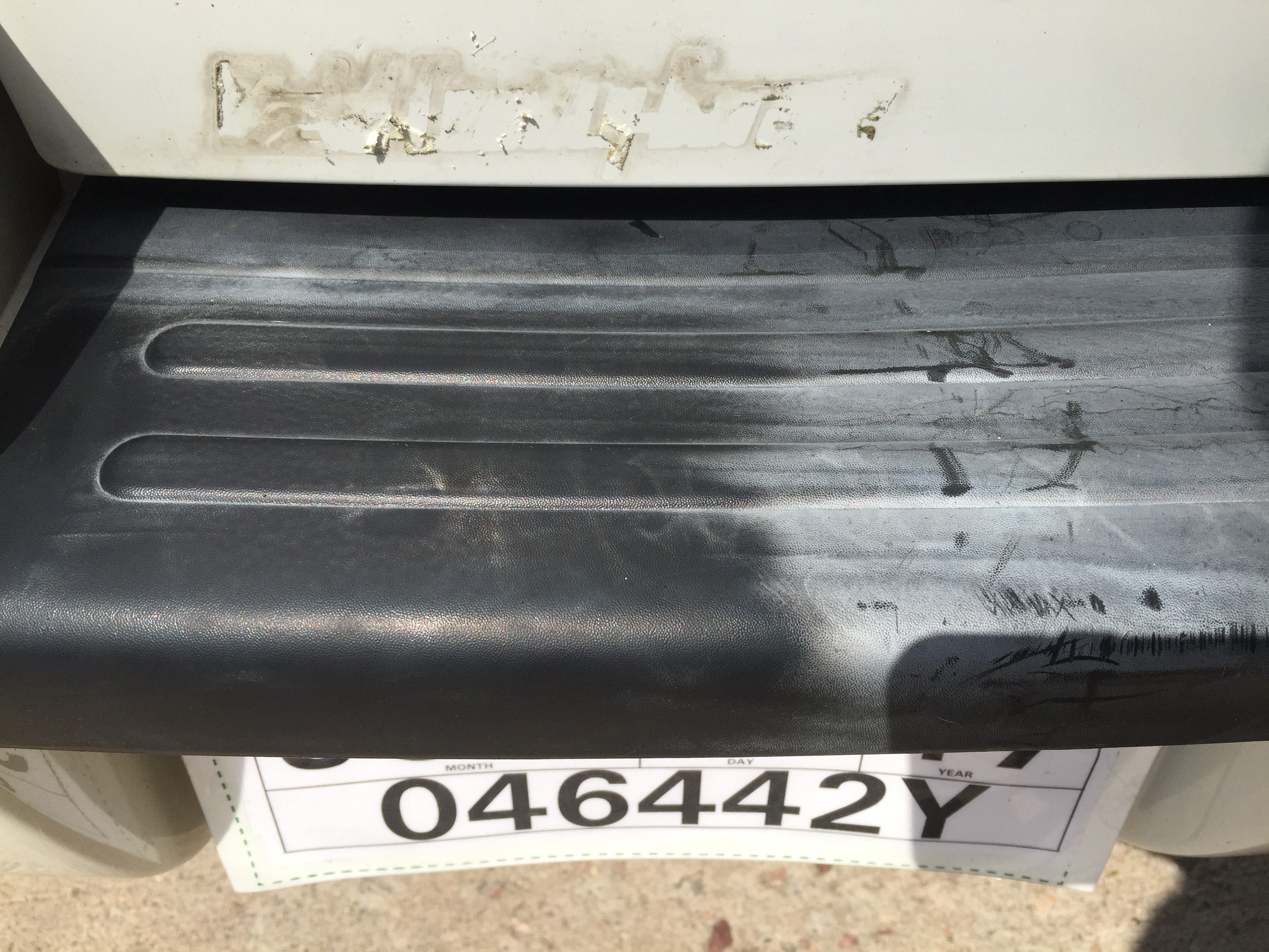

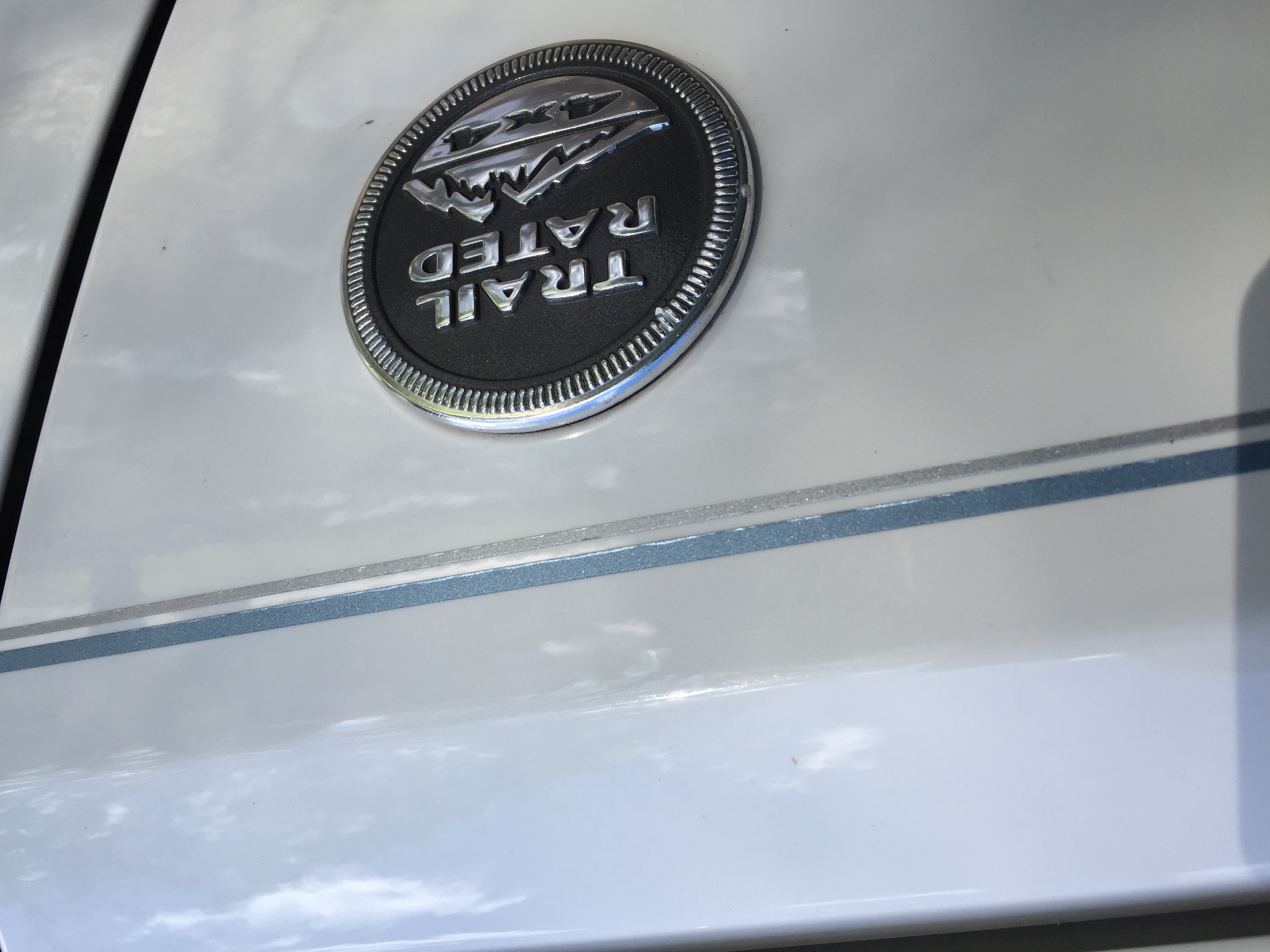

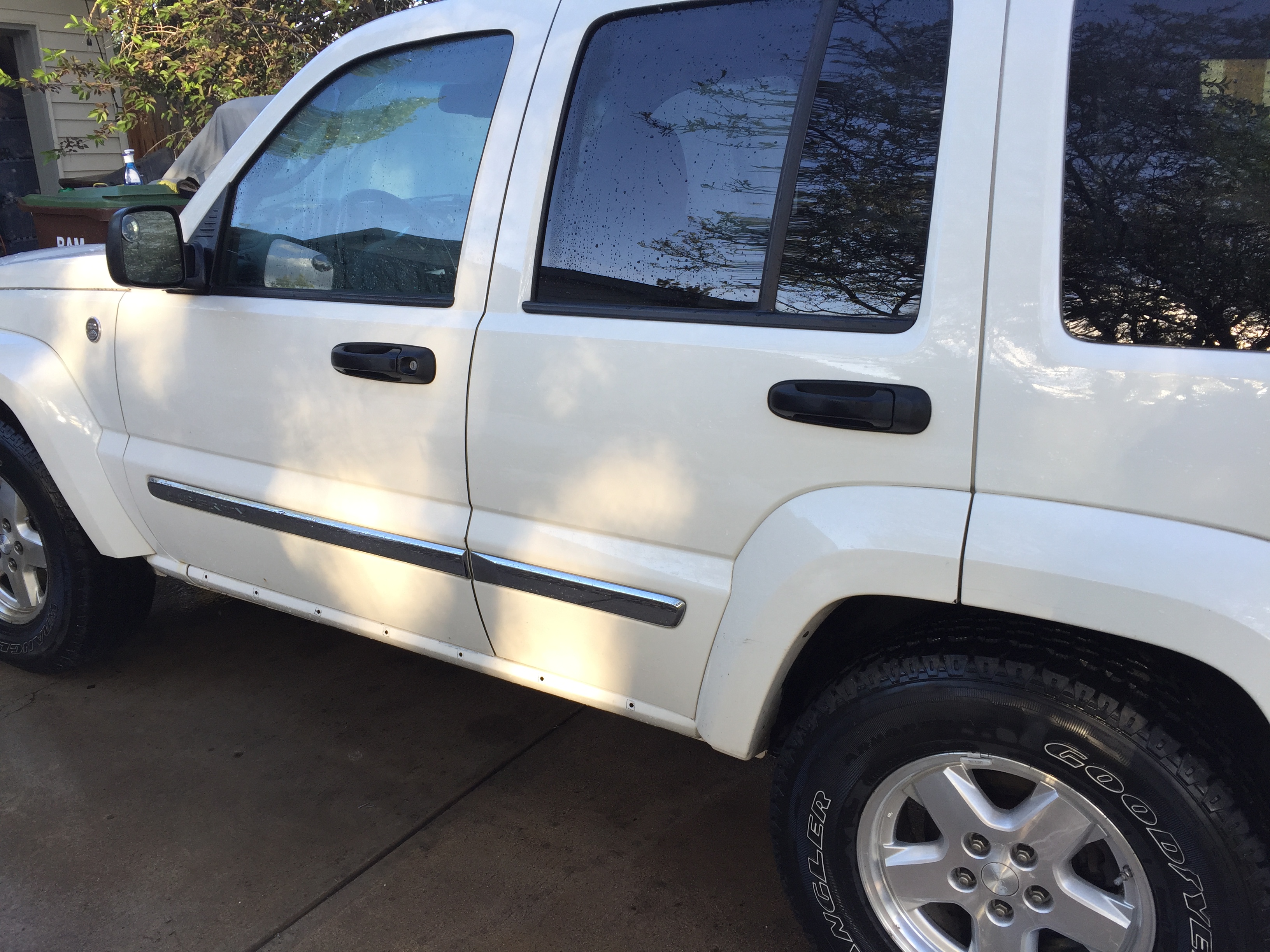

Got the crappy looking dealer emblem off, then used heat gun on the faded plastic. Took the eraser wheel to the glue remains to get it off.
Before:
After:

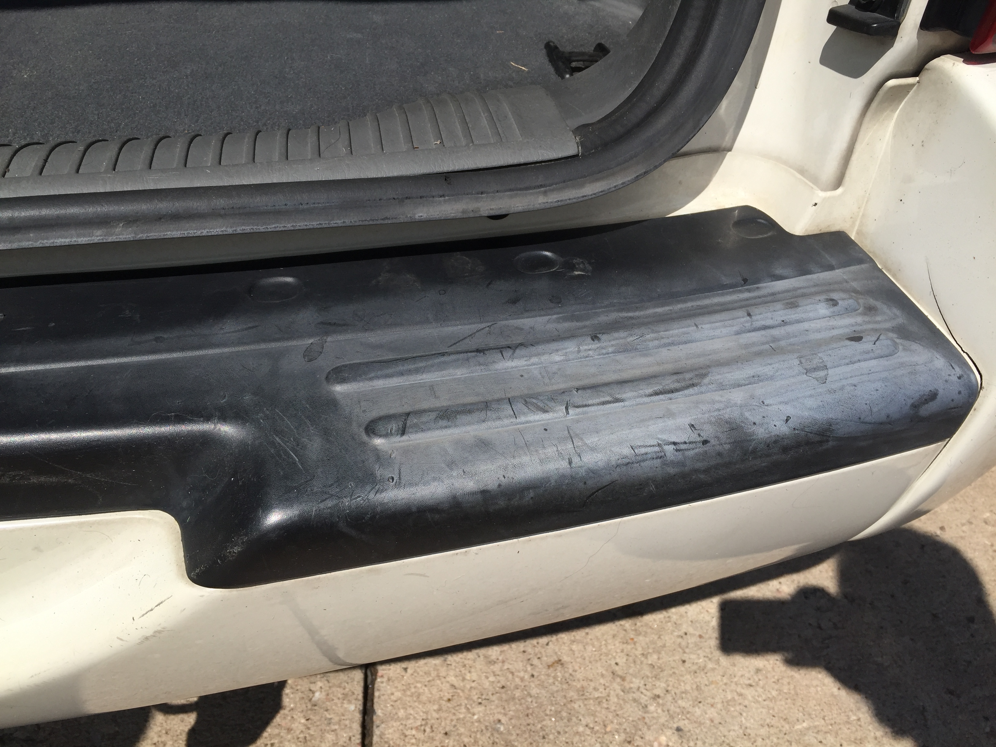

End of the bumper pushed out after heat gun and pressure from the inside:
Bumper is better, paint is still rough:
Other side: I wish I had gotten better close up photos to show the change, much improvement!

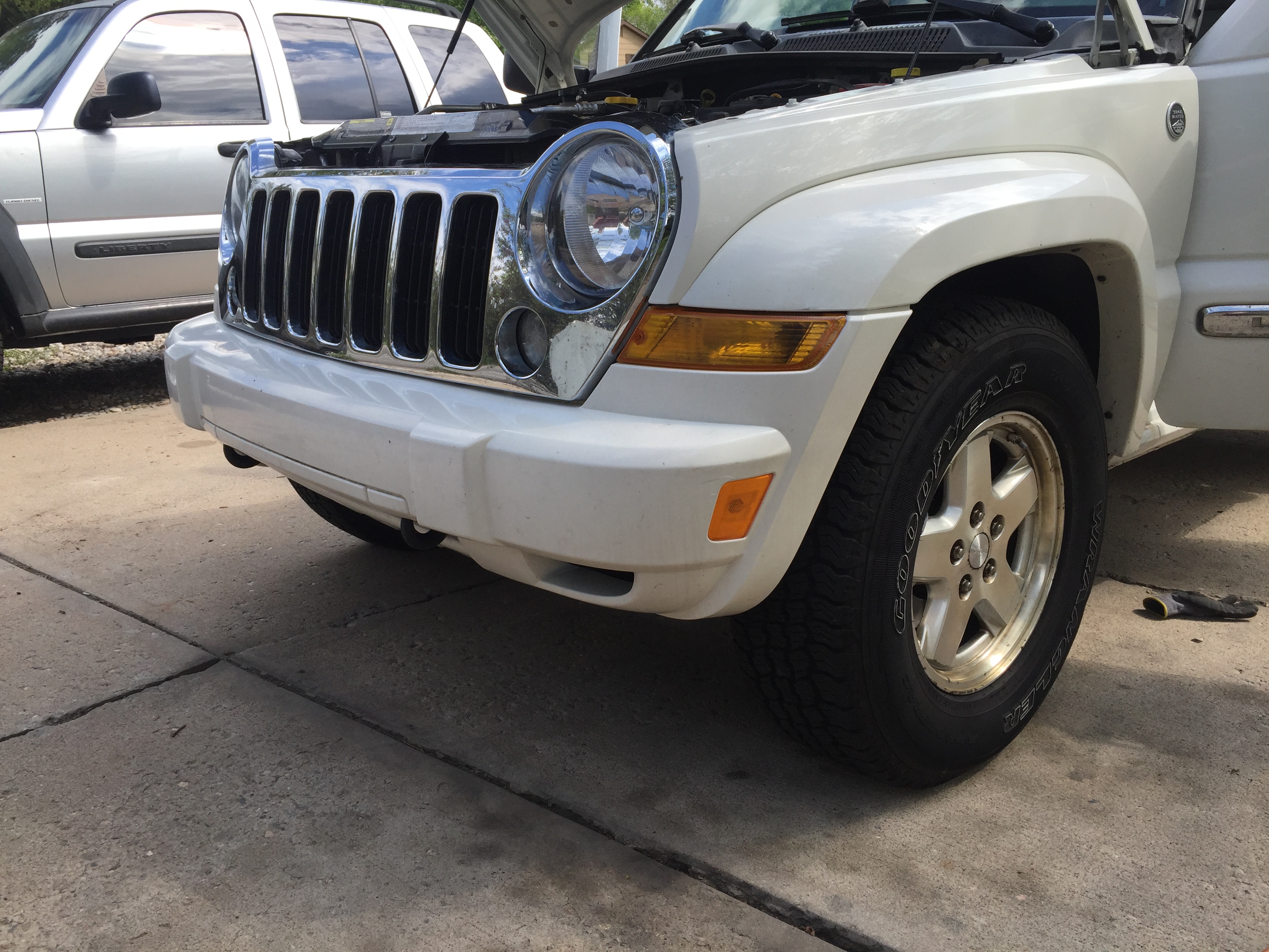

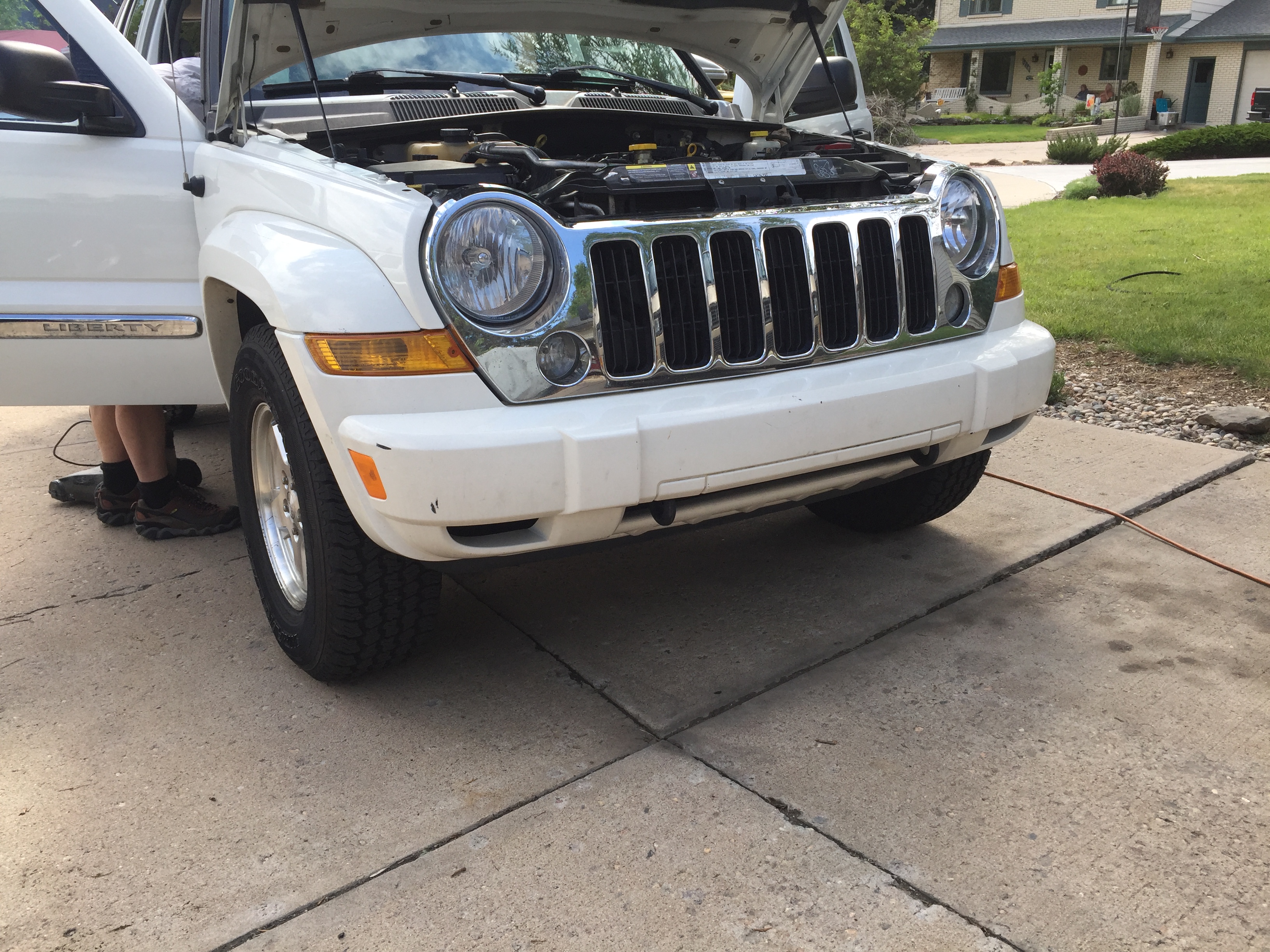

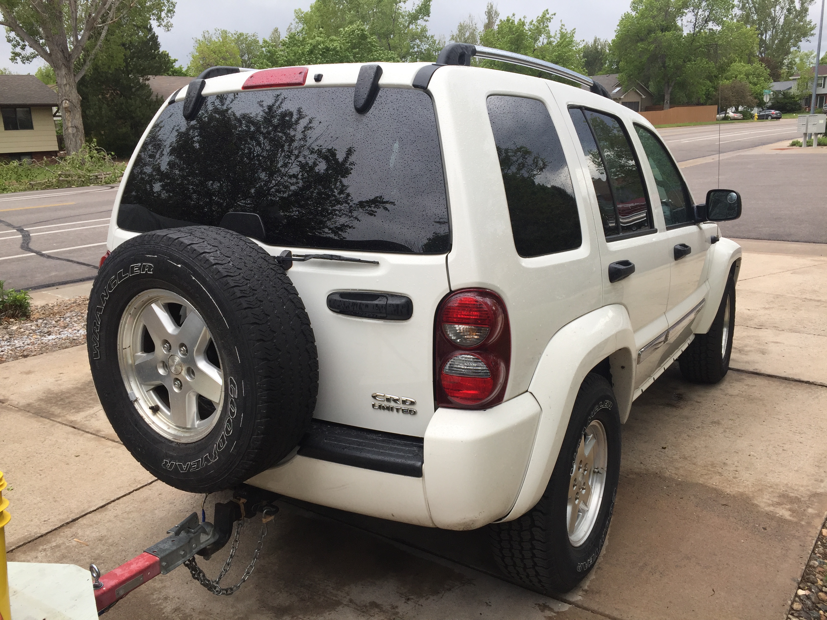

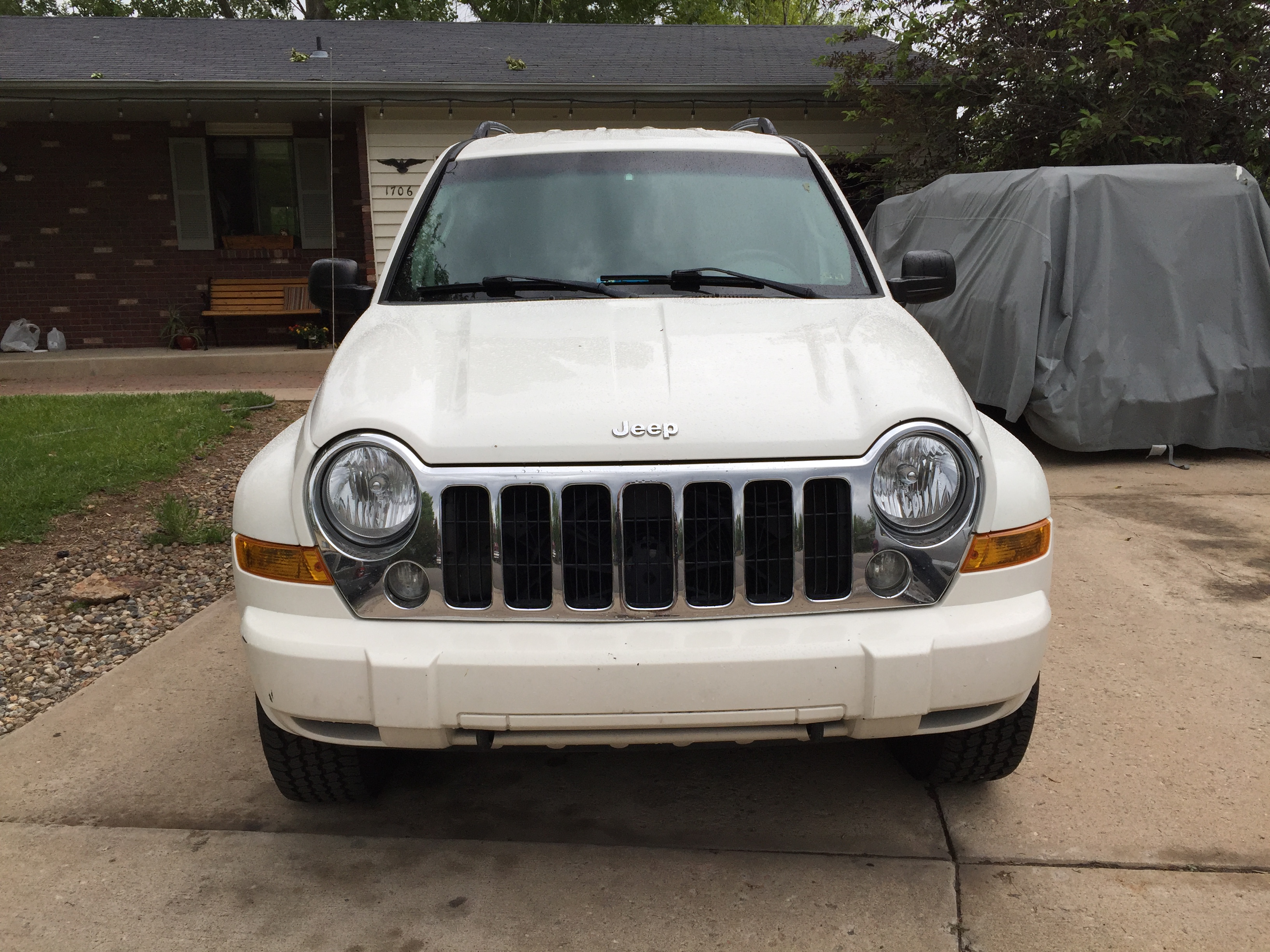

I also replaced the front bumper with one I had sitting around. It was white and undamaged other than a few scratches, the bumper that was on there had each corner torn up a little. So I finally got a chance to use that white bumper for a Jeep. Very lucky on that one.

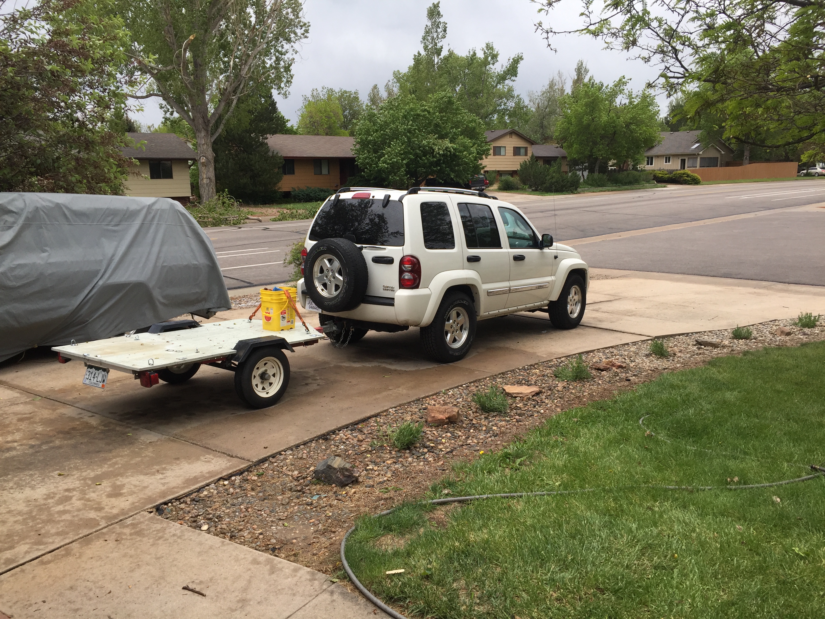

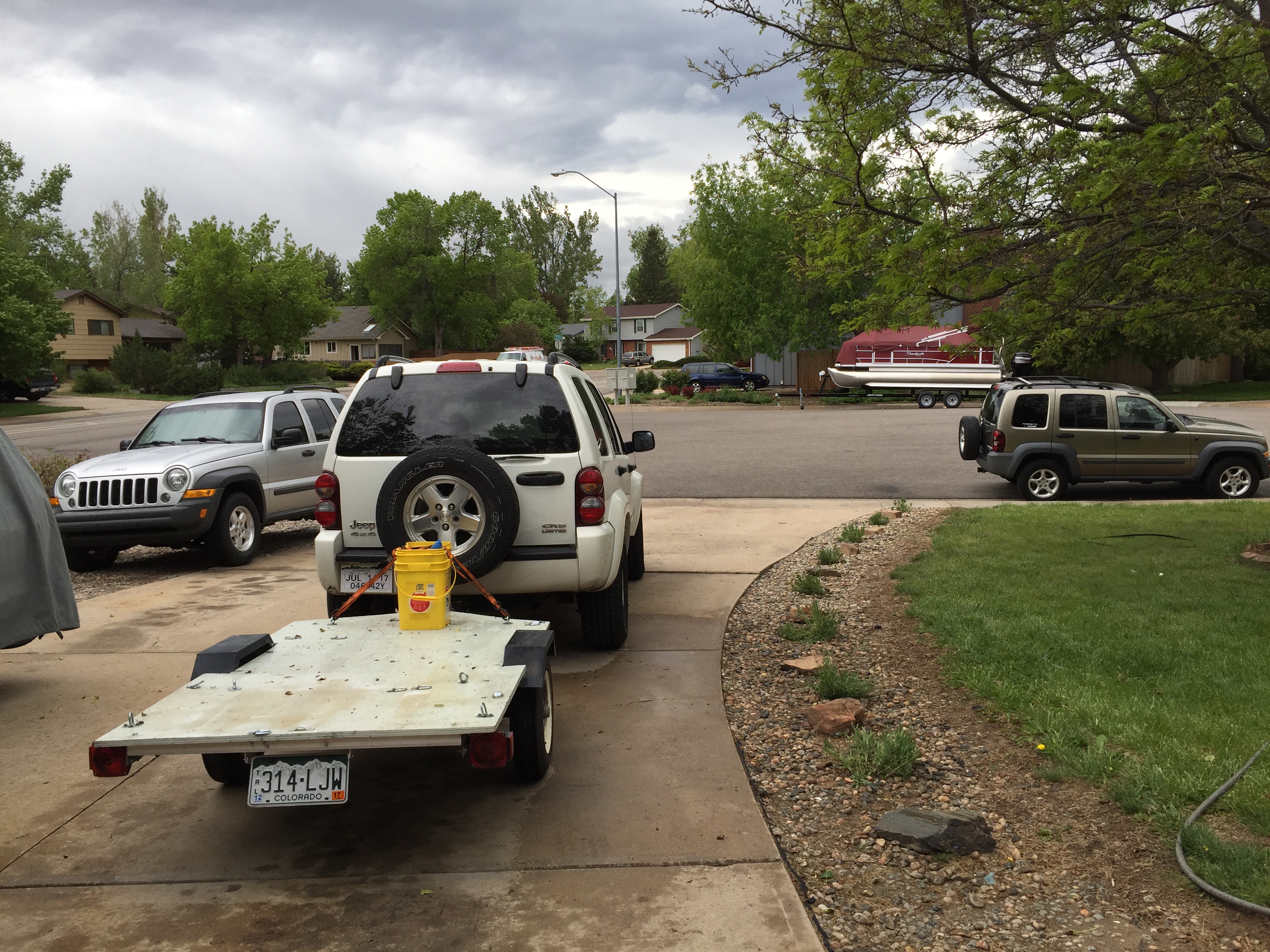

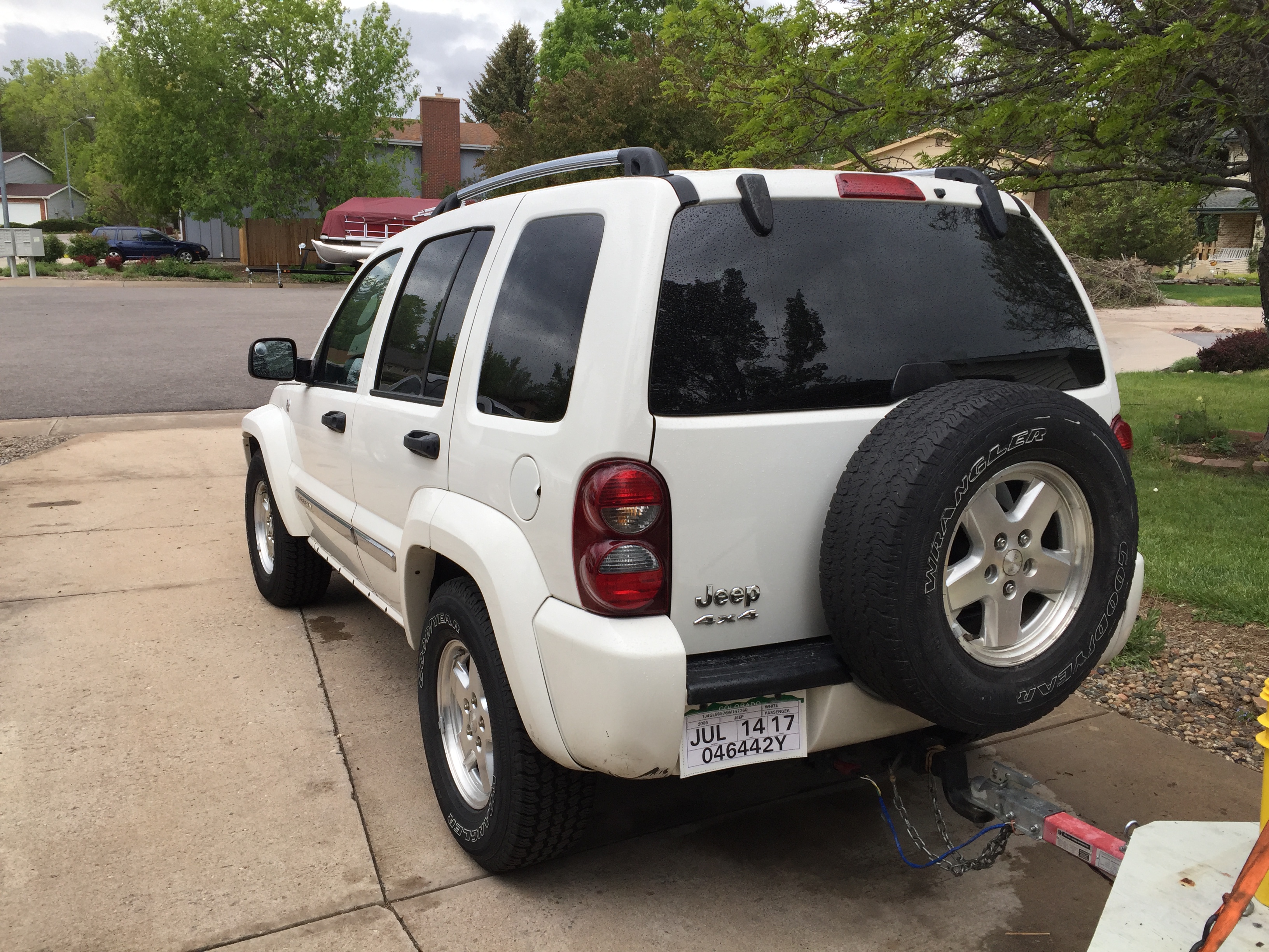

Trailer hooked up for drive back to socal.

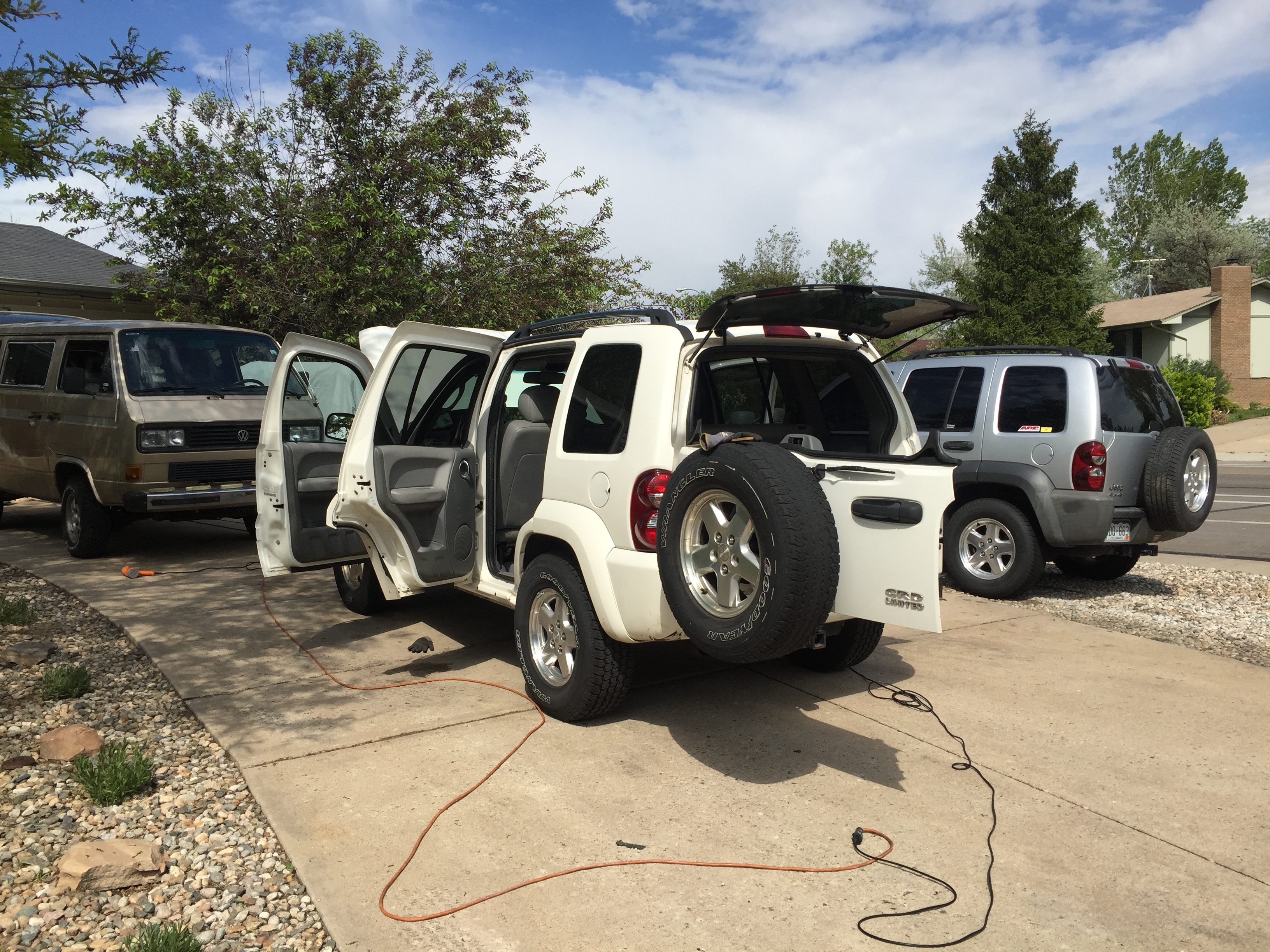

All three CRDs together, probably for the last time.
