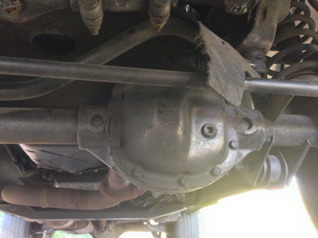

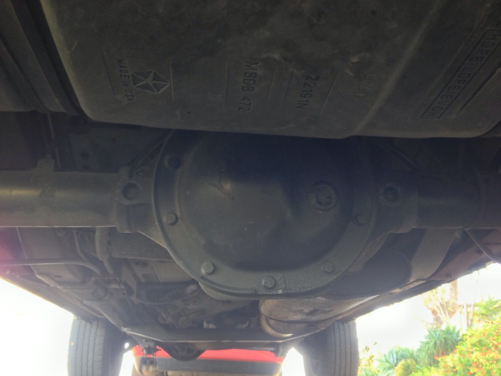

Axles: yup,.. C 8.25/D30.
On the '01 the -8.25 will be a 29 spline model. The "at-a-glance" givaway is the lobes sticking down below the cover on each side of the bottom center bolt. A D-35 doesn't have those.
