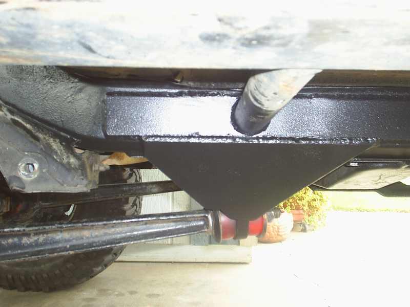

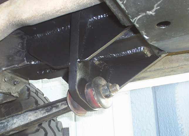

is that the stock coil bucket you used?? on mine it looks like you can just unbolt the radis arms and slide them and the buckets in an inch or 2..... how did you mount the radis arms to the frame....... is that the track bar off the front end????
  1. Stock lower coil buckets from the bronco
  5. The mounts are made from 3/4", 1/2 and 3/8 plate :wow: I hope it holds up :D
  6. We made the track bar.
  7. I'm going to run a wristed my radius arm.
