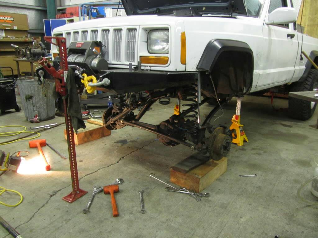

Hey Cody,
That's the plan. I would like to just have the crossmember/girdle whatever you'd like to call it. I have a new axle in the front, and need to push the axle forward in order to clear, and would have to make new control arms anyways. Do you have any pictures of your 3 link?
Thanks

Rock Krawler Mid Arm?
that seems to be the only one during install that I could find in the build thread. my passenger side rubber bushing has worn out, and I can't get ahold of rock krawler to find out what size/I'm to lazy to drop it and look. other than that no problems with it.
