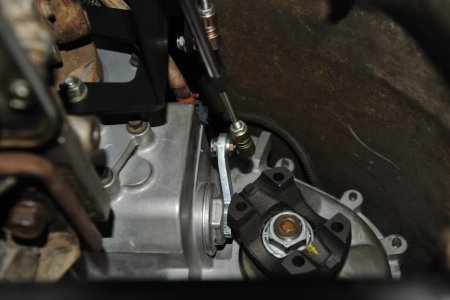

Well, push came to shove and I decided it was time to ditch the 242,
and upgrade to a different T-case. I wasnít interested in hacking up
my tunnel, or dropping more than $3000. With the help of DJ, I chose
the NVG241OR Rock-Trac from JB Conversions. After a lengthy E-mail
conversation (determining whether the case would have enough spline
engagement between the trans output and the T-case input,) I had one
brand new 241 with 1310 Yokes installed Front and Rear on its way via
Fed-ex freight to me for a little over $2100. By the way, the folks
over at JB are awesome. Customer service is great, and I couldnít
have asked for better service.

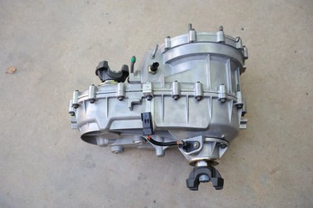

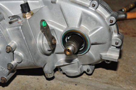

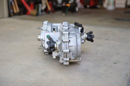

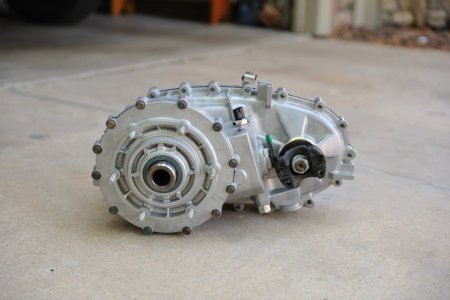

Few Pictures right out of the box:
oOoOohh Shiny

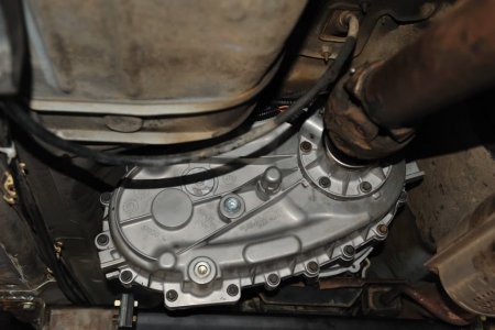

Anyway, I wanted to make sure I did this right. I didnít want to get
it up there, change my mind, and drop the case again. Ideally, lift
it once and keep it up there for a while. This T-case weighs right
around 100 lbs. Itís not easy when you donít have the appropriate

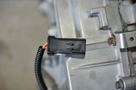

jack to hold it in place. My rig will be Daily Driven until I can
afford another mode of transportation. This means I want the Speedo

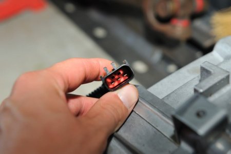

to work, and I want the 4 Wheel Drive Indicator Illumination to

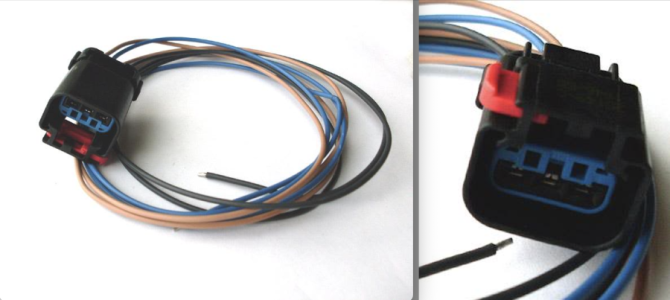

function properly as well. JB sells a wire/switch set to make the 4WD
Indicator to work. These pieces are customized for the 241OR
application.

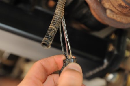

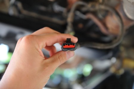

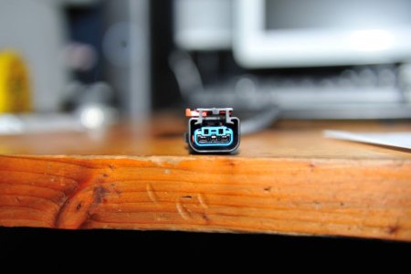

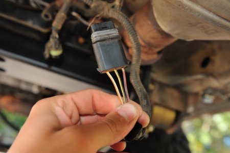

For reference Ė There are 3 wires (on NP242 models, 2 on NP231) coming
from the harness, to the connector.
Black/White Ė Full-Time signal
Black/Red Ė Part Time signal
Black Ė Ground Distribution
Word on the street is the 241OR has a bit of a sweet tooth, so I
picked up some liquid candy for it.
Now. A case thatís designed to handle to power output from a Cummins
Diesel Motor; Maximum Torque Capacity: 5,555 ft lbs vs. 1,885 ft lbs
with the NV231, and 1,486 ft lbs with the NV242(; 4:1 crawl ratio;
32 spline output shafts; and a direct bolt upÖ Could it get any
better? How about 4:1 2 Wheel Drive?

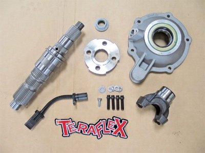

Yep. Teraflex now makes a 2-Low kit, for the TJ 241OR. That install
will be covered in the next reply.

I put one in my XJ a few months ago, they are nice units. I got mine rebuilt from Mantrans in Tallahassee. $850.00 bucks, and I picked it up. I dont understand how they can charge such a premium at JB? I got my yokes from Tom Woods for $180 bucks.
Your T-case looks reconditioned to me, not "new" from Jeep. It looks like the case was bead blasted (from the color, and the missing or bead blasted badge that's normally red), and probably rebuilt or at least gone through to make sure everything is up to par. Did they say it was "new"? I could be totally wrong, just curious.
The 2 wheel low kit is pretty cool, what was the cost on that?
One of the best/easiest (and cheapest if you look around) ways to get a string case, and 4:1! Bolts right in, although you will probably have to trim the transmission mount a little.
~James

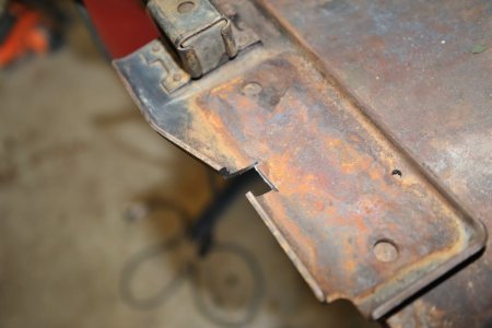

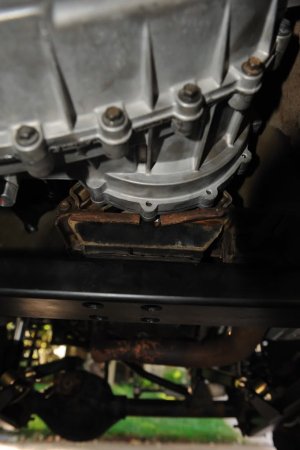

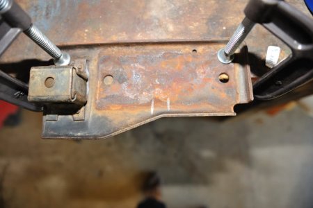

I've got Part 2 coming here in a little bit. Should answer a few of your questions. It's hard to tell if it truly was "new" or not. It sure had a brand new look to it. The inside of the case was spotless as well. I can't answer that for sure
The yokes from JB together, were only $120. $60 a yoke.
Tera 2-low ran a little more than $250. Also, I did have to trim the transmission mount slightly to get the T-case to fit. That'll come in Part 3
Scott
~James
They are brand new and do not come from Jeep.They are direct from New Venture!
Heres mine from 6yrs ago,notice the nice shiny sticker.
Lol...mine has a 'shiny' sticker as well, but it was reconditioned. I guess what struck me as odd on the OP's tcase was the lack of sticker, and the red model plate if it was being billed as new. Doesnt really make any difference in the long run if it works like it should, I was just curious. especially at the huge price difference from a good used unit.

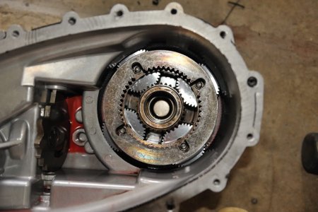

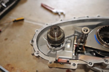

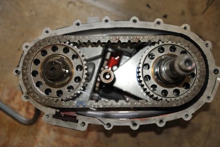

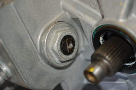

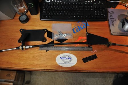

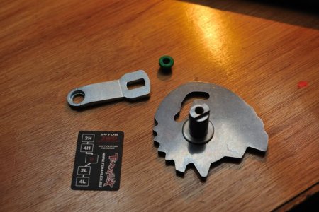

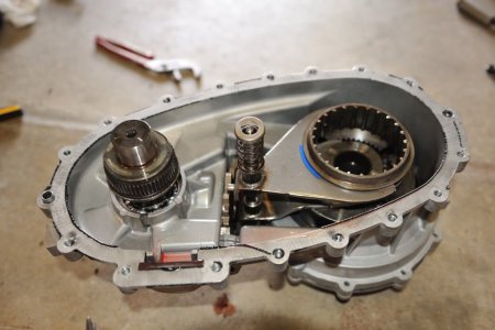

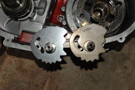

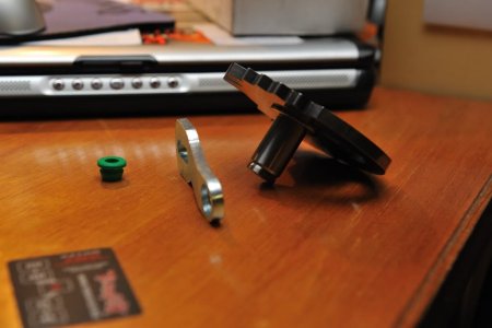

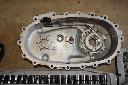

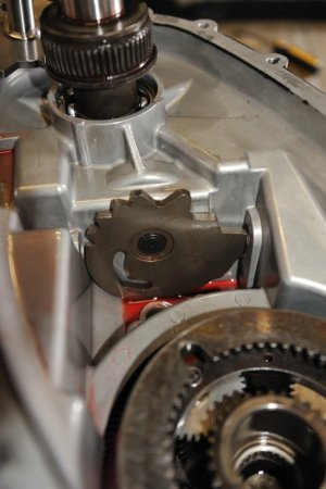

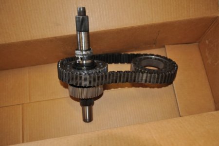

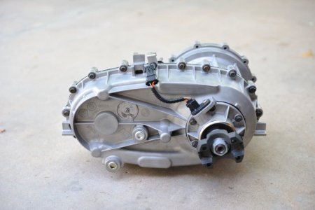

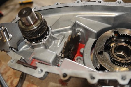

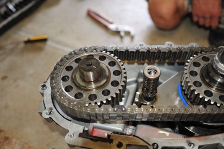

Part 2 Ė This will mainly involve installation of 2-Low into the case. Part 2 has to be split into two, I had too many pictures.
Alright. First off, I canít say I was hot on the idea of cracking open my brand new T-case and yanking everything out just to replace a small piece at the bottom. However, DJ badgered me into picking this piece up. $250 and 1 week later, I had a small white box waiting for me on a brown UPS truck. I work for UPS, so I can just jump on the truck before it leaves the hub and pickup my own stuff before 8am every morning.
Unfortunately, the only copy of installation instructions I could find were in reference to the JK Wrangler Rubicon. From what I was able to dig up, there are a few differences between the TJ Rubicon 241ís, and the JK Rubicon 241ís.

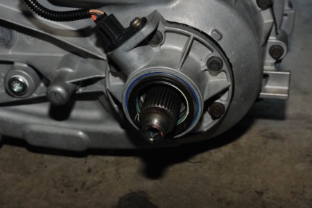

-Different bolt patterns holding the two case halves together
-The output / input shafts differ
-Speedometer housing / tailcone. TJ 241 has an electronic Speedometer in the tailcone, whereas the JK 241 has something else
Iím not exactly sure what the JK 241 uses to report speed to the computer, mostly because I donít have access to one. BlueGerbil Ė If you could chime in on this, maybe snap a picture or two, I would greatly appreciate it.
Moving on, Iíll attempt to document the procedure I followed, for future reference to anyone planning this modification. Iím going to assume the T-case is already removed from the vehicle, and comfortably resting on a work bench / garage floor.
-Mark front and rear yoke orientation, in relation to the output shafts.
-Remove front and rear yokes (or, if you have a T-case with a flange, remove flange).

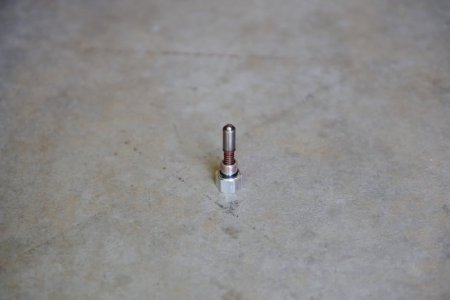

-Remove shift lever, detent plug (Assembled in 3 pieces Ė plug, spring and plunger), and Transfer Case Position Sensor.

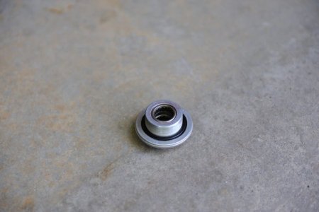

-Remove the support for the Shift lever. This houses the seal, and bearing for the Shift Sector.
-Mark orientation, remove tailcone / speedometer housing.
OK, this is where you have to be careful. Inside the speedo housing, there is a tone ring. This is what sends the pulsing signal, to make everything work. In order for it to catch on the output shaft, it sits on a retaining pin. This retaining pin also sits in a small hole on the output shaft. When you remove the tone ring, make sure you handle that retaining pin carefully. Otherwise, itíll fall out and you might never see it again.
I, like an idiot, forgot to take a picture of the tone ring and the inside of the speedo housing. It looks very similar to what's displayed in the image below (inbetween the mainshaft, and ESS speedo housing.

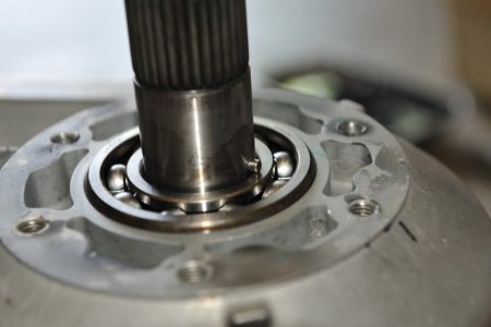

-Remove the 18 bolts holding the two case halves together, and pry apart.
-Donít mess with the oil pump on the rear half. Thereís a bolt holding it in place. You shouldnít need to mess with it anyway. Loosening the bolts will ruin your day. Everything is aligned together.
ContinuedÖ

-Remove the two lock rings located on top of the front and rear sprockets.
-As a whole, remove the sprockets and chain. I brought the output shaft with me when I pulled mine.
-Remove spring, and two retainers on top and bottom of spring. Remove shift rail. Remove output shaft mode fork and mode sleeve as a whole.

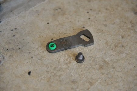

Hereís an image comparing the Teraflex 2-Low piece, to the factory piece. 2 Low is on the left, factory is on the right.
Install is the above steps, in reverse order. A few notes to take into consideration when re-assembling. It helps if you can shift the T-case into a 4WD setting. This will raise the output shaft slightly towards the rear of the case, thus making it easier to insert that retaining pin back in. When you do put the rear half back on, the output shaft has to fit through the splines on the oil pump. I had to pull and turn on the output shaft to accomplish this. This will raise the shaft the remaining length, so you can insert the retaining pin back in.
That should cover most of the Teraflex 2-Low install. I let my case sit for 24 hours or so, to allow the sealant to dry. Iíll post up Part 3 either later today, or tomorrow at some point.
