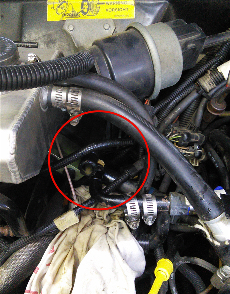

I have a 1990 XJ RENIX that I am starting the process to flush the heater core. It has never been done on this vehicle and I have never done the job before myself.
Initial steps to get the hoses off from the heater core inlet and outlets is choosing to be difficult (why not, it's almost 30 years old). The top inlet has a 6" section of hose joining the inlet to the "T" section. I'm able to get the hose off from the "T" section side but not from the heater core side. Should I just cut it off? I have fresh 5/8" and 3/4" heater hose at hand.
The bottom outlet is similar but the hose has about a 45 degree bend in it. Is this special and can I just use a straight piece of hose if I have to cut that one as well?

I went to RockAuto to confirm the hoses. It looks like the "Heater To Valve", 6" outlet hose is special and does have a 90 degree bend. The "Heater To Tee" inlet hose; 5", is a straight 5/8" and no problem.
So ... cutting the "Heater To Tee" inlet hose would be OK and easily replaced. The "Heater To Valve" does have a bend and would have to be ordered if I have to cut it out. Any tips on how to remove heater hoses from the heater core without damaging them?

Cut the heater hose with a razor/box cutter...lengthwise...at the core nipples and peel them off. Of course you'll need to move all that to get to them.

I never could find any thing on rock auto for the heater core Renix hoses?
the T-valve and T are 5/8" OD, the heater core is 3/4" OD so both hoses are different IDs on the ends. I thought both were straight, but my 87, which I think had no valve may be different than the 89-90 with the valve on the heater hose straight versus 90*
I will check tomorrow for you. I have seen the 90* hoses listed, but thought it was a common data base error. I bought the straight hoses this week, 5/8" x 3/4", for the one that has a valve in it.
90* hose

Neither are listed as fitting the 87????? Hmm.
Hmm, I need to recheck the one I am about to restore, it may need the 90* hose too, but is two different IDs or what? I know the straight one os 3/4 x 5/8, so I figured the heater core was 3/4 on both inlet and outlet?

The straight is not 5/8", it is 3/4 x 5/8!!!!

Thanks for your feedback. To confirm, 3/4 on one side, 5/8 on the other? 3/4 is the diameter on both heater core outlets? I thought the one side I was able to pull did look 5/8 (inlet, T side). RockAuto shows 5/8 on both ends for the straight and 5/8 on both ends for the outlet hose with the bend.
Regarding the "special" 90 degree bend hose for the outlet, I found other threads here discussing the removal of the Heater control Valve;

Well I may have just learned something more, the images at this link
http://www.partsgeek.com/catalog/198...ater_core.html
show the heater core as two different OD tubes on it for 1989. Perhaps to make sure ya-whos do not connect them backwards?
So I guess the 90* tube is just a common 5/8" ID 90* tube that fits hundreds of rigs? All the local parts store should one in their misc rack in the back.
So I do not seem to need a second miss match, 5/8 x 3/4" hose after all. But I may need a 90*, 5/8"....
Pretty sure you will want that 3/4" x 5/8" straight bastard hose those. Trying to clamp a 3/4 onto 5/8s and get it to seal is not worth the risk, and stretching 5/8 on to 3/4 may damage the old heater core
With a little luck we should have this scoped out shortly for both of us.
When I did mine, I stretched out a 5/8 with some heat and banging a socket in the end. I'm running a 92 radiator with a real radiator cap in my 89, so the heater hoses just run forward without needing the pressure bottle, funky T-fitting or crappy plastic vacuum valve. Between doing that and back flushing the core, I have fantastic heat in the winter.

What started out as a simple remove hoses, flush heater core and reconnect hoses is turning out to be a minor Gong show.
The partsgeek site shows a different part # for the 1990 but the picture is the same with 5/8 (top) and 3/4 (bottom) inlets.
RockAuto show this to be true. I'm still pondering whether to delete the heater control valve and avoid this tube.
I think that hose is correct and the heater core pictures from partsgeek are in question. My inspection today seemed to confirm this "bastard" hose is the one to get. During my inspection today it also looked like the "bastard" hose was used with a 3/4 inlet port on my heater core (I'll have to check on this). I'm thinking my heater core has both ports at 3/4.
BTW, could you please explain how "stretching 5/8 on to 3/4 may damage the old heater core"?

Not sure I buy the fluid dynamics explanation. You don't see that on the radiator or most commercial heat exchangers. I always assumed the size difference was to ensure supply and return didn't get mixed up, which would cause air to get trapped in the core. Fill from the bottom so air gets pushed out the top.
I think he meant you might damage the tube while struggling to force the undersized hose on it.

Forcing the wrong size hose on an old weak, thin wall copper tube may damage the tube.
