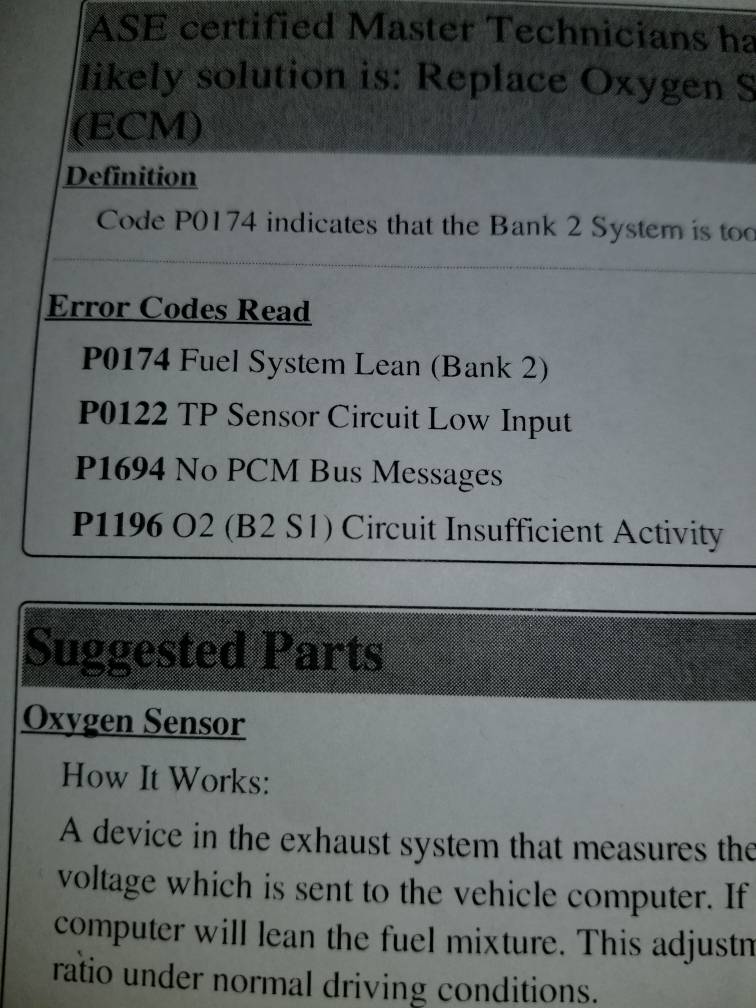

So I know that there is a dozen posts that are similar, but hear me out.
So I've had a dozen codes ever since I replaced the engine, but since I still was getting 14-15 mpg I wasn't too worried. Well I stopped at the carhart store the jeep was running normal came back out and the jeep wouldn't start, turn the ignition, and the gauges don't test, jeep will not crank over, and after 30 seconds to a minute no bus is displayed. I tried unplugging every sensor one at a time cps, tps, cam sensor, temp, ect. And nothing made any difference. I borrowed a multi metre from a co-worker and was trying to test the pcm, but I don't have a fsm to figure out what should read what.
My culprit is the pcm but just having started a new job on Monday money is tight for this week, so i can't just throw parts at it hoping it will fix itself. If it helps pin 22 on the black connector had 12v pin 2 had none pin 1 had none, the grounding pins had good continuity and I can't remember if pin 17 had 5v I believe it did but I don't remember.
I've got a picture of that list of codes if you guys want to take a look

https://photos.app.goo.gl/xy7soPeAeWFBeDWh1
In case you can't see the photo this is what I had for codes after towing a uhaul trailer from VA to ME maybe this will give a clue to to my current problem.
P0174 Fuel system lean (bank 2)
P0123 TP sensor circuit high input
P0118 ECT Sensor High input
P0108 MAP sensor high input
P0113 IAT sensor high input
P0204 injector circut/open cylinder 4
P0300 multiple cylinder misfire detected
P0301 cylinder 1-10 misfire detected
P0302 cylinder 1-10 misfire detected
P0303 cylinder 1-10 misfire detected
P0455 EVAP Large leak (0.80") detected (There when we bought the jeep)
P0151 O2 (B2 S1) Circut Short to ground
P0122 TP Sensor Circut Low input
P1694 No PCM Bus messages
I had the majority of these codes once I got up to PA from VA I then replaced the number 2 injector (it was leaking) the TP sensor and the front lower 02 sensor, reset the codes and this is what came back.
I didn't test the cps because it didn't make any difference when I unplugged the cps and turned on the ignition.
As for not crank the starter doesn't turn over, fuel pump doesn't kick on. I checked all fuses swapped out relays with no change.
Before anyone asks the battery is fine, first thing I checked.
