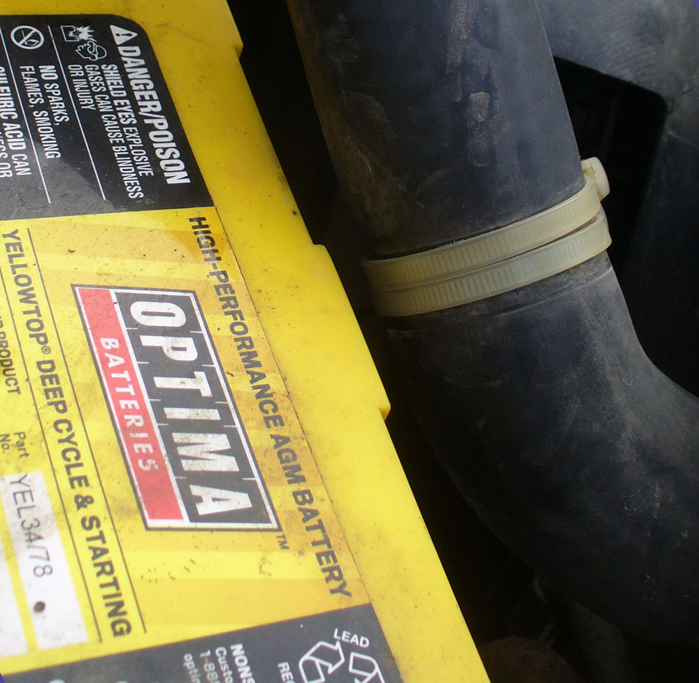

First question, how much clearance is there above the battery? I swiped a lump of Play Dough from The Varmints and ran a squish check. I have easily 1 ½” of clearance above the negative terminal, and even more above the positive:

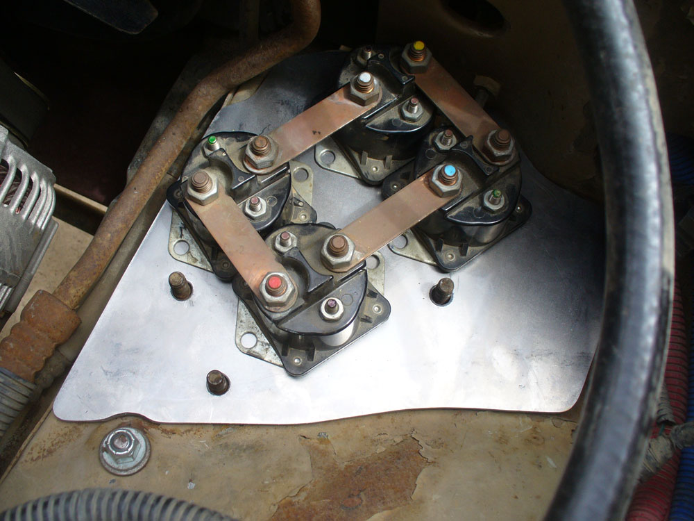

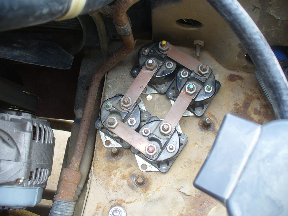

Then I finally got some time to tear into this task in earnest. I pulled out the existing tray and played around with options for locating the relays. I was expecting that I would have to replace some of Warn’s copper straps in order to position things so they would all fit, but I found a spot where they all fit as already configured (Yes, I know, that picture shows them too close to that one stud. The clearance exists with proper positioning.).

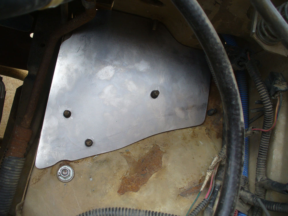

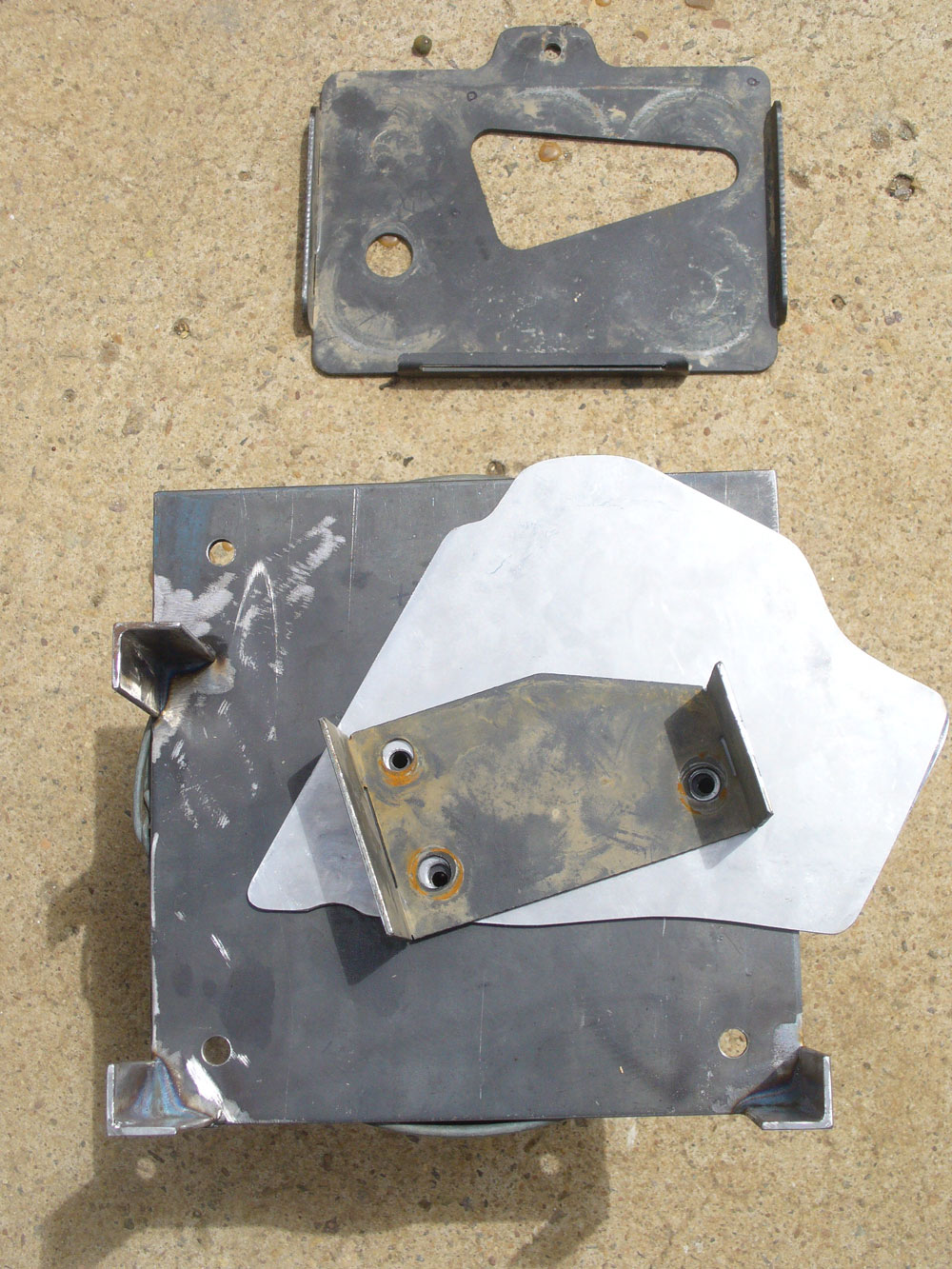

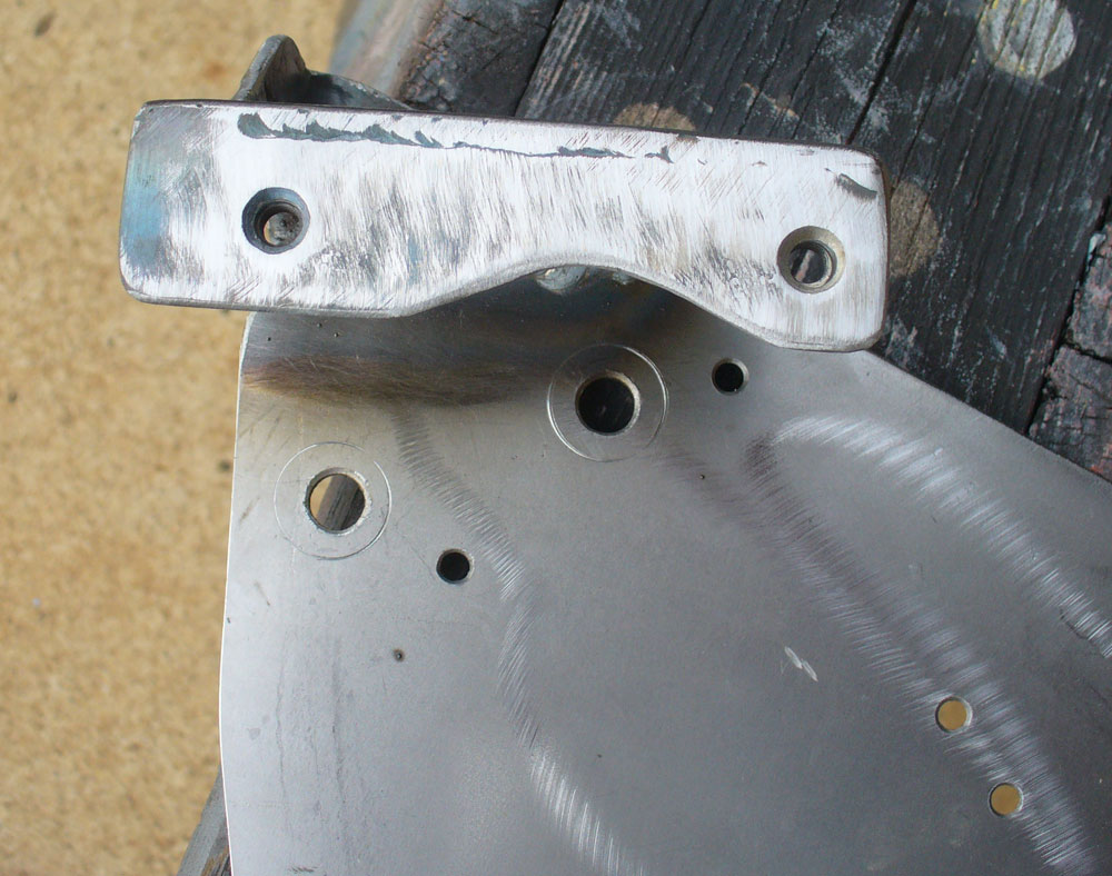

A new baseplate was cut out of 10GA sheet metal (after first making a cardboard template):

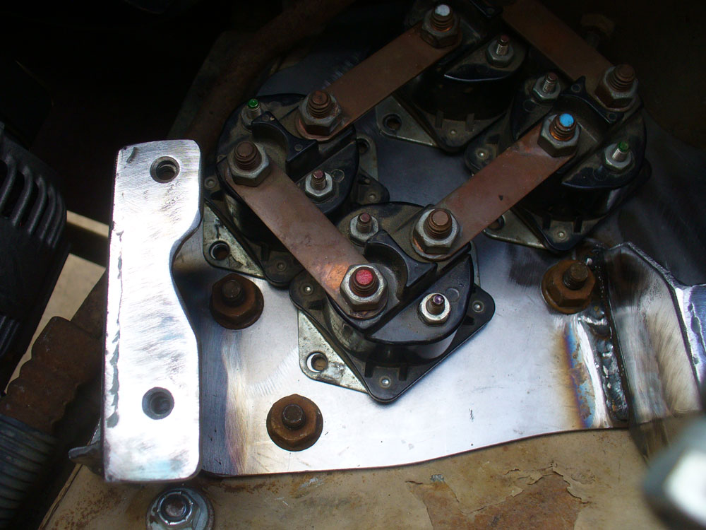

Here is how the plate will look with relays (See? There is clearance.):

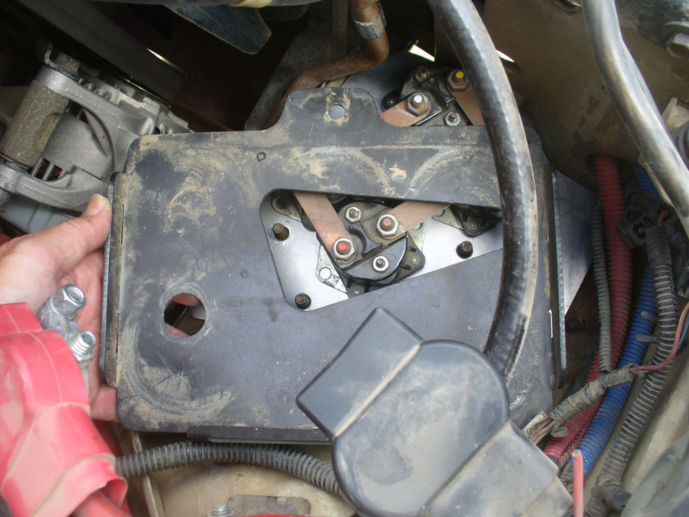

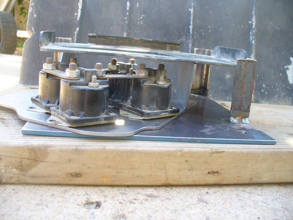

And then with the battery tray in rough position:

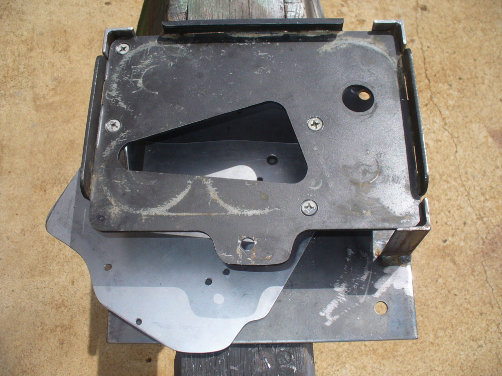

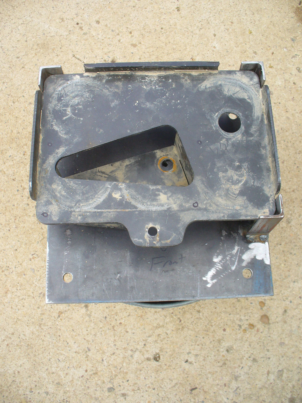

Comparison of the new baseplate to the Dirtbound baseplate:

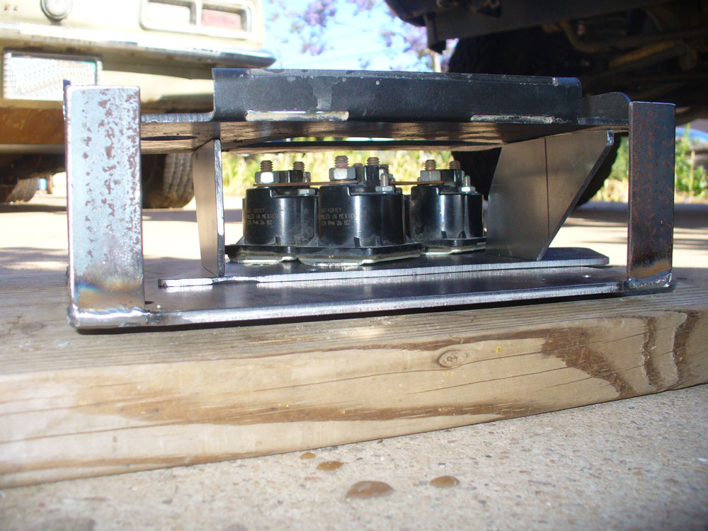

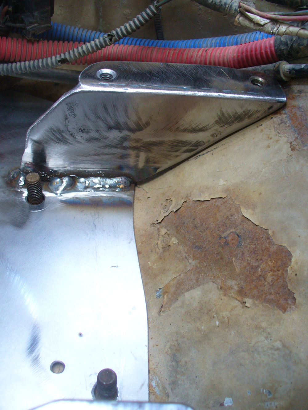

Outside view with roughed in supports:
And another perspective:
