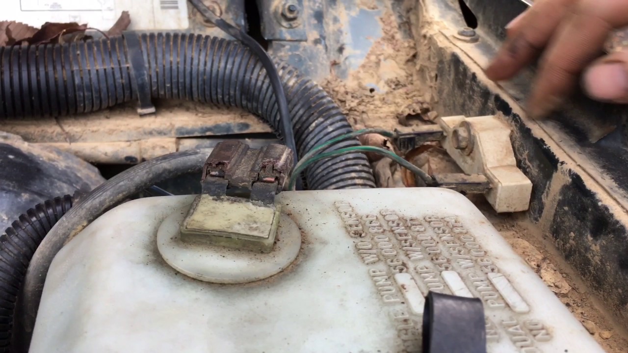

when you are messing with your cps. you are wiggling these wires. and its fixing your issue. but the bad crappy connections are still there.
is what I suspect.

The old pre 91 jeeps were notorious for ground wire issues in the entire sensor and controls ECU harness assy and the block connection near the oil dip stick.
You need to get a fuel pressure gauge on their and a volt meter (or ohm meter or both) and test every sensor and ground wire for loss of ground quality or loss of voltage while wiggle the wires/harness, and wandering fuel pressure.
