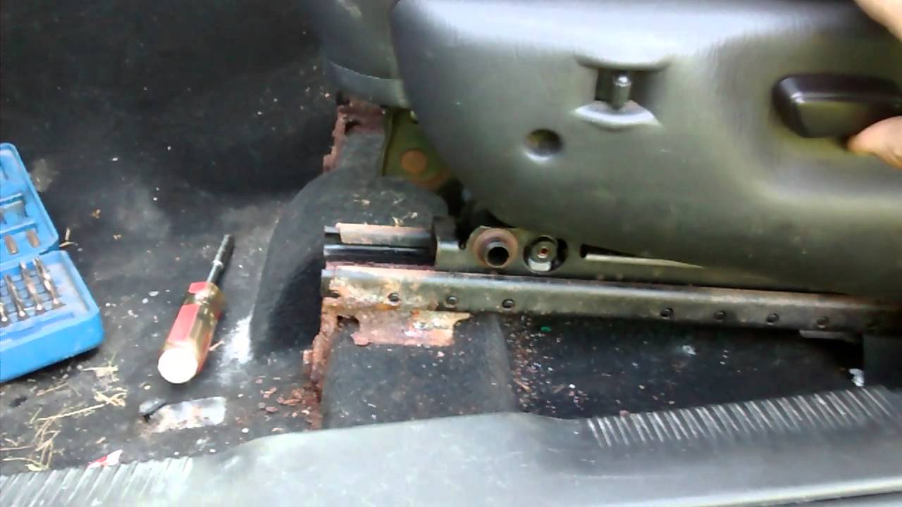

Have a look at the picture below. I think they're talking about fishing a nut into the channel. Catch is you need to pull up or at least slit the carpet to get to it.
Thank You, Sir. That is the explanation a newbie is looking for. May the Jeep Gods smile upon you.
