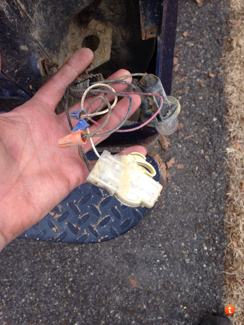

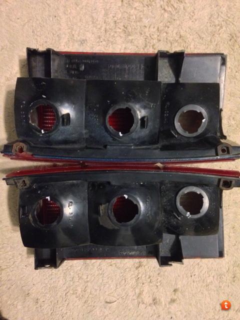

I didn't have a lot of time to work on the Jeep today. I wanted to try to fix the tailgate but it came to my attention that the tail lights are crap. One was out so I went to do the bulb, but I was damn near horrified to find house wire nuts used by the PO to repair existing wiring.

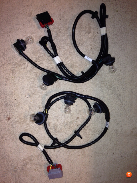

So that's got to go. Fortunately I have a brand new pair of wiring harnesses from a late model Silverado that I got for nothing. They have two brake/turn bulbs and one reverse, all 3047. I was saving these for my Monte Carlo, but it has perfectly good lighting and I need these now. New from the dealer these harnesses are about $40 if you were to buy two of the cheap side 25906854.
I know what you're thinking. "Dan, those bulbs won't fit." And you're right. This required minor modification of the bulb receptacles in each lamp. 90 seconds with a Dremel tool and they fit. About 1/8in needed to be taken out of one tab slot for each bulb and the ground wires needed to be extended between the bulbs. I think older GM harnesses with the reverse on bottom would probably require less wire modification, but these were free to me. I chose to modify the plastic lamp to fit because it's much easier this way than modifying the bulb sockets. I think the stock bulb sockets would still engage, but it doesn't really matter. I have no intention of selling these lamps. If I ever buy new lamps, I'll just modify those again. The trimmed areas are marked in white.
So far this has worked brilliantly. I've now got three bulbs per tail lamp and I need to join four wires per side. Total cost: about $0.50 worth of solder, heat shrink and tape, and ten minutes. Not so fast though. These lamps have been thru the last 23 years and it shows. All the mounting tabs are cracked or broken.

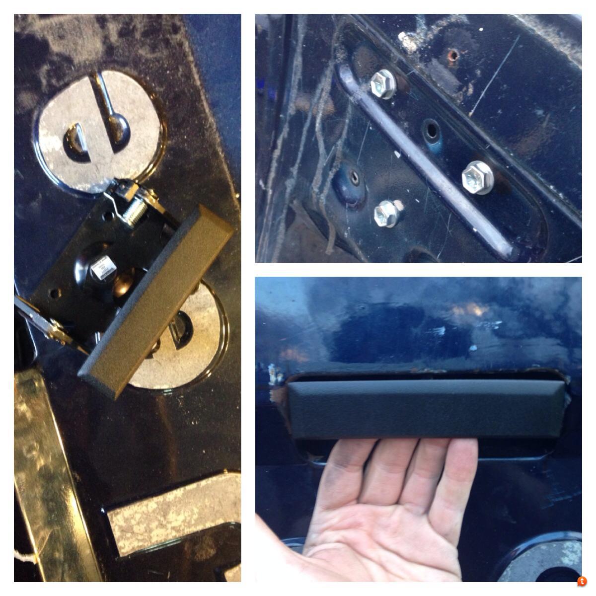

I fixed my tailgate today. When I bought my Jeep, the tailgate handle was rotted off and I had originally intended to rebuild the handle with new bushings on the functional assembly and fabricate my own release handle with a sheet metal brake. I just hadn't made it a priority.
So I was at the parts store the other day to pick up CV axles for one of my VWs, and I decided to take the broken Jeep handle with me so I could compare it to their aftermarket handles. Turns out a 88-98 Chevy C/K tailgate handle is about the same size, but the bolt pattern is different and the rods connect at the bottom instead of the top. I decided that was good enough for me, so I took it home. Dorman 77077 - $21 with tax.
This component is a really easy install. I had to trim away a little metal inside the tailgate handle hole to fit the new tailgate handle through, but other than that it's just three holes drilled and done. The whole project was about 20 minutes. I'm happy with it so far.

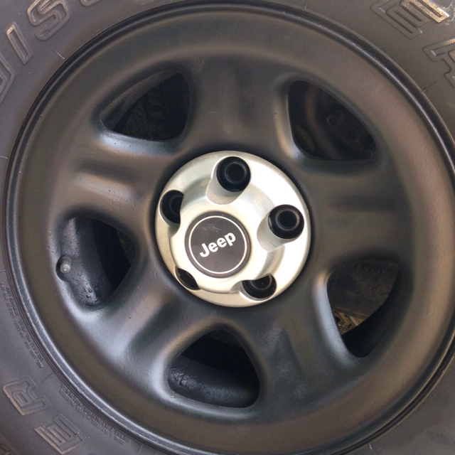

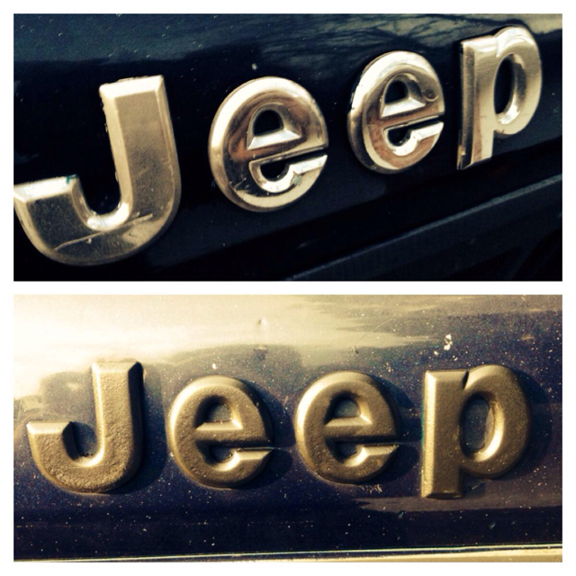

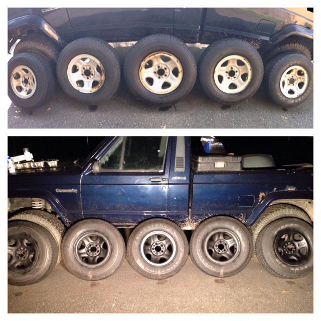

I haven't posted an update in a while. I recently got new wheels and tires, refinished those wheels, and de-chromed my badges.

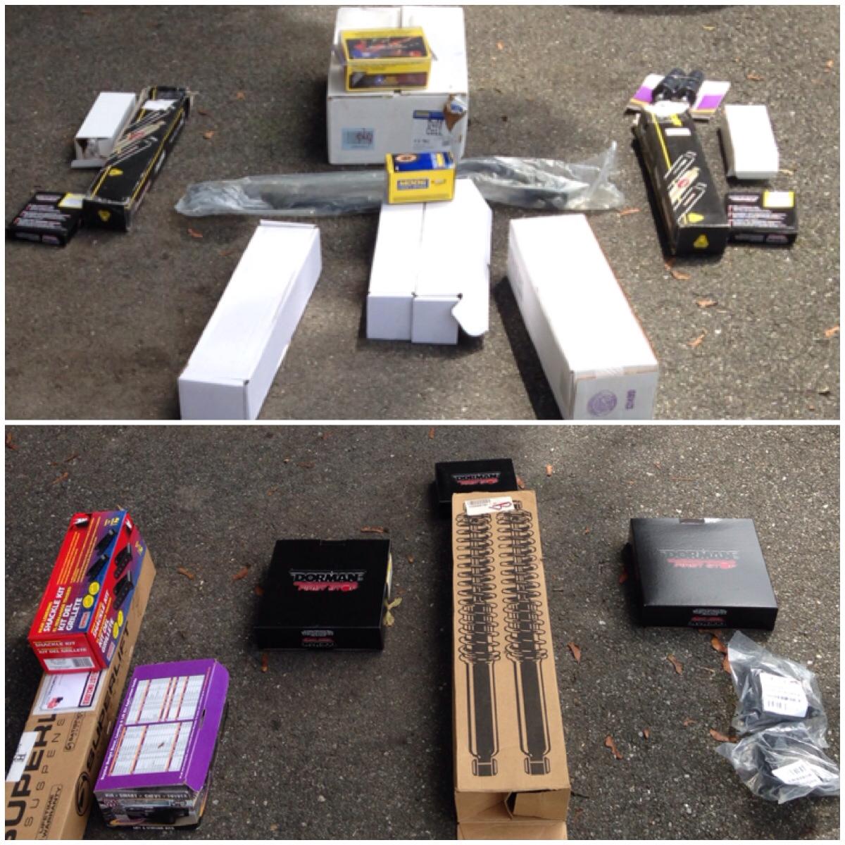

But this weekend's project is a little more extensive: all new suspension.
My Jeep came with 4.5in lift coils and no other lift components installed. It was a little unpleasant. I decided to get rid of almost everything and start fresh. The only thing I kept were the leaf springs; they're not broken and I'm not ready to bob the bed yet but when I do, I'll replace them.
In the front, Upcountry coils and Energy Suspension spacers should net me about 2.5in over stock height up front. Daystar TJ bump stops will keep it in line. WJ lower arms and XJ upper arms with new upper bushings on the axle will keep the front planted with a new track bar. Extended sway bar links will prevent rubbing. The old ones rubbed on my coils all the time. Monroe extended shocks should smooth out the bumps.
Out back, the leaf springs get augmented with a Superlift add-a-leaf, 7in adjustable shackles and Daystar poly bushings. Monroe coil-overs should make it nicer to actually use the bed. New stock bump stops and parking brake cables for safety. My Jeep didn't have any when I got it. Extended brake lines all around and that's everything.
