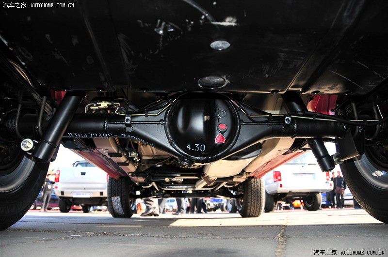

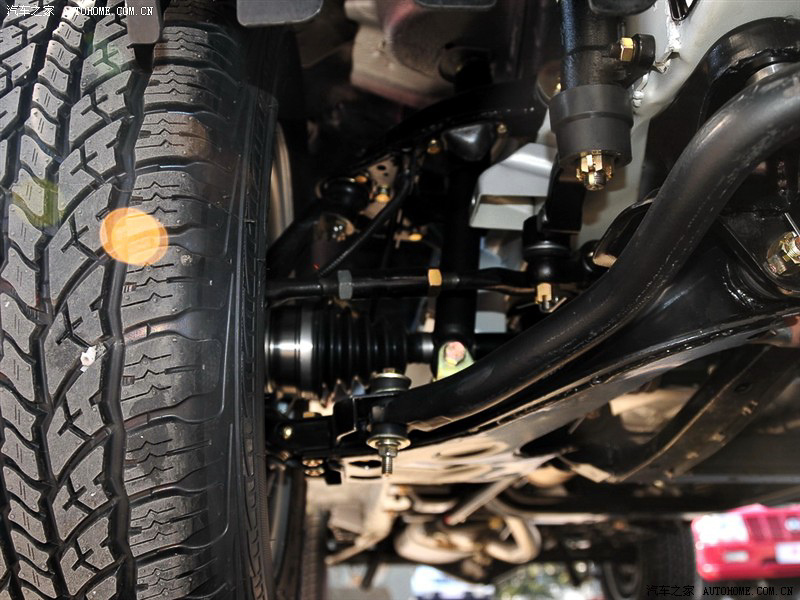

Buy all the parts from China for the current iteration of the Chinese Cherokee(Knight/Qishi S12). It has independent front suspension made for the XJ unibody. The time here is finding the supplier that will ship to the USA and the money to buy cheap parts.

that is an interesting design, we are getting somewhere, but i think some fab work is in order. in my project file i'm writing up for my street manche, the truck sits low. so if i went with the s12 front end i would have to suck it up into the frame so the control arms are parallel to the ground at ride height. my one problem i run into when it comes to the IFS is steering. there is an oil pan in the way of the rack and pinion and that will need to be over come. but for now this is a theory exercise, actuality is later
