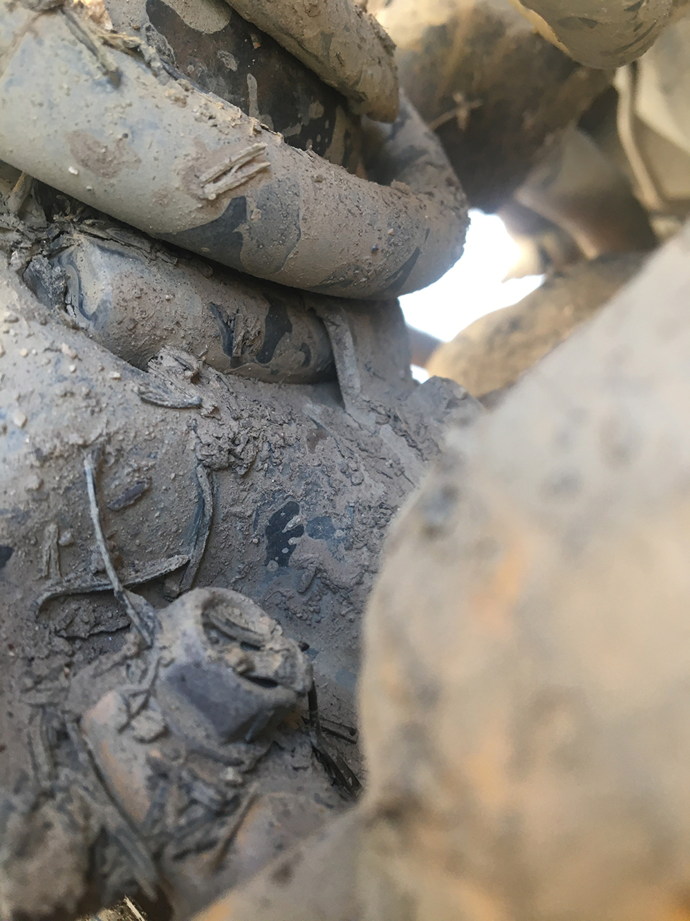

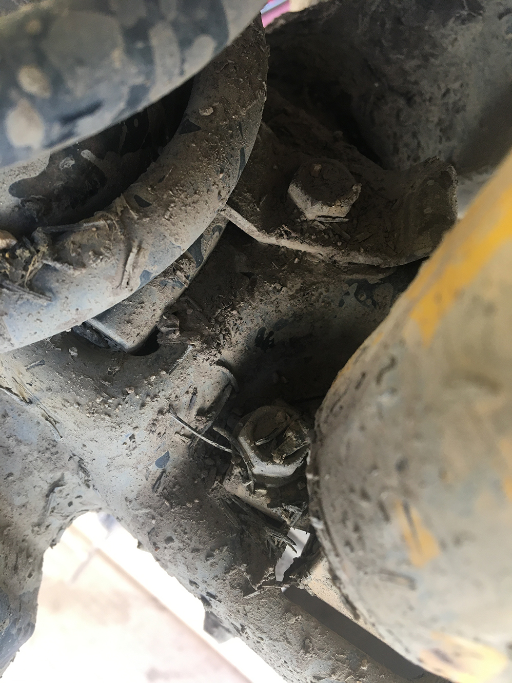

I have a set of OME springs in front and the left one has been making binding noises on compression since day one. I've looked at it and it seems to me like the coil is seated and clamped in correctly, so I am looking for reasons why this might be happening. Anyone have any ideas on how to fix it?
Pics:
Is your track-bar stock?
If the front axle is running off centre it could cause a different spring behaviour between left and right springs.
When I was having that issue it was rubbing the trac bar bracket.
^^^^^^ my cloak springs hit my iron trackball bracket unless i shift my axle about a 1/2 inch over...
