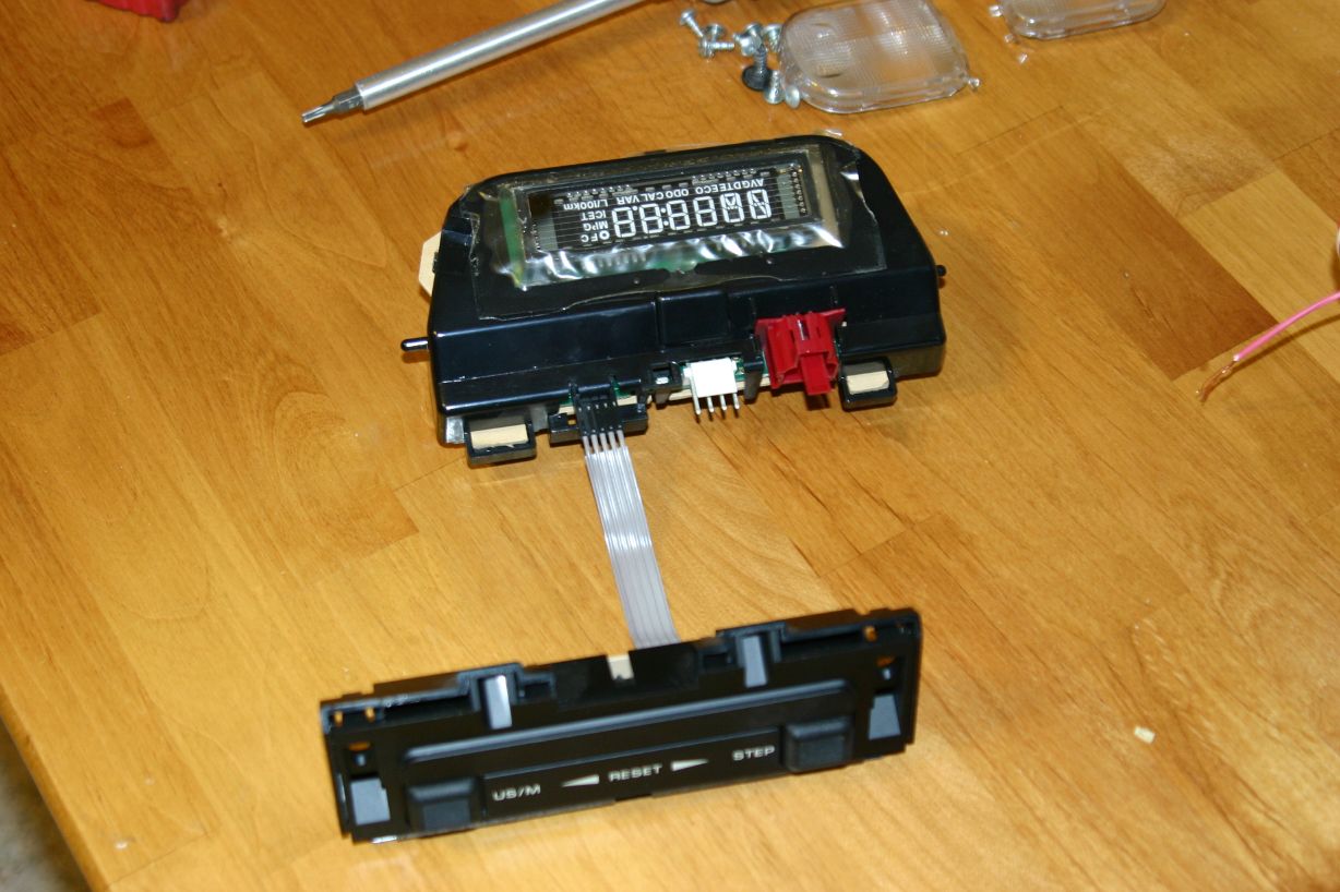

Installing a ZJ/XJ overhead console:

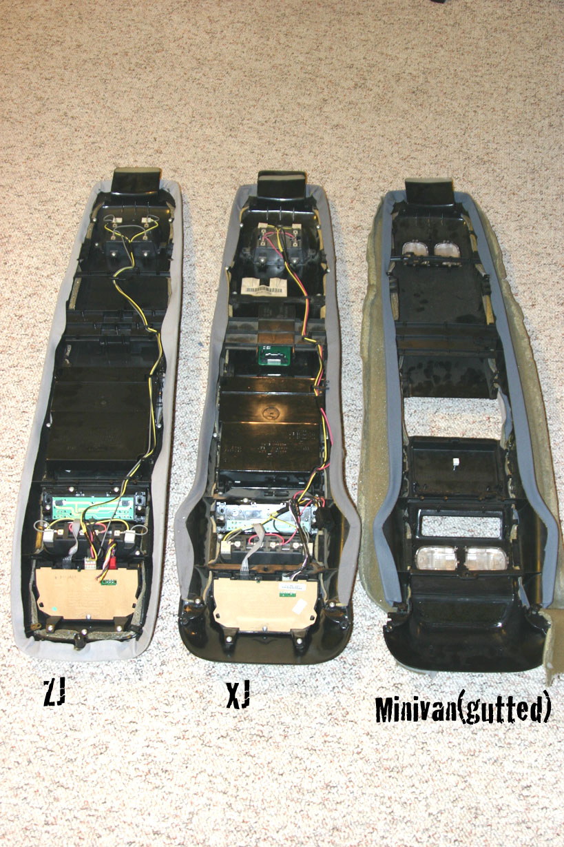

The jist of this is that you need to take a ZJ overhead console(96-98), ZJ BCM(96-98) and vinivan console, do some work, and then have it work just the same as the factory overhead console in the 97+ XJs.
Since 97+ console are pretty rare this is a way to use relatively abundant parts to get the same functionality.

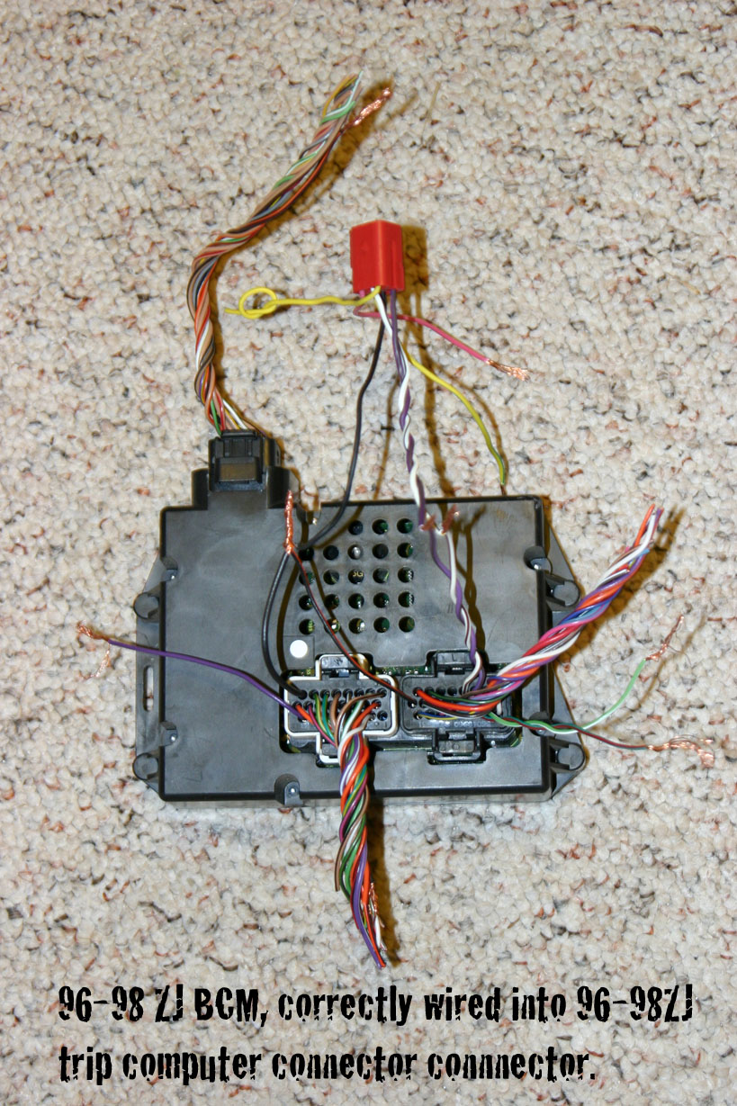

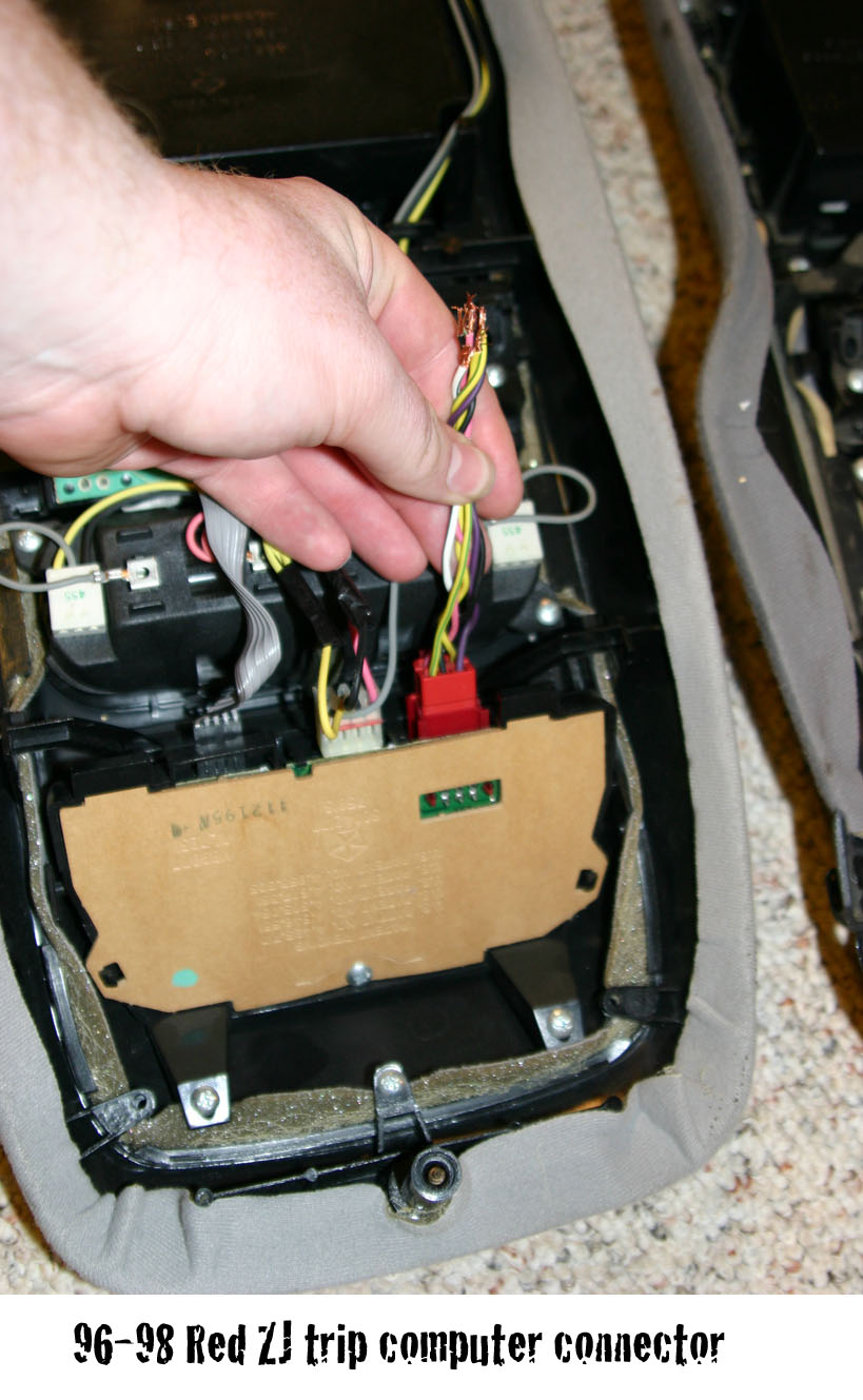

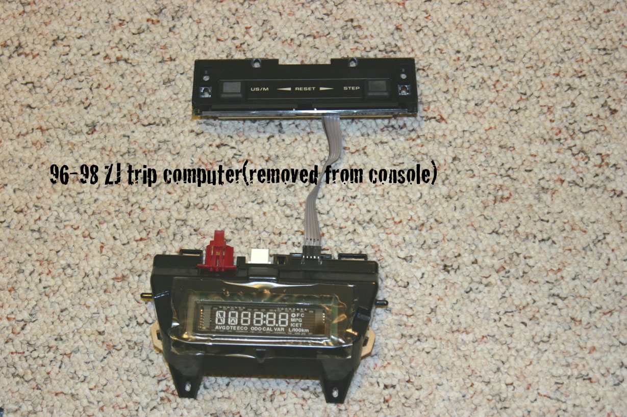

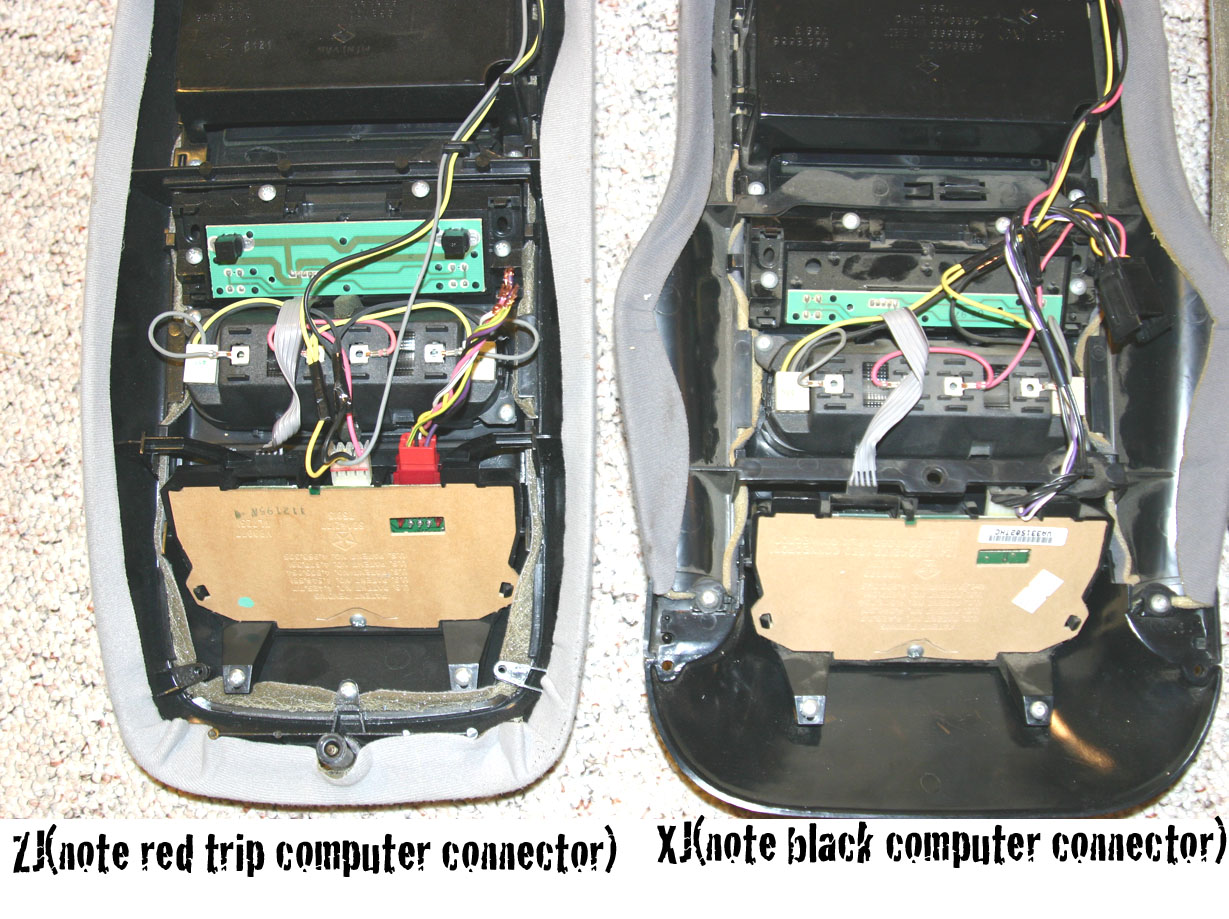

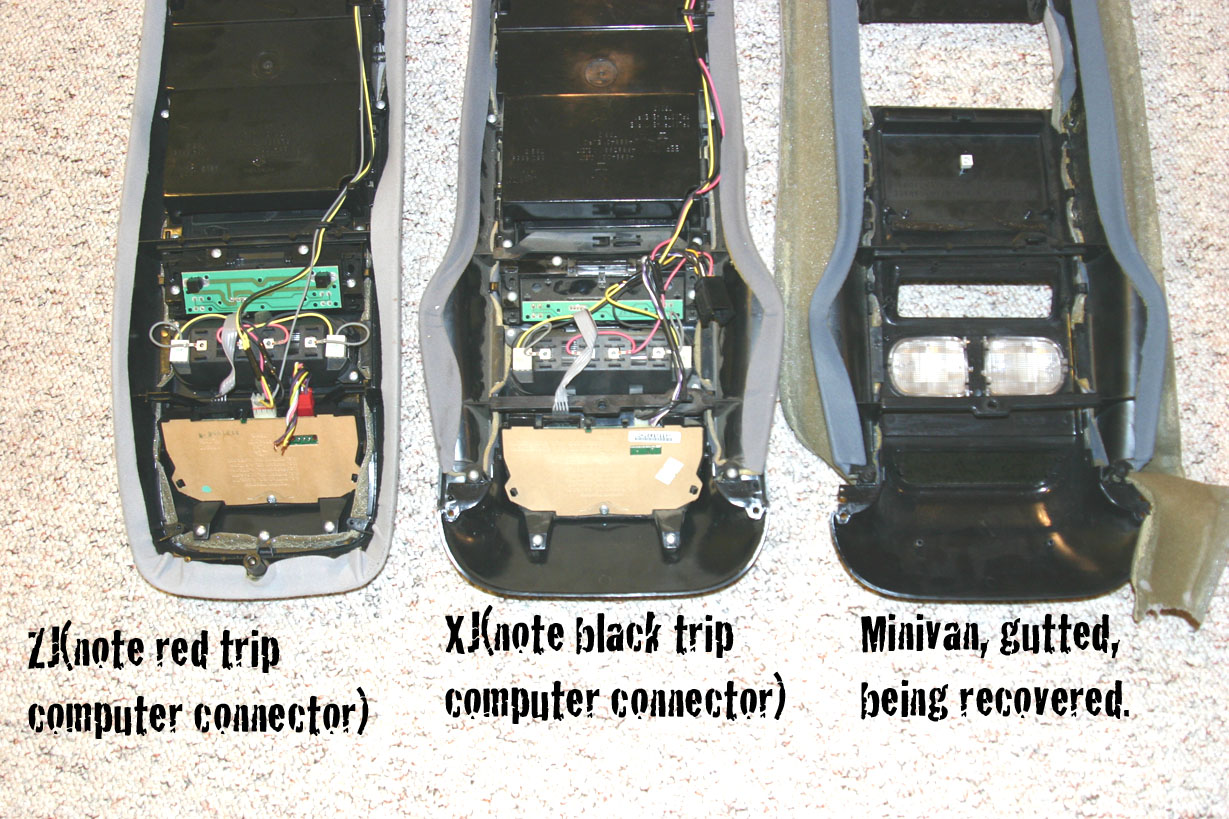

Ok to do this you will need a 96-98 ZJ trip computer, 96-98 ZJ BCM(body control module).
You could probably make the whole ZJ console fit into the XJ(its mount at the rear is the same), and do the wiring below to make work.
Or you can take a consol out of a minvan(which is the same as the XJ, with the exception of the computer), and use the ZJ guts(look below for that post from another person).

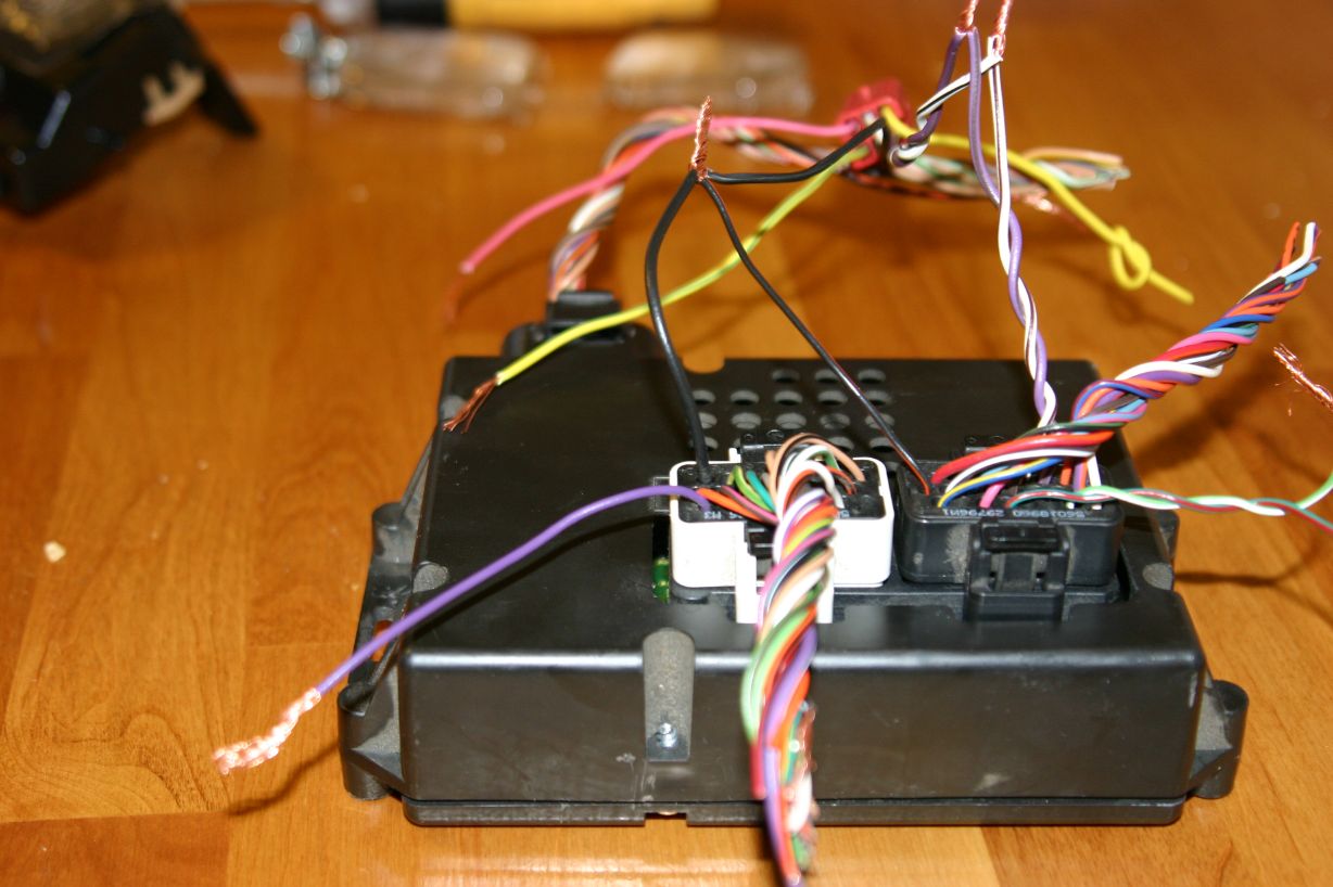

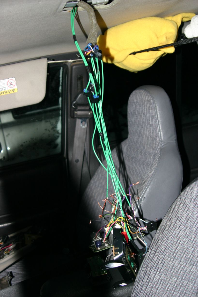

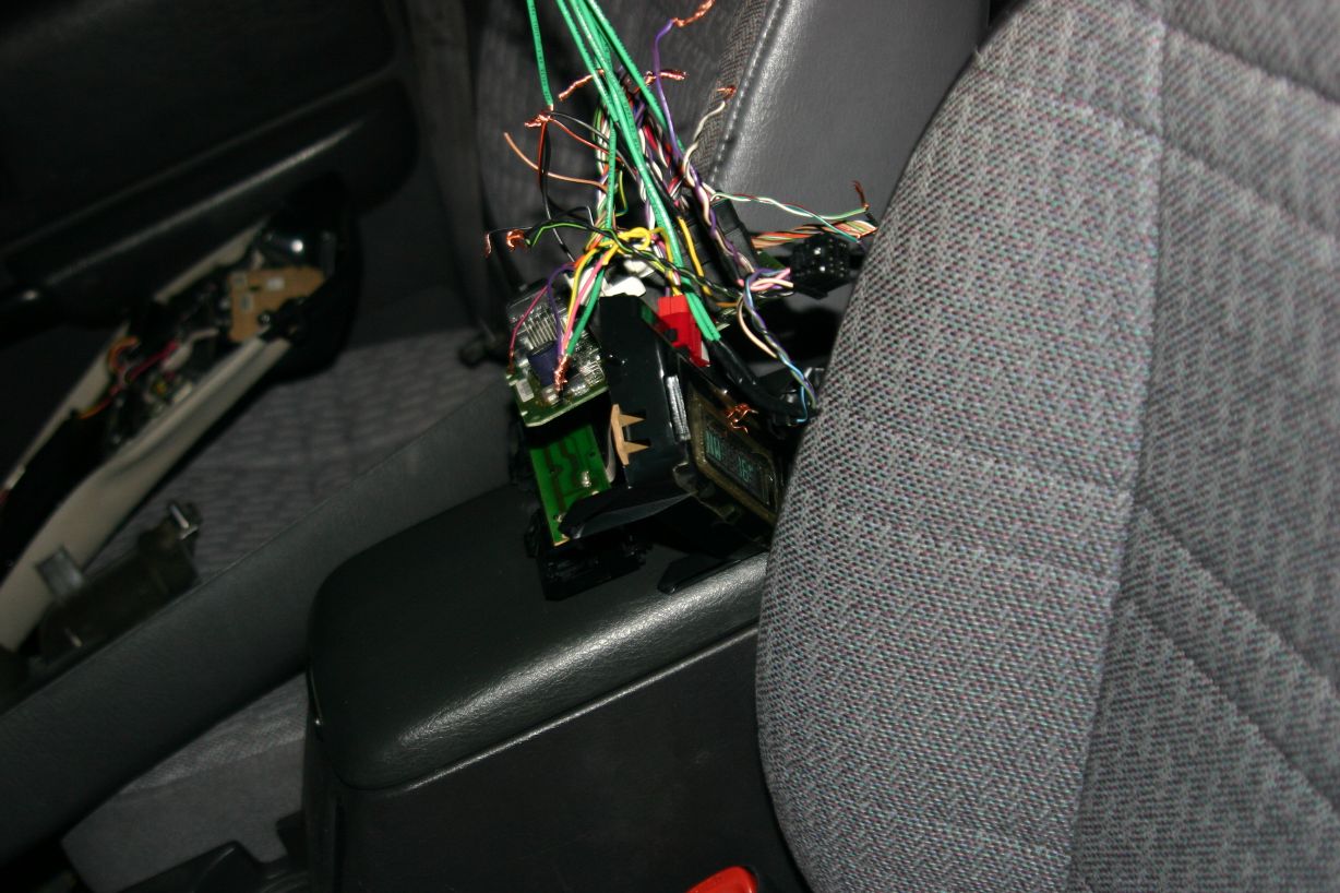

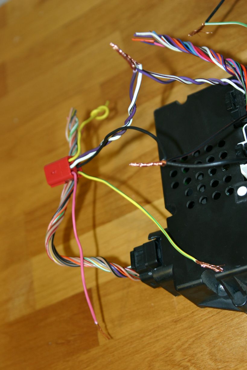

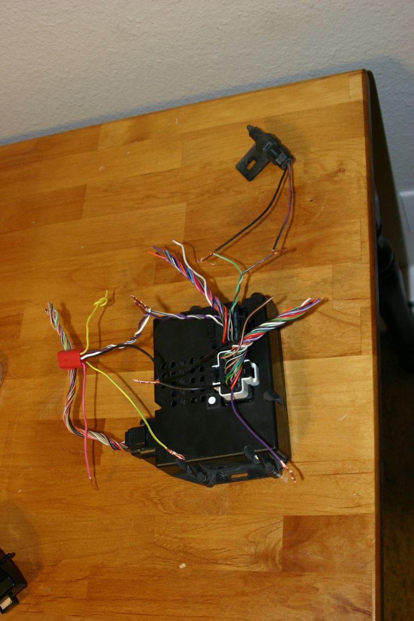

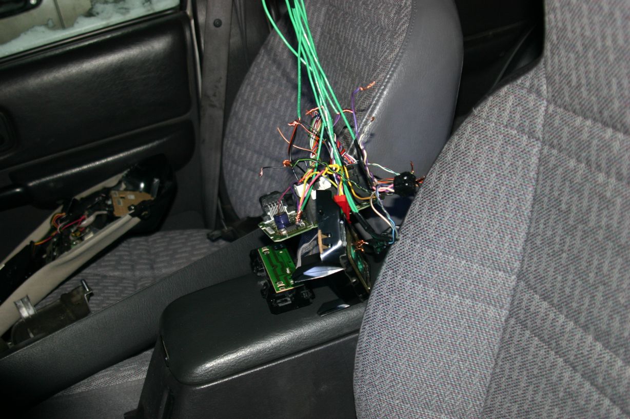

Testing apparatus of dangling wires:
Headlights on, displayed on brightest dim setting:
Headlights on, lowest dim setting:

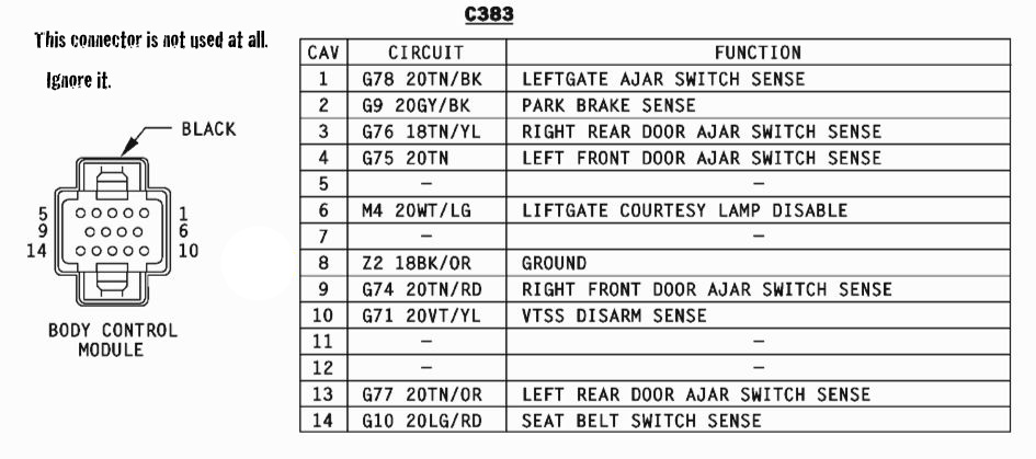

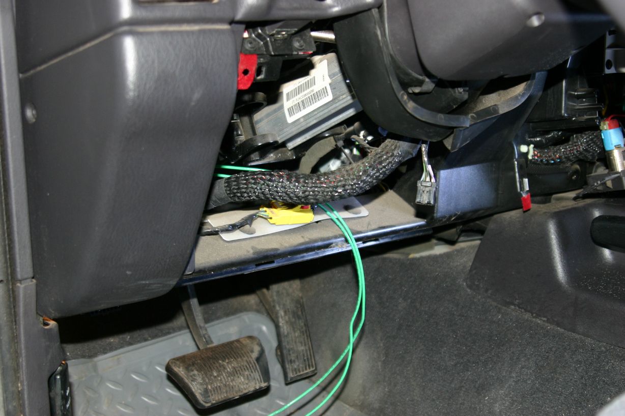

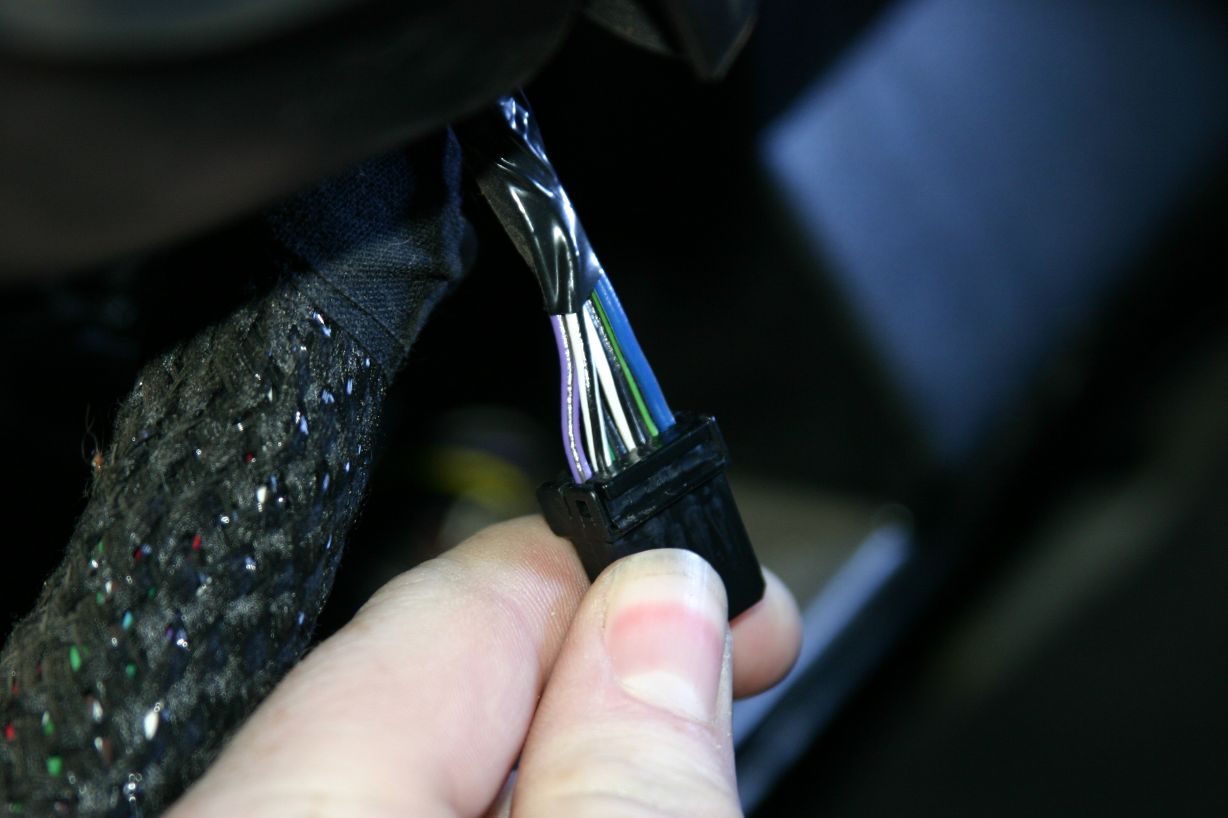

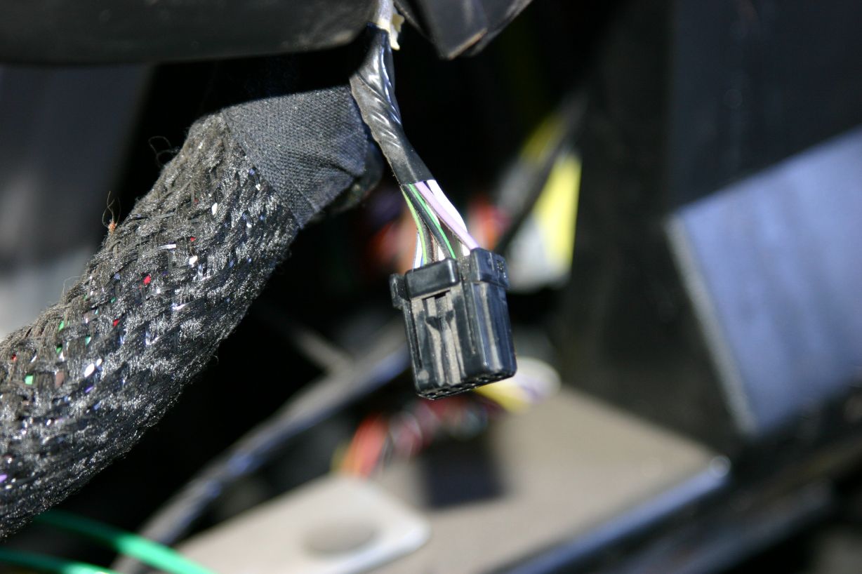

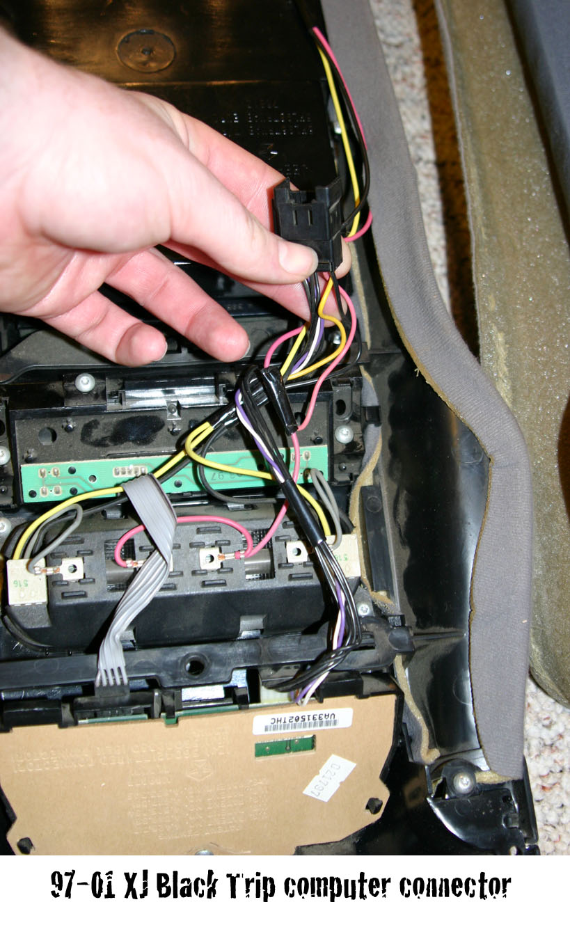

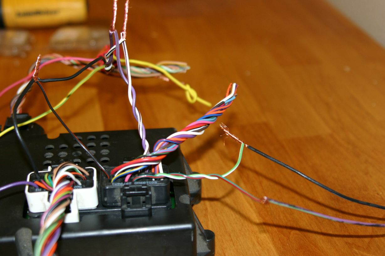

This is the connector for the sentry key module, if you do or dont have this you could tap into the CCD bus here. If you do have it then you could still tap into in the CCD bus, but I would recommend pulling power/ground from the cig lighter. If you dont have the sentry key then you could pull your power, ground, and CCD bus lines from this unused plug, and run 2 wires for the temp sensor up to the ZJ BCM which would be convenently stored and wired out of the way under the steering column in that huge space shown.
This would mean you would only need to run a single switched power wire up to the over head consol, all the other wiring will be in place.

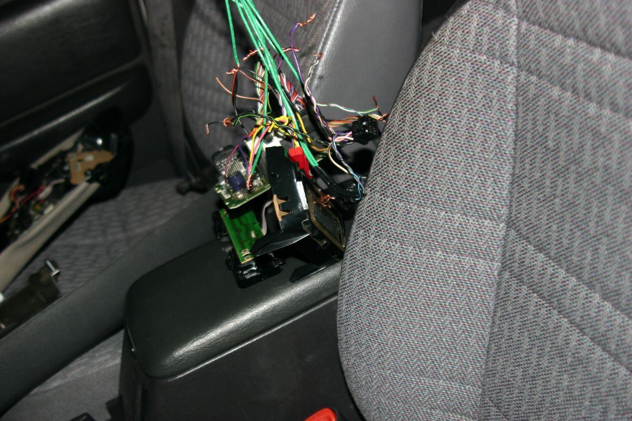

Otherwise if you choose to install the ZJ BCM up with the overhead console(end there is room to tuck it up there, you would need to run a power, and 2 wires for the temp sensor.
I like the solution of putting the ZJ BCM down at the kick panel and then running only a single power wire from the cig lighter up to the overhead console.
This is the pinout diagram for the sentry key connector:

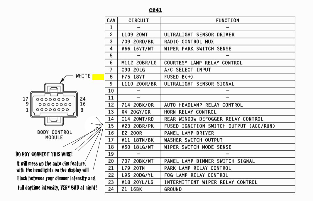

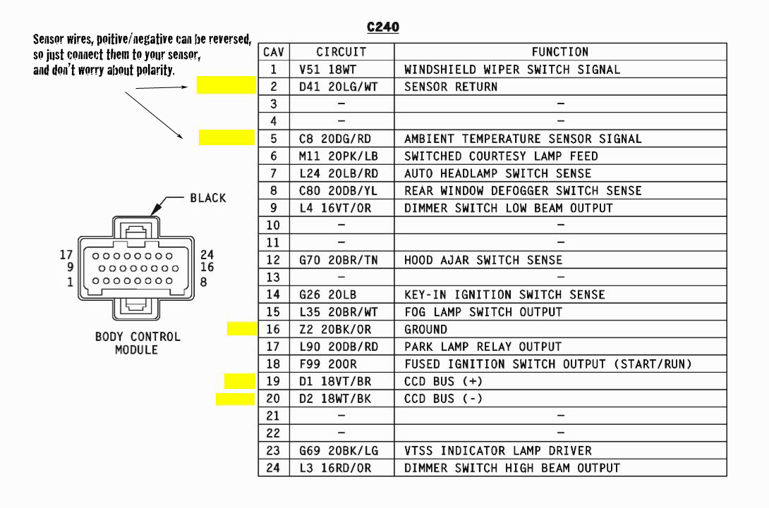

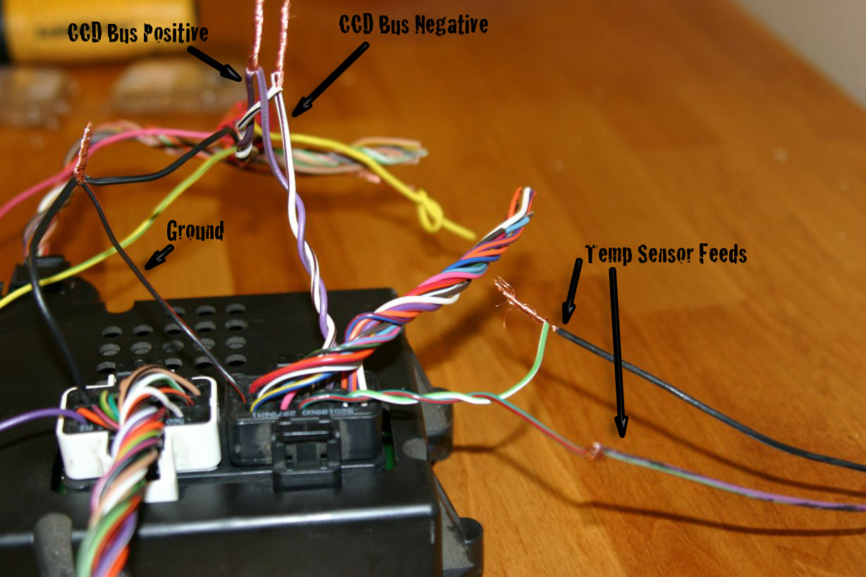

Here are the specific wires that you will need to use for the ZJ BCM:
And the pinout diagrams of those:

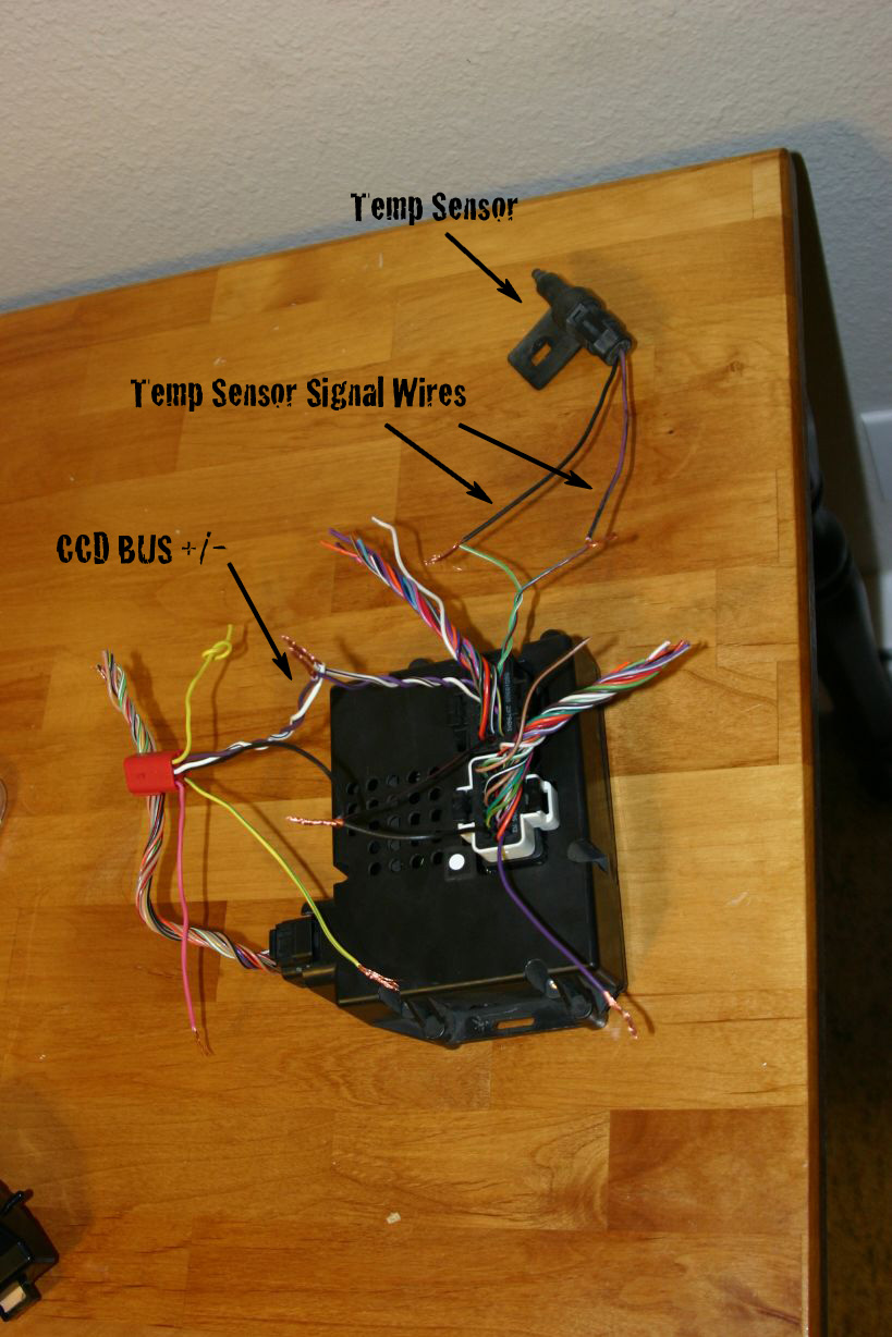

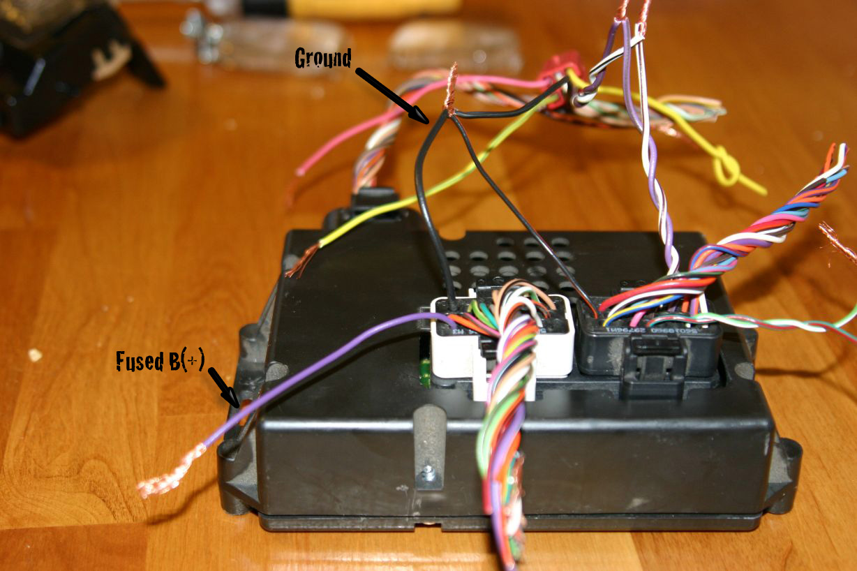

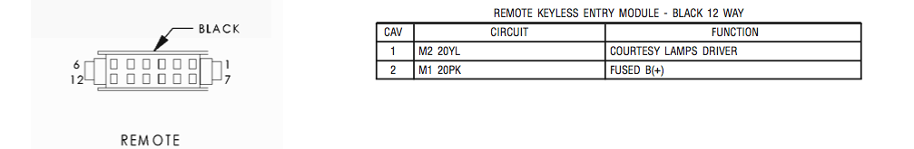

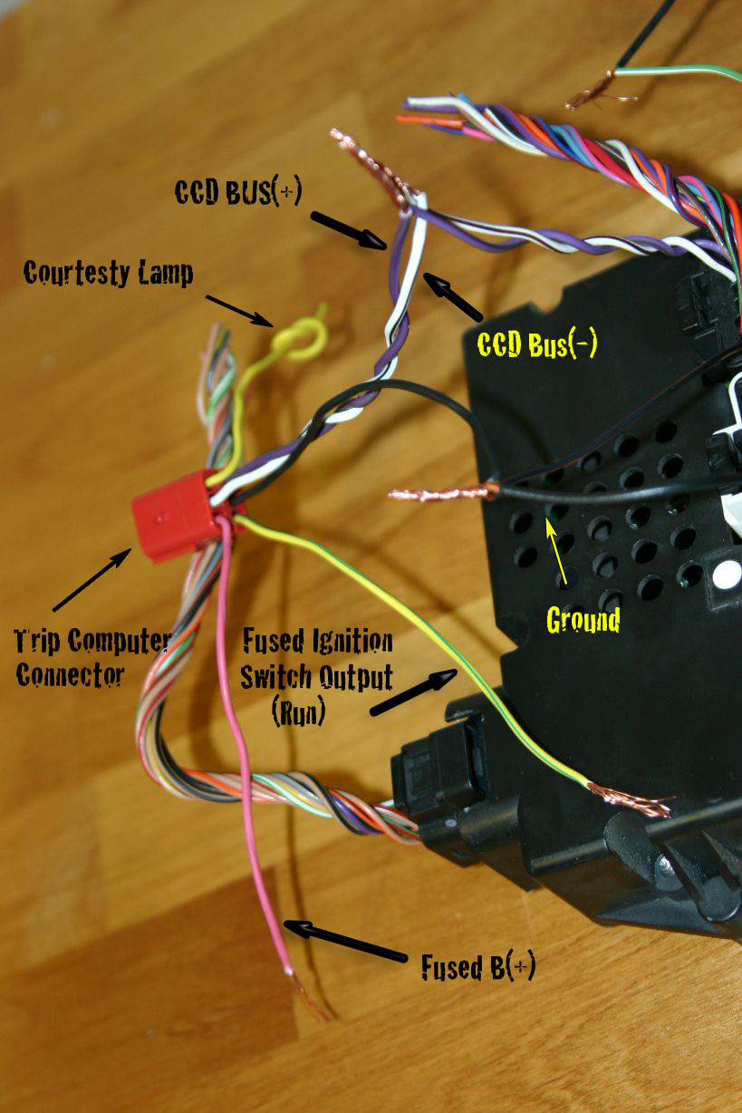

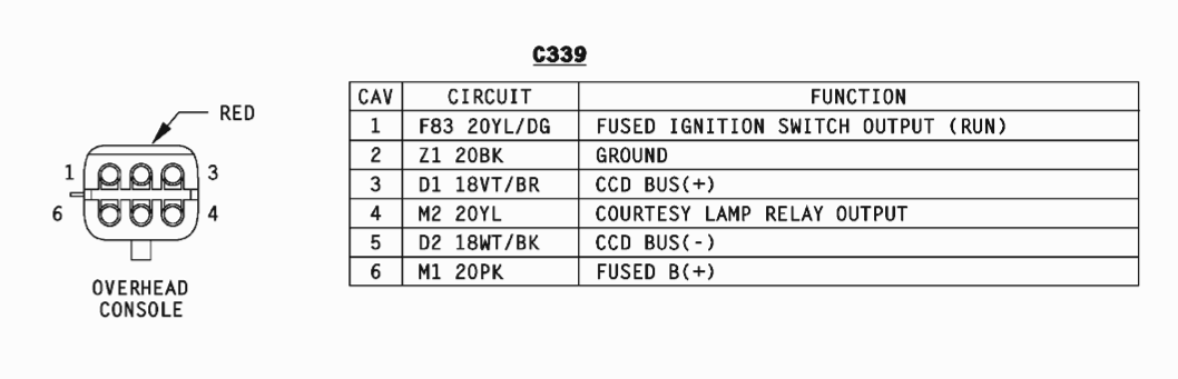

You will need the CCD bus, grounds, courtesy lamps, and fused power to provide to the ZJ trip computer:
Here is the ZJ trip computer pinout(the red connector in the above photos).
Connect your switched power wire you run and your wires from the RKE plug to make this work, like I said above you can either put the ZJ BCM up there and tie it into all that wiring, like I did on my test setup, or put it down at the footwell, it wont matter either way, the ZJ BCM transmits the data on the CCD bus, so it doesnt matter where you put it(you could even put it in the engine bay and tie into the CCD bus at the PCM if you felt so inclined)

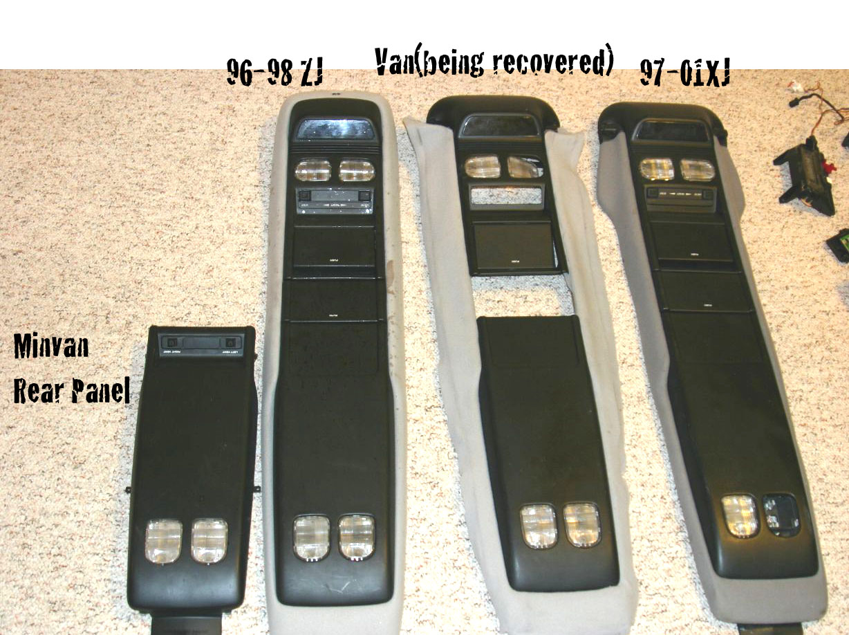

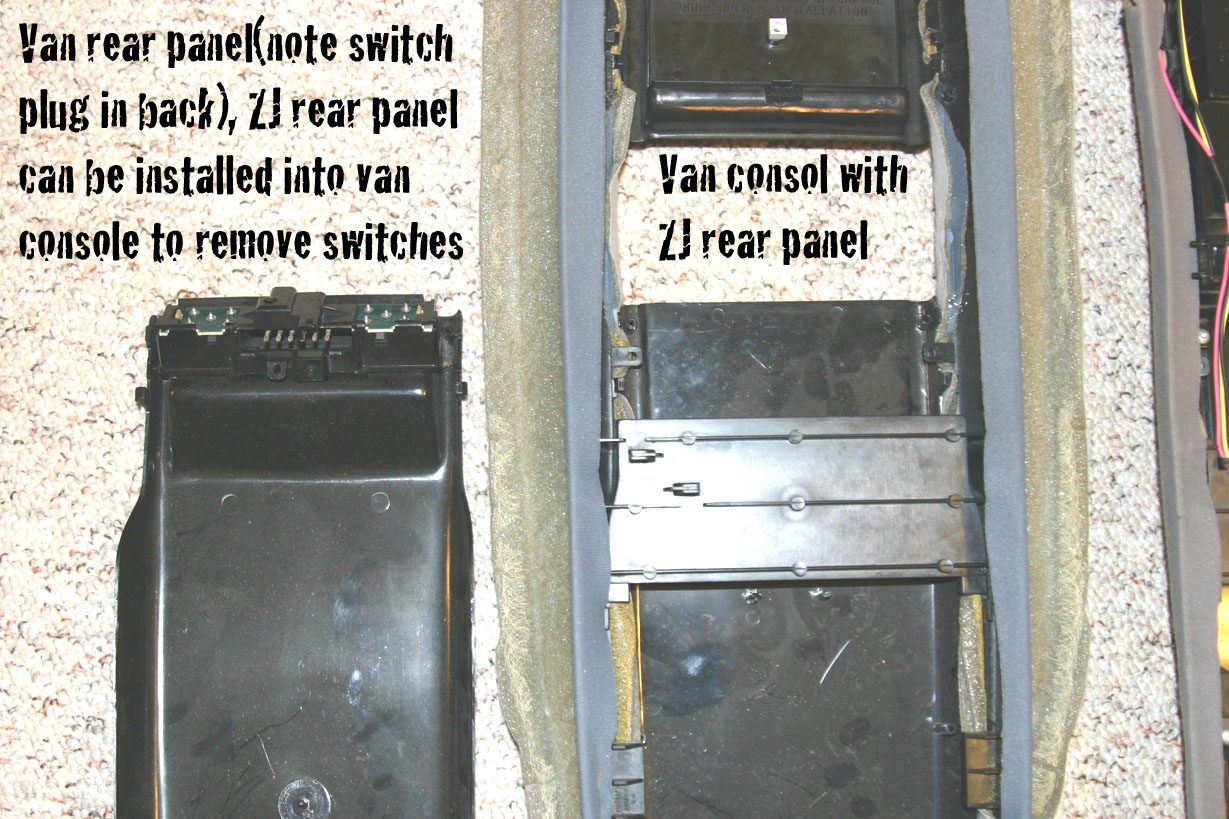

Originally Posted by JeepXJ3 View Post

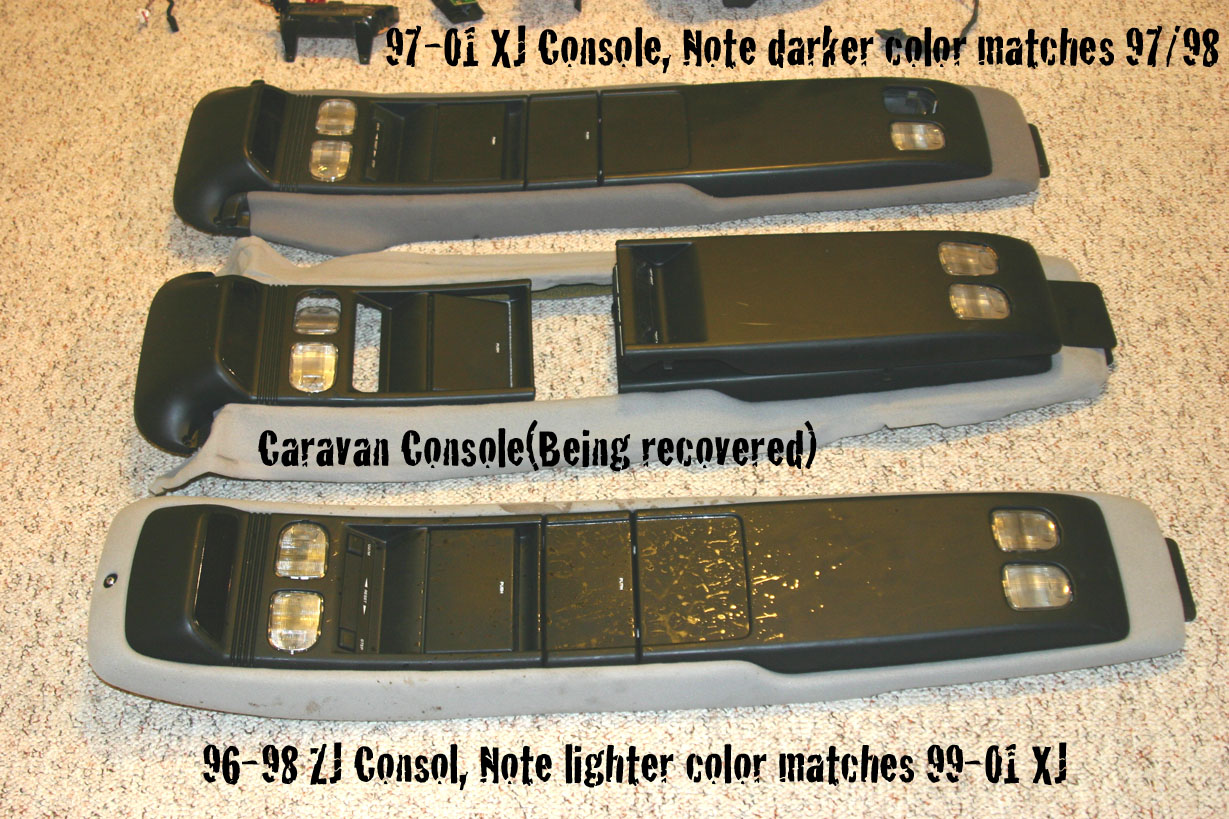

Ok, so I was rooting around in the junkyard today and I came across a 95+ Chrysler minivan with what appeared to be the same center roof console as an XJ... I did a little more looking around and decided I would go ahead and grab it, and see what I could come up with.

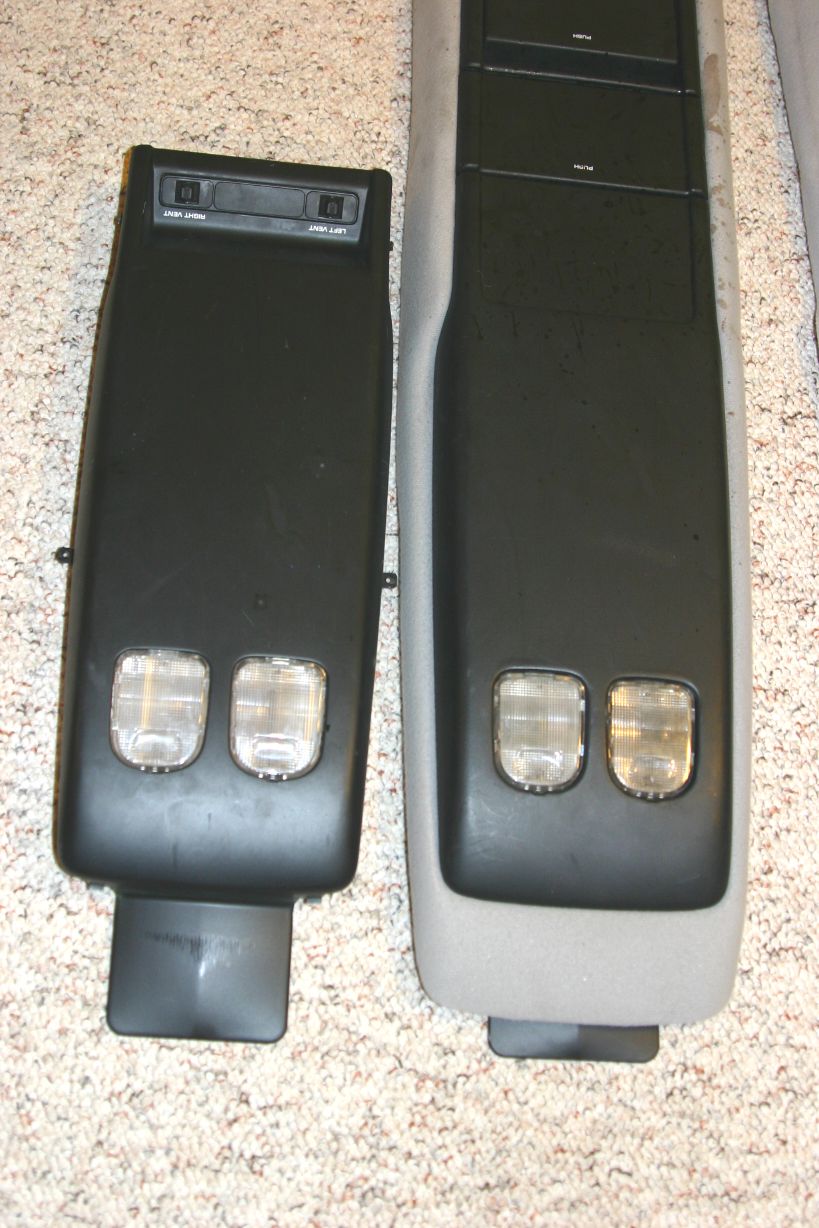

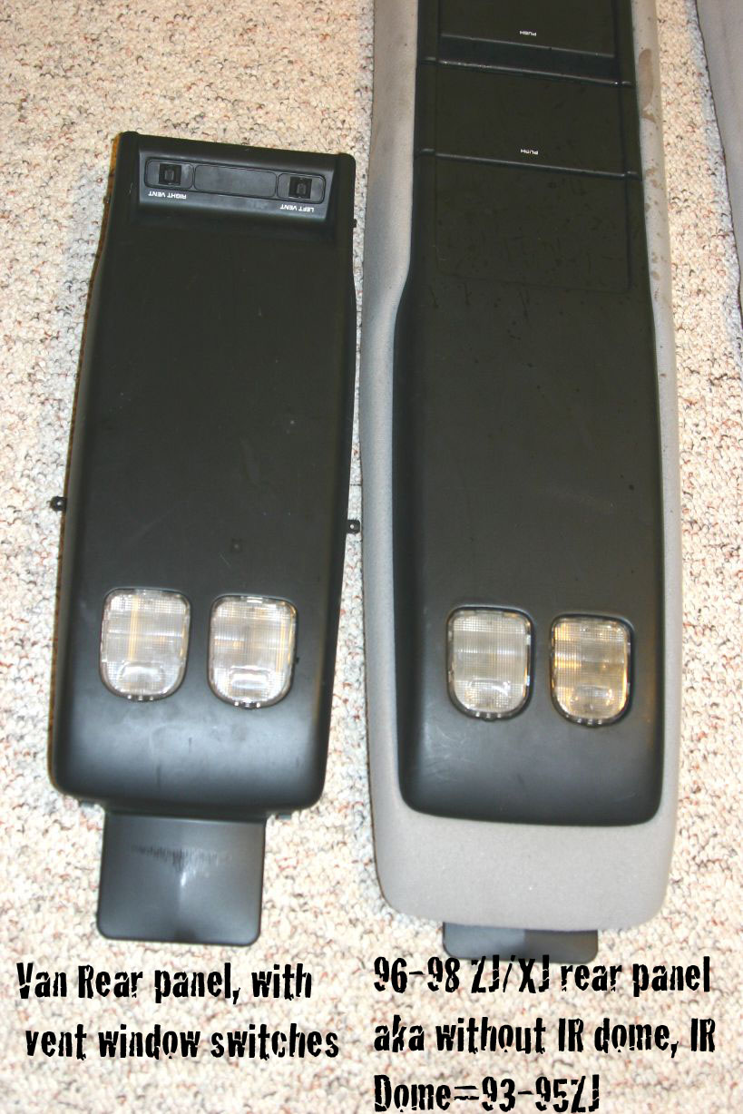

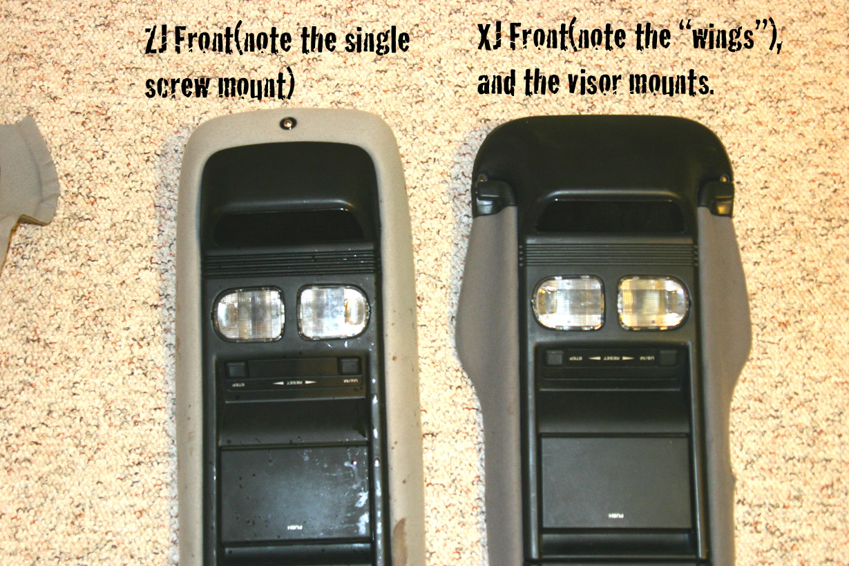

I noticed that newer ZJ's had a blank dummy pannel the same sized as the one in the minivans except it was lacking the rear window switches. So I grabbed one of these.
Here you can see the difference between the Cherokee Overhead console and the Minivan Overhead console.
This is what you will start with.
To convert the Minivan Console you need to remove the back pannel from the console.
End result:
Oh and on the console itself there is a Jeep part number as well as the minivan part number so they are the same unit.
I even went as far as plugging the 2 consoles into my 96's existing overhead console's wiring and it worked perfectly with the exception of gas mileage and trip computer. So I would assume you would be able to get this to work in a pre 96, without the gas mileage or trip computer working. Next time im up the yard im going to grab the wire harness from the minivan and see if this works as well.
Hope this helps you guys!

However I should note that on my 00 XJ I tried supplying the ZJ BCM with the dimmer intensity signal from my headlight switch without success, in the course of my experimentation I found that by leaving the right grounds disconnected from the ZJ BCM that I was able to resolve the issue. The issue had been that with all the grounds connecting there was a conflicting data packet about the dimmer intensity, this caused the overhead console to flash between the correct dim setting, and the full intensity, needless to say this would be unacceptable at night and annoying during the day.
so if you try to go the ZJ BCM route with the newer ZJ overhead console, you may run into that same issue. either way I think something could be done to install the console and be fully functional for you 95 and older guys.
