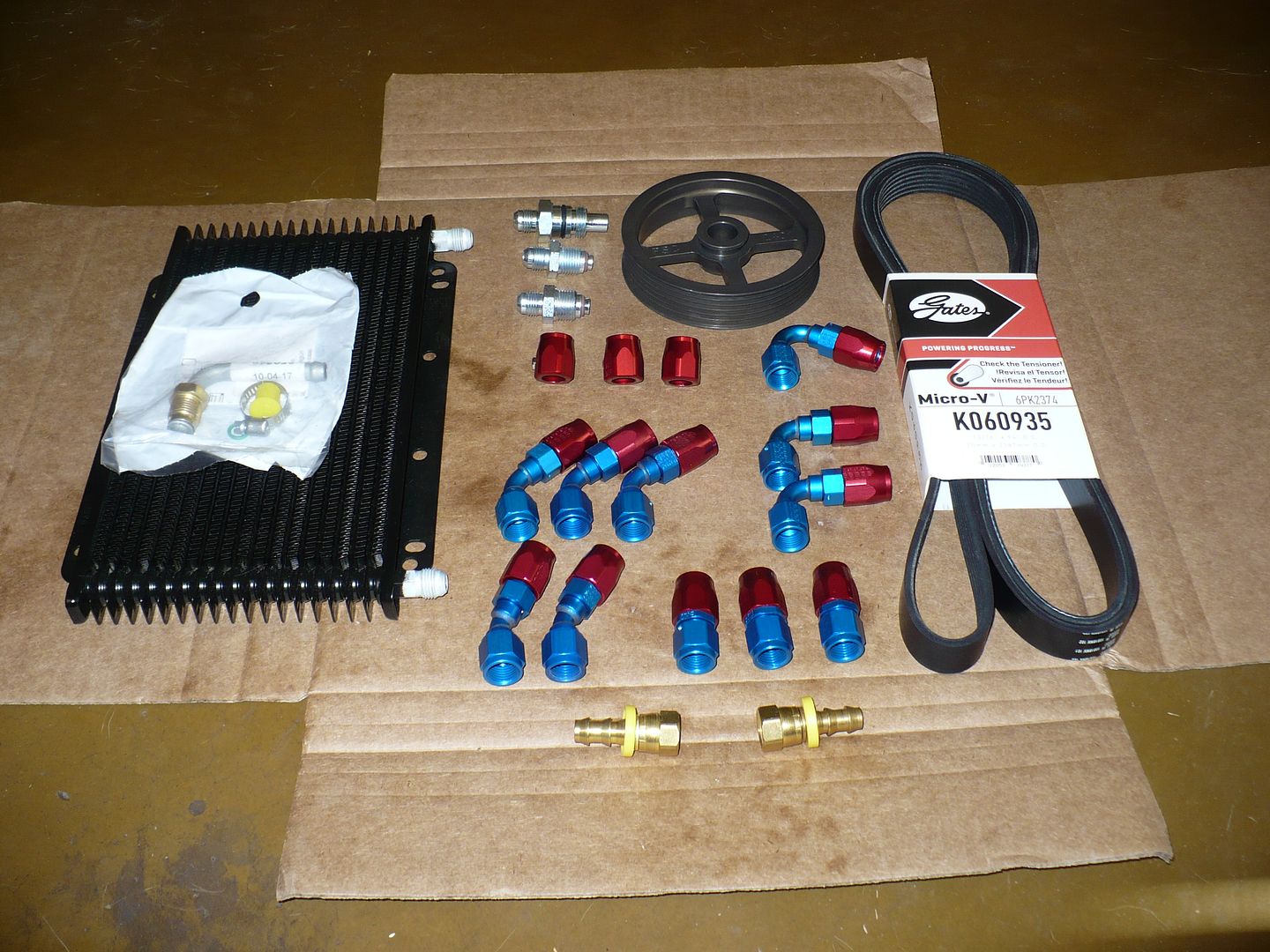

Since my current belt is a 950 and I'm almost out of tension adj (plenty of slack adj) I will p/u a 935 to start. Math says I need a 1.4" shorter belt so that's a good start. My AN fittings and pulley from PSC should be here tomorrow and my cooler on Wed.

I've finally got most everything together(waiting on 1 thing) and will install it Wed!

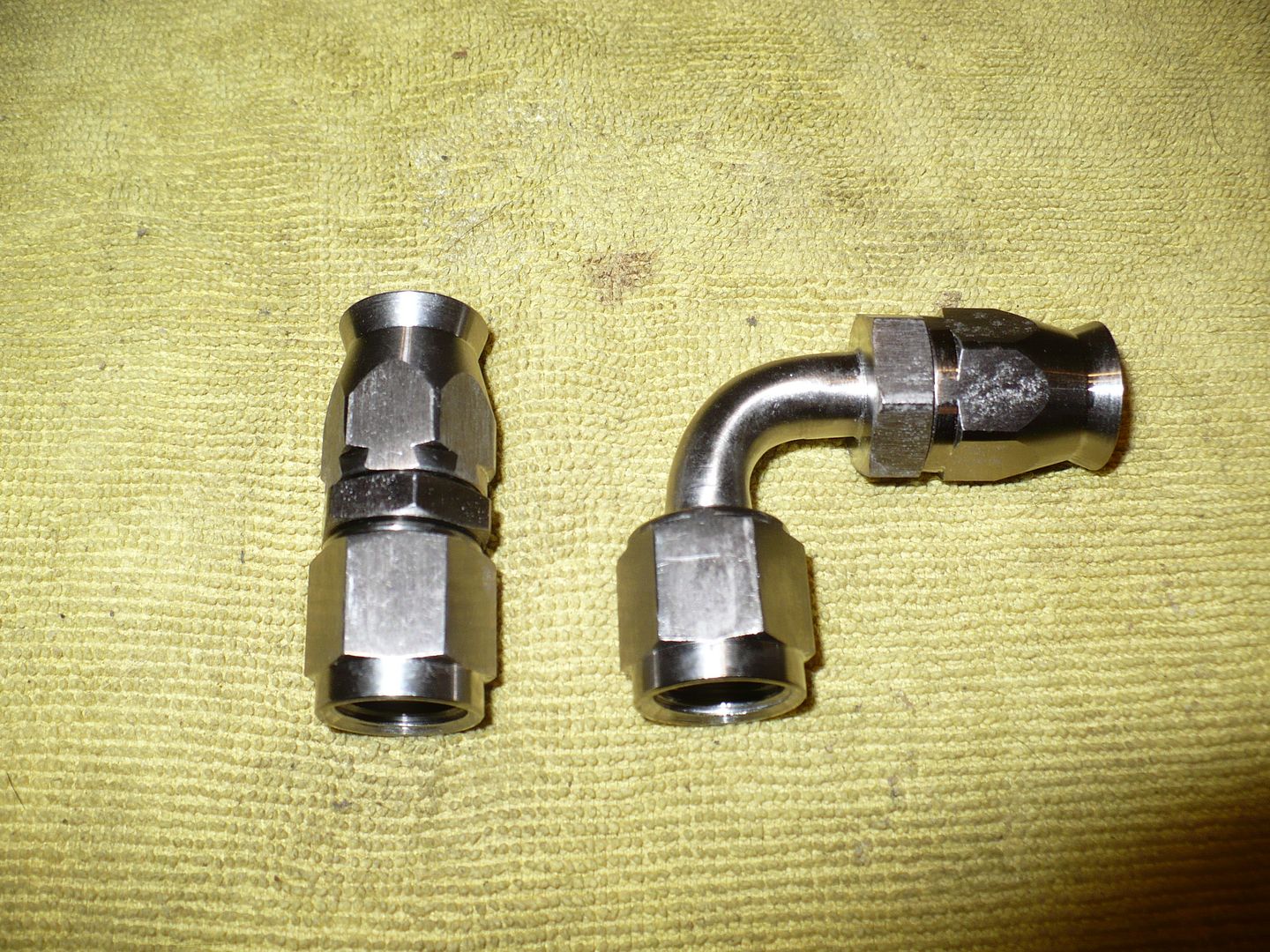

That elbow in the white pkg looks looks the one I used. ZJ?

Finally received the 2 high pressure fittings so I'm good to go!
