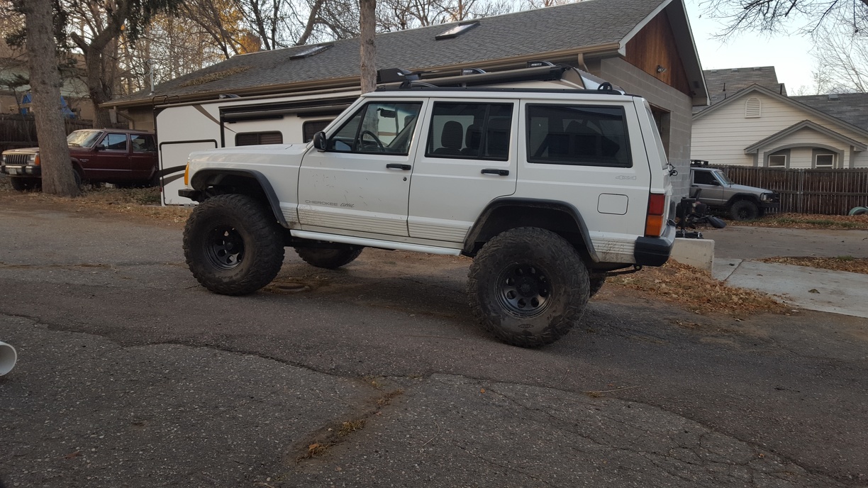

This is a RE 3.5" pack with a 1" BDS shackle, Currie 5.5" coils and 35" MTR's. The rear is just ever so slightly higher than the front. Stock rear bumper with full size spare in the cargo area. I believe the packs are about a year old.
