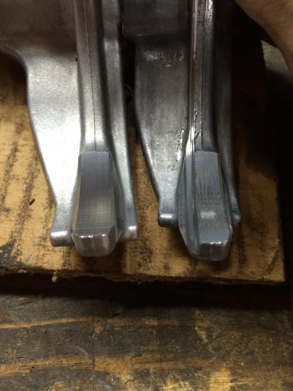

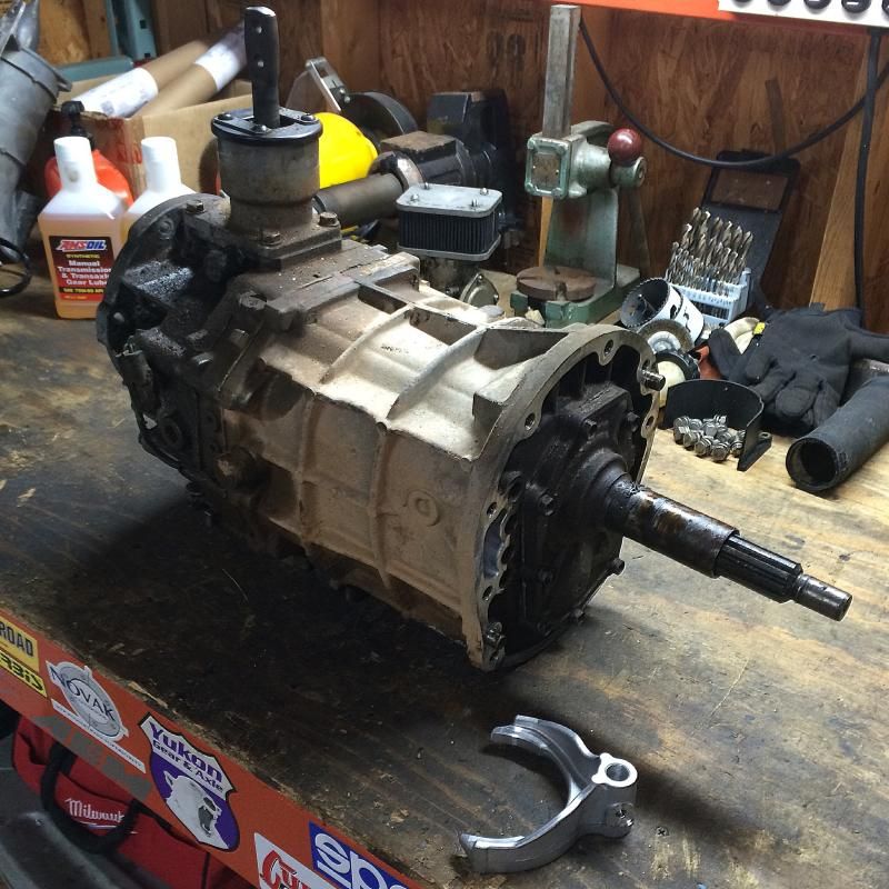

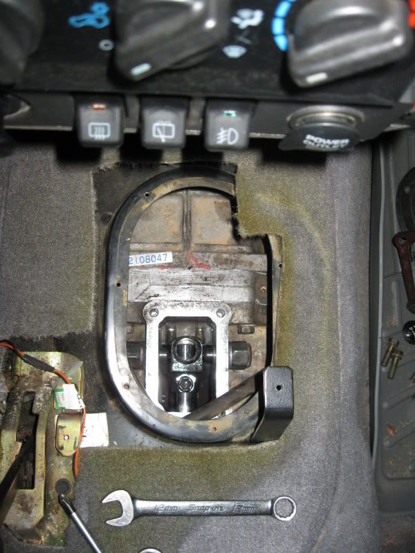

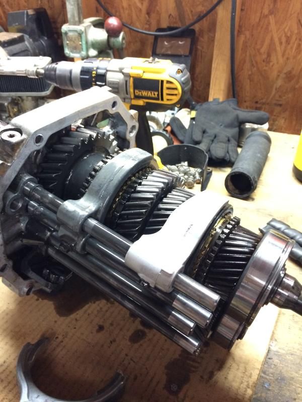

A lot of good information in here - allow me to add some pictures. I've had a lot of experience with my AX15 (factory installed from my 97 XJ) over the years.
Although its a really simple/strong little 5-box, I've had a couple reoccurring issues; I wonder if you've run across this before. Back when I originally got my XJ, it soon developed an issue shifting into 3rd. Come to find out, the 3rd gear side of the 3-4 fork wore down from what I could only discern was the fault of the previous owner running the trans dry. He did that after plugging the weep hole (I guess he got tired of the leak) and all of the fluid migrating to the transfer case. Either it be, I pulled the trans, rebuild it (new TransStar syncros and bearings) and threw it back together. All to figure out the problem was no different. In my hast I looked right over the heat discolored fork. Long story short, the trans came back down, swapped the fork and I was off shifting smooth. 8-9 months later, it came back. This time being prepared, and getting quite good at this, I pulled it down and again, swapped the fork and had it back together before finishing my 12-pack. 6 months later.......you guessed it, lost 3rd again. This time, I changed the 3-4 collar and fork. I'm a month down the road at this point - here's hoping.
Ever ran into this? My hope is that the mild imperfections in the collar were slowly wearing the fork down, so my hope is that I've got it all fixed now.
a good reason you can't catch 3rd....
my dirty AX15 (Hurst turret)
shifter location through the cabin
Bearings
Seals
Syncros

Looks good and I would assume that you are right about the damaged surface on the synchro sleeve/collar eating up the new forks, too.
To the guy with the shifter retention clip question - yes, as far as I know an AX5 clip will fit your AX15 fine. A friend is running one like that with no complaints. I haven't cross referenced it in the parts catalog but he has 25k miles on the YJ AX5 shift lever and retention clip in a Dakota/YJ/TJ AX15 shift turret on top of an XJ AX15, so I assume it is compatible. I drove it and it shifted just like they all do.
