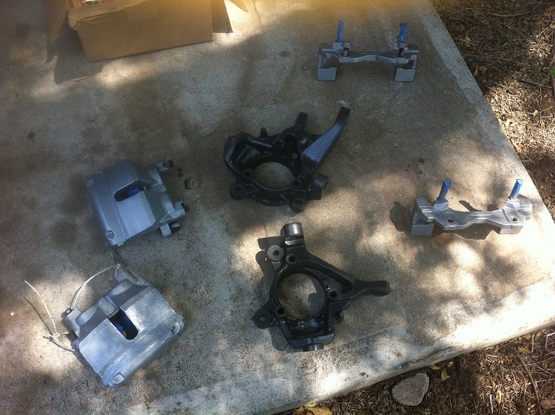

Pieces and parts:
U-pick it:
01' WJ knuckles, and Calipers, PS pump
98' Durango box
New parts:
01' XJ upper ball joints
01' WJ lower ball joints
01' XJ unit bearings (mines an 01' already but I figured I'd replace while in there)
JKS Flange spacer
02' Explorer Sportrac rotors ( important b/c 01' wont fit, I tried)
New brake pads

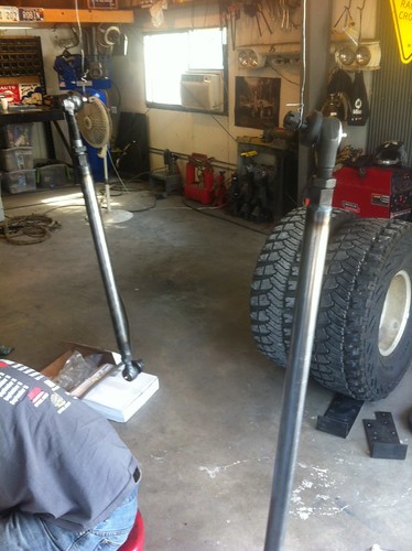

DOM and TRE from Rough Stuff
I beginning to doubt that I need this ridiculous size. This is what happens when friends send you emails of stuff you ought to buy...

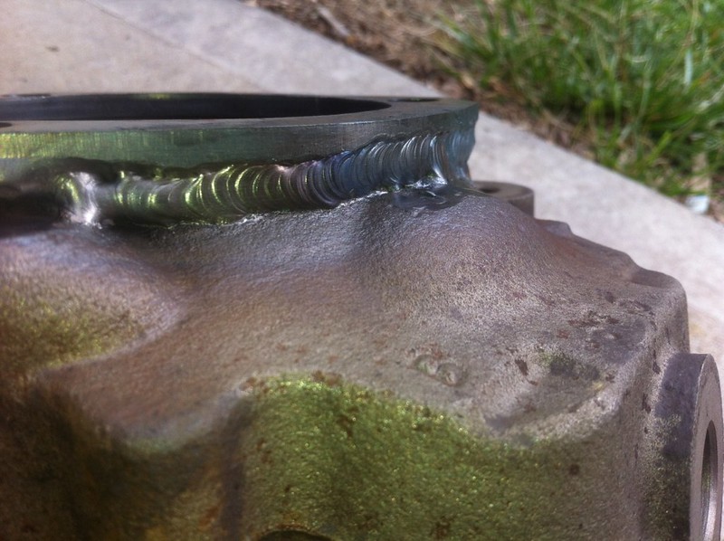

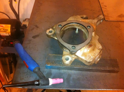

Weld on JKS flange spacer to the passenger side knuckle
Sandblasted the knuckle clean. Some have thought it not necessary to weld on the flange, I disagree as does JKS. Disclaimer: I am not a professional welder, I am a hobbyist, I consider my sources and use advice from others to form best practices.
That being said, Important to get the knuckle hot with a torch for it to weld properly, then do it in stages and stick it in a bucket of sand to cool, so the welds don't pop from cooling to fast.
TIG was a little hard to get in there. Had a 1/4" deep channel between flange and knuckle to get first few welds into.

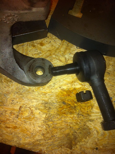

Weld on one side of the inserts to the DOM the others after the knuckles are installed and measurements are taken.
Ream the knuckles
Everything is working fine, the taper went smooth the TRE fits snugly Right? WRONG. This is supposed to be an OVER the knuckle steering so tapering the holes in the stock direction got me nowhere. I only did one backwards, but to late I might as well have done them all that way. So plan B, I just drilled them all out 7/8" and welded in tapered inserts. I had a buddy to the 7/8" drilling at his shop with a industrial drill press. the taper self centers so I could do that at home, but a straight bore has to be angled in more than one direction so a drill press that moves is preferred.

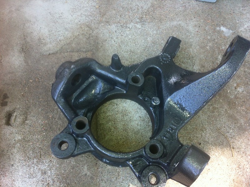

Paint em' up!
I like this stuff, time will tell how trail proof it is. But it goes on well with a brush and thats always a plus.

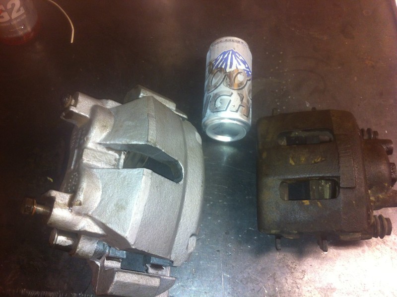

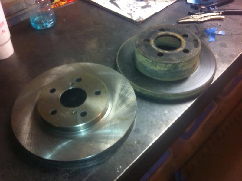

Old and new brake and rotor comparison. Along with a shop tool for size comparison.
This is the incorrect rotor, same size but out of an 01' instead of an 02' sportrac. The hub isn't deep enough.

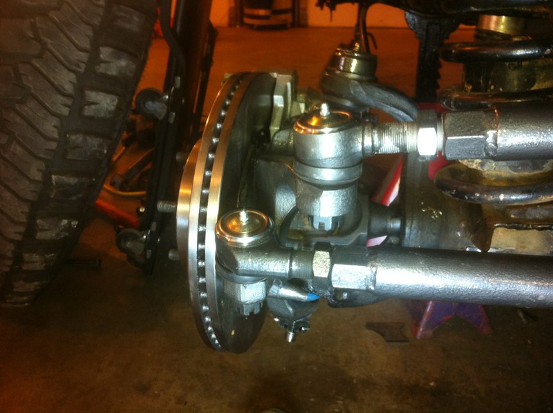

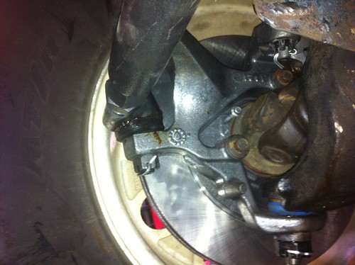

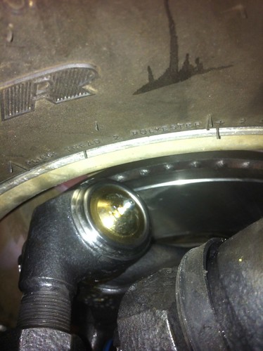

There are some clearance issues to be aware of....
Better make sure your wheels are large enough, stock wheels you can forget about.. I have 15" Mickey Thompson's with a good bit of offset, and they don't taper on the inside but it was close.
This picture is misleading. Its not touching anywhere and there is a fair amount of space at least an 1/4" all the way around the caliper. But still tight.
The offset TRE contacted the wheel on full lock turns. Granted you won't be doing full lock at any speed but still no good. I ground the edge of the TRE since there seemed to be a little extra cast there where it was rubbing and have maintained good clearance there since.
Some have mentioned spacing issues with the sportrac rotors and the calipers. My calipers rubbed the back side of my new rotors and gouged them pretty good. I had to add 1/16 inch thick washers behind my calipers to get the proper spacing. 1/8" spacing would be about perfect and I have a disc rotor spacer on order to correct that since washers are dangerous in that position.
I don't know if it was the O'rilleys house brand rotors or the NAPA unit bearings but the back of the rotor was .010 too small to slide over the hub flange. So, started it up, put it D, and lightly held a spinning flap disc to the the top of the flange and presto.

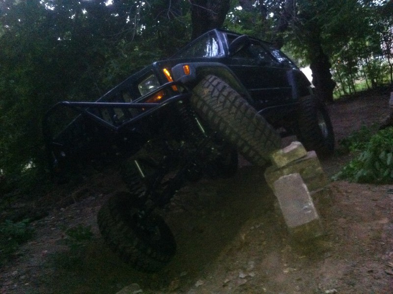

Take it out for a flex. Gained a lot of drop on the passenger side now that my stock draglink isn't hanging the axle up. Now its just the brake lines... tight as banjo strings. Looks like its time for longer ones again. Sorry, it was a little dark out.
