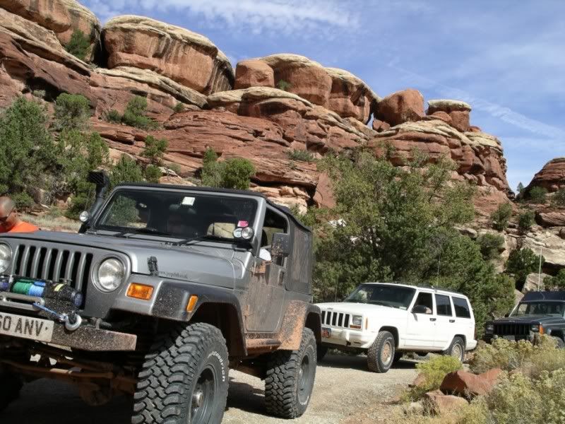

Just to be clear, the TJ was an export model for the United Kingdom. It still is RHD although I no longer own it. It originally arrived from the factory with a RHD low pinion D30. The UK never had a RHD TJ Rubicon model so I bought a brand new LHD TJ Rubicon axle in the USA and modified the axle to make it into a RHD axle.
I have a picture somewhere, may even still be here on NAXJA, I will search for it.
The only photo left on NAXJA is this one, but I know I have at least one good clear photo of the front axle in my archive.
