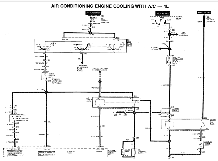

I have a 1989 Cherokee. The air conditioner clutch stopped turning on and the electric fan won't turn on either. The fan works with 12 v directly to it. IT has worked in the past as well. It just stopped working right after I installed a new higher amp alternator.
Relay readouts are as follows
AC OFF AC ON
30 - 7.3mV 30 - 9.5mV
85 - 14.1 V 85 - 14.0 V
86 - 60mv 86 - 60mV
87 - 39.9mV 87 - 39.3mV
87a - 105mV 87a - 0.1mV
This is all stock wiring and parts. I've no clue why 30 isn't getting 14 volts, and why 87a is the only one changing in volts. If there was a fuse blown on the wire to plug 30 I wouldn't expect to get ANY volts.
The relay itself works and I've tried it with other 5 pin relays that also work.
Could the clutch not be engagine because the compressor is low on oil? The orange wire going to the Air Conditioner isn't getting 12 volts of power either.n
Pin 30 isn't going to get 12v. It needs ground in order to work. Since the coil of the relay is the only thing in that circuit with a resistance value, it drops all the voltage. 87a is only changing by 0.1v, which is insignificant.

Looks like the ECU controls the ground going to pin 30. If it worked before an alternator swap, I'd just go back and retrace your steps to see if you left a ground loose (or accidentally knocked one loose) somewhere. I don't really have a good electrical diagram for an 89 so I'm going off the Haynes manual.

See if you're getting a ground signal from the ECU when the AC is commanded on. Of it's coming from the ECU but not getting to the relay you have a break in wiring somewhere.
The AC relay is wired kinda weird compared to what most are probably used to seeing. Pin #30 is NOT a source of power for the load (AC clutch). The source is #87 is, and that current comes from your AC control panel through the pressure switch. Did you accidentally knock the connector off where it plugs in at the drier when fiddling with the alternator?
To expand a bit on how this works, pin #30 goes to the AC clutch, the diagnostic connector, and the 'fan diode'. The weird thing is that when powered off, the AC relay takes the lead from the AC clutch and sinks it to ground via pin #87a. I ***think*** this is to drain flyback voltage released when the compressor clutch is turned off.

Obvious question, does the A/C still have a charge? No voltage on pin 87 tells me that you don't have voltage coming from the low pressure switch. Measuring across the low pressure switch should have zero resistance and voltage if there is pressure.

Also check your fuses. The ac circuit gets power from the blower fuse (25A)
