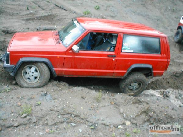

This is what I did when I wanted to keep the flares. Just left them in the stock position.
Look behind the tire and in front of it:
Look behind the tire:
